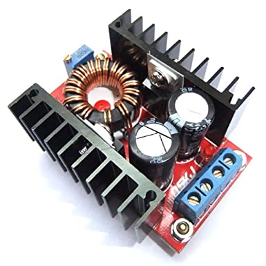

Thinking more about how to adapt a car 12V system or a dedicated DC Generator 12V output to directly charge my pack...
DROK 120W 12V/24V/48V 10-32V to 35-60V DC Converter Voltage Regulator Boost Charger Car Power Supply DIY
@ Amazon for only $12.80 USD.
Specs:
Input voltage :10-32V DC
Output voltage: 35-60V DC (adjustable)
Output Current: 5A (MAX)
Input Current: 16A (MAX) (Please enhance heat dissipation if more than 10A)
Output power: natural cooling 80W (MAX), enhance heat dissipation 120W (MAX)
For 10A out, you'd need a few of these in parallel.
The output voltage is not high enough for my particular pack, though it could get it pretty close. Perhaps a two-stage process would get me into good territory. Maybe not the best answer, though some consideration <slurp coffee>. :)
I did a little calculation on output wattage; for me at 63V 10A -> 630W.
Flip it around for a lossless conversion and it's 63/12 = 52.5A from the car or generator. Most cars can handle 60A.

I already posted similar on pg 1 with higher input and output voltage range. Boosting from 12V to 62V requires about 10A and delivers about 2A respectively.
Very simple though and quite handy device to have laying around for emergencies and/or those moments when a PS just doesn't put out high enough voltage and/or regulate current.
http://www.ebay.com/itm/1pcs-Boost-DC-DC-Converter-Power-Supply-Step-up-Module-10-60V-to-12-80V-600W-mah-/300896310668?ssPageName=ADME:L:OU:US:3160
