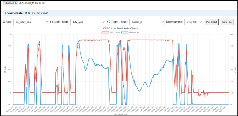

This program uses the log data collected by Vesc Tool logging feature to chart stats natively on your phone.
I wanted a simple way of creating and viewing chart on phone that is running Vesc Tool.
Sure Windows Vesc Tool can do this better, and I hear there is an app as well.
This fits program fits the bill nicely for ease of use and basic charting and simplicity.
Here are several plots (there are hundreds of different combinations that can be created) I created in seconds:
Logs can get large in size, so the program allows you to choose to plot every 5th or 10th log entry, or plot average of every 5 or 10 log entries.
******Sequential time plot: battery-current -vs- Controller tempurature
******Sequential time plot: battery-current -vs- Battery Ah used.
******Sequential time plot: Duty-Cycle -vs- Battery-Current
Here is the program.....it's just an HTML program.....
There is no app to load&run (avoid risk trojan or other malicious code in app).
This works on phone (tested with Samsung Android....did not test with Apple) and also works on desktop (you have to move log over to your PC though). Copy below code into notepad ands save it as an html type file. Email file over to your Vesc Tool phone.

Some tips for using it:
*)On Android Chrome, it’s best to use “Add to Home screen” (point it to file name of saved ".html" program.
When you open Chrome, the program will automatically open.
*)Also, when you run it the first time, it will need to load up Chart.js JavaScript library. After initial run the library is cached to it will work even when there is no network cell service.
Instructions to get your charts.....
Enable logging on VESC Tool to capture data. File created is a ".csv" file.
To chart data:
Open chrome, then open the .html file (or it will pop up automatically if you setup your home screen on chrome)
Select "Choose File" --> Select file location/name of save .csv log file.
Select X, Y1, Y2 VSOC Tool logged field names.
Optional: Select Downsample
Select "Plot Chart"
Done....chart displays.
