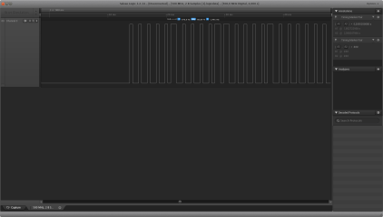

I'm using a ESP32C6 to capture the data sent by my em150 Votol controller but i'm having some issues:
- its not super stable and since the CRC is very basic i sometime have bad data with a correct CRC
- the data specified in the vendor documentation does not seem to be correct (drawings certainly are not).
I took some capture with a logic analyzer and the bit value is 0 for a duty cycle lower than 50% and 1 for a duty cycle greater than 50%. The start symbol has a duty cycle lower than 1%. I have modified the code to be the following which works for me.

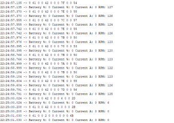

I'm still trying to figure out which bit indicates reverse since the documentation does not seem to be correct.
sport = bitRead(p.data[4], 7);
cruise = bitRead(p.data[3], 2);
reverse = bitRead(p.data[5], 2);
This works well on my fardrivers. I don't use reverse on my votol (as it's an ebike). I use a circular queue and push a copy of the data there and do all processing outside the ISR, in the loop. Computing in ISRs should be avoided.

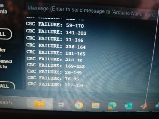

WhatsApp Image 2024-10-24 at 6.34.41 PM.jpegWhatsApp Image 2024-10-24 at 6.33.57 PM.jpeg
See these battery , current etc readings they don't change.
And if I press or turn the throttle
Crc error shows up
And no reading is recorded until I release the throttle.
But when I don't give any throttle and just press the brake.
Brake is printed with the 12 bit of data..I look forward to your feedback. Thanks

you are getting EMI that corrupts the signal. having a proper ground (from the controller preferably) and good connectors can combat that. also when determining if the bit is 1 or 0, just checking if one interval is greater than the other helps

Hello! I connected my Votol EM-50-4 to Arduino nano to pin D3 (I only changed the pin to D3 in the sketch you provided). Everything works fine except: Battery %, Current %, Current A. Please help me figure it out. This is what aruino returns to the serial
if your signal from arduino to the display gets corrupted then you can try using shielded wires for the rounded display. If you feel the issue is dropped packages from the controller you might look into shielding the single wire from the controller, and specially use good connectors. On my motorcycle I soldered the input wire to the pin on my esp32.
But first of all make sure the arduino ground comes from the controller directly
I think I fixed the battery percentage, but there are problems with the current measurement. Can you help me please?
