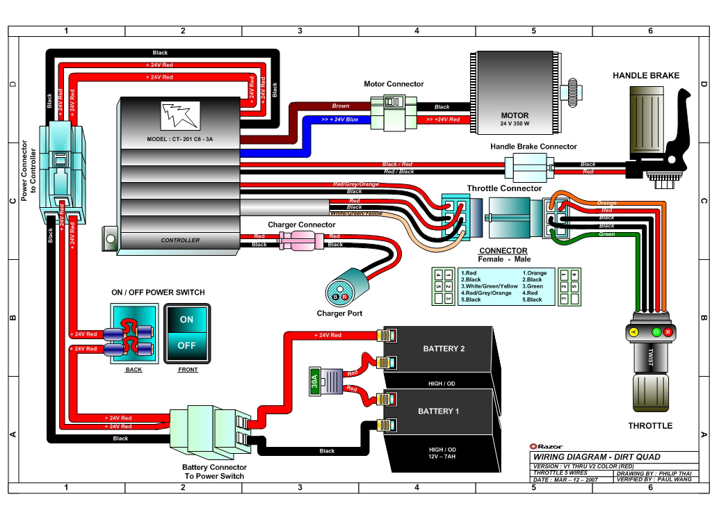

Back up a few steps. What are you trying to do? Do you want to service an existing electric quad, or do you want to convert a stinker to electric? In either case, which quad? And how much are you willing to spend getting the job done?
I'm trying to repair an existing electric quad...
But building a 15 inch rail truck.
The previous owner said that they couldn't find a vin number nor know who manufacturer it.
They said they installed new batteries and they couldn't get it to move.
A piece has been removed and I don't know what it is nor unknown what is required to make an electric vehicle to move.

Well there's not much help we can give until we know basics like does it have a brushed or brushless motor, is the speed controller present and if so, what are its voltage limits, and what kind of battery does it have?
Battery feeds power to a speed controller, which uses a throttle or other signal source to tell it how much juice to feed the motor. If you're missing any one of those four items (battery, motor, controller, speed signal), then you don't have enough to make it work. If it has all these things but won't run, and you know the battery is good, then it's most likely a problem with a cable or plug.
A brushed, two-wire motor can be used without a speed controller, only turning it on and off with a switch or a relay, but that doesn't work well unless the motor is very low powered. It's probably not what your buddy has.
The speed controller is a smallish box, usually aluminum with cooling fins, that has various wires coming out of it. Often it will have a label that says what its voltage and current ratings are.

At a basic level, you need at least a motor, motor controller, battery, and a throttle. These components can be designed to work with different battery voltage and motor phase current, so you can't just buy any motor controller and expect it to work with your battery and motor.
That's a can of worms. Not an impossible project, but impossible from where you stand now. The question for you is, how much do you want to step up your game before you can even start making headway on this thing?

The "what is it" picture looks like an AN fuse with a contactor behind it.
It looks like the pins to turn on the contactor is not connected, without that you probably wont get power from the batteries to anything. There also looks to be a lot of unconnected wiring and busbars around it to figure out where they are supposed to go.
Try to find out what controller you have, find a wiring diagram for that and start figuring out what you have and dont have.
When you have voltage where it is supposed to be you can see if something happens.
When you have that figured out you can start figuring out the charger and other systems.
