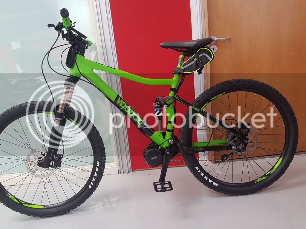

Both Em3ev and Luna do Dolphin batteries (09 case) that can easily supply 1500 watts. A Luna Mighty Mini at only 3 pounds can power a 1500W BBSHD. Its in that saddle bag. 18650 cell-packs are much better than lipos. They're smaller and lighter:

The guy has a BBSHD. The Luna Mighty Mini with 14S2P 18650s can handle that motor and it's controller. A Dolphin packwith 13S4P would have double the capability. The cells can provide 60 amps, though, IIRC, the Dolphin pack has a 40 amp BMS.
SAMSUNG 30Q or GA 18650 cells cost double what lipos do for the same volts and Ah, but they last twice as long, so the cost is the same in the long term; however, they have half the weight, which gives them a massive advantage. Lipos are now old school. Time to move forward and embrace the new technology.
