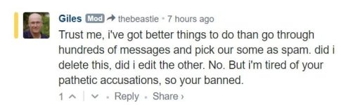

Yeah I got banned from reneweconomy.com.au
http://reneweconomy.com.au/james-hansens-generation-iv-nuclear-fallacies-and-fantasies-70309/#comment-3498427794
I had actually pretty much given up posting on Reneweconomy because my posts constantly disappeared, but they didn't disappear right away, normally after about 12 hours or so.. If there was one thing they really seemed to hate it was real world average power generation data from the EIA.gov etc.
I did have a system where I would copy/paste my post into my private "Google Keep" and then wait for my post on reneweconomy to disappear and after about 4 days knowing that the discussion had largely moved on just post it again and it would normally stay.
I decided to post on the recent article about Nuclear on Reneweconomy because there was a massive amount of comments so I thought I would join in.
When my post disappeared again after about 12 hours I decided to repost the next day and decided to include a claim that my posts get deleted. http://reneweconomy.com.au/james-hansens-generation-iv-nuclear-fallacies-and-fantasies-70309/#comment-3497011595
The moderator jumped in and said I deleted my own post so I decided to look in my Google Chrome history and clicked on the exact point of where it should have been and it comes up and said its "marked as spam", but its baloney because why would a anti-spam system take 12-24 hours to decide my message was spam because I was constantly checking my posts hours after initially posting them and they always stayed it wouldn't be until the next day they would be gone, there is no anti-spam system in the world that could be that slow or stupid.
https://uploads.disquscdn.com/images/a6202cb1e7885679444d527d5238446ccde1cd54b0c578aed3c309f2ee7ac7a9.jpg
After I said this to the moderator I got banned.
Considering you claimed you have looked and said "I" deleted it maybe I should be wondering if it's you that's marking them as spam and making them invisible? This has happened on this particular website so many times now and it never happens other websites that use Disqus.
He responded with this pretty short and weird/tempered "your banned" reply, considering this is the only time I have ever brought up the issue of my posts on Reneweconomy disappearing one way or the other. "But i'm tired of your pathetic accusations, so your banned."
