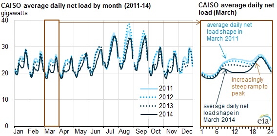

well not quite, .. because that 46GW iis more than the capacity of the gas plants.(43GW).. Infact to supply that demand at night you would need all the gas, nuclear, and hydro etc available in CA, and most likely still import from other states. :eek:
CA imports 30% of its annual electricity , even before we plug in any more EVs !
.and that off peak 30GW is only a minimum for a few hours between midnite and 5 am, so you couldnt just charge for 10 hrs without blowing out that peak figure more.
Right. It is the maximum capacity of the grid without any upgrades. In other words, it is what it could handle today WITHOUT smarter grids, more transmission lines, more solar generation etc.
That's right. And if things go well, it will import (and export) even more. A better grid means a sunny day in Nevada or Arizona powers LA when it's cloudy in LA - and vice versa.
Also right. Most people don't need that much energy; not everyone drives exactly 25 miles a day (we sure don't.) And of course 75% of Californians don't drive EV's.
billvon said:
......]Right. It is the maximum capacity of the grid without any upgrades. In other words, it is what it could handle today WITHOUT smarter grids, more transmission lines, more solar generation etc.......
No bill, you miss the point, CA desnt have enough " base load" capacity to supply 46 GW during night time hours.
billvon said:
...That's right. And if things go well, it will import (and export) even more. A better grid means a sunny day in Nevada or Arizona powers LA when it's cloudy in LA - and vice versa....
Again you are avoiding the issue...
CA..is a NET importer of power. It cannot generate enough electricity to satisfy current demand.
Of course they could simply rely on other states for increased supply, but that is not sustainable.
And..the peak demand is 6pm - 10pm, so solar is not the answer....without a lot more storage.
.and that "off peak" 30GW is only a minimum for a few hours between midnite and 5 am, so you couldnt just charge for 10 hrs without blowing out that peak figure more.
I didn't claim it did. I said it had the TOTAL CAPACITY to support that. How do I know? Because it does; the system can in fact support 46GW of load.
It also exports power when it generates too much. Most states do this.
Why not? If Nevada wants to become a solar generation/storage state, more power (literally) to them.
Yep. And part of that storage is going to come in the form of EV's.
You can list reasons this won't work all you like. People will simply continue to do it, as they have been for the last five years.
Bill... Please read more carefully and understand the meaning and implications of words like "NET" .and "NIGHT".
For CA to 46 GW at night, it has to import more interstate power (thermally generated ?), which means more CO2 produced somewhere ?
Shure CA exports some , but it imports much more than it exports ... 30% of all consumption infact !
??? Right. But I think it's you who are not reading.
As I have said several times - RIGHT NOW, with the grid we have (i.e. no more solar/renewables/storage etc added) we could support 75% of Californians driving EV's. That's RIGHT NOW. (Remember that phrase; we will come back to it.)
In the future, as solar continues to grow, that energy mix will include more and more solar. And as that solar percentage grows, more people will be charging during the day - because power will be cheaper during the day due to the solar (non-baseline) contribution.
Notice that that's different than what is happening RIGHT NOW. RIGHT NOW only 2.7% of the cars in California that are EV or PHEV. That won't become 75% (or even 50%) within a year or two - it will take decades. At which point a much larger mix of California's energy will be solar/renewables.
So RIGHT NOW the grid could support all those EV's. RIGHT NOW it doesn't have to.
IN THE FUTURE the grid will still be able to support all those EV's. IN THE FUTURE more of the generation will be renewable.
Let me know if you get it yet, or if I need to simplify further.
When you say "right now WE can support..." You must be refering to the USA/ West coast generally,......
...because RIGHT NOW, California cannot support itself with electricity generation, it imports 30% of all electricity used.
And that is NET ! After all import - export exchanges.
Smart control of EV charge rates such as what Tesla can do remotely to it's cars (if they are plugged in at the correct time)(and if there are enough plugs at other places than just at home) could level the troughs and or take more advantage of a big solar peak.

sendler2112 said:
Smart control of EV charge rates such as what Tesla can do remotely to it's cars (if they are plugged in at the correct time)(and if there are enough plugs at other places than just at home) could level the troughs and or take more advantage of a big solar peak....
Sure, its commonly called "Demand Management" ..a term contrived to replace the the phrase " Oh shit, we dont have enough capacity". ! :lol:
No matter how much you shuffle the peaks and troughs, if you dont have enough GWh generation capacity, you have a problem !... And EVs are only going to increase the demand.
Last year , CA was short aprox 90 TWh of capacity....or about 90 Topaz solar plants worth of capacity.
Lucky they have friendly neighbours with power to spare currently.
Replacing gasoline in California requires an additional 126,123 GWh/y electric. Reduce that by 25% to apply to your statement if you like but it is still a big increase beyond even what leveling the night time troughs with thermal generation would cover. If you try to do this with solar PV the cars will have to charge during the solar peak and you will need 75 more Solar Star farms and an increase in the wires to carry 43% more peak electricity since the solar peak nearly coincides with the current big daytime peaks.
Not being facetious. Just pragmatic. We need to run numbers so that we can get back to making smart decisions with our head. Not our heart.
