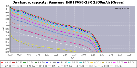

DubP said:
Thanks so much for the detailed response! I think the biggest difference in pack voltages when I connected the BMS was about 0.4V (4.1-3.7), and my pack capacity is about 24Ah. Assuming those Ah work linearly across a 1V span (like 4.2 to 3.2), I think that it means it was imbalanced by 40% of the capacity, so 9.6Ah. does that make sense? Probably it was out more because I think the discharge is not linear and most of the capacity is at the higher end of the voltage span.
It's not really linear; and the actual curve depends on both the specific cell model and the load on the cell vs it's capabilities. Example:
https://lygte-info.dk/review/batteries2012/Samsung%20INR18650-25R%202500mAh%20%28Green%29%20UK.html
I guess I'll have to cycle this battery a few times to see how out of balance it gets during use. It seems like a BMS really needs to keep up with balancing overnight if it's for a battery that gets cycles daily. I'm starting to see why a single weak cell or two could bring down a whole battery.
Improperly connected groups do it too--a broken connection to one or few cells in a group means that group doesn't ahve hte same resistance or load-bearing ability or capacity as the others. It's a pretty common problem, as is poorly-matched cells, so that different groups have different properties even when all the cells are well-connected.
