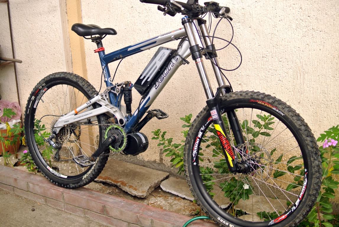

So I snagged a NOS new old-stock BeOne Nirvana f/s frame in the correct size (for me, 19"), and has ample triangle space, so I figured why not turn it into another ebike
BBS02 2016 production w/ upgraded FETs:

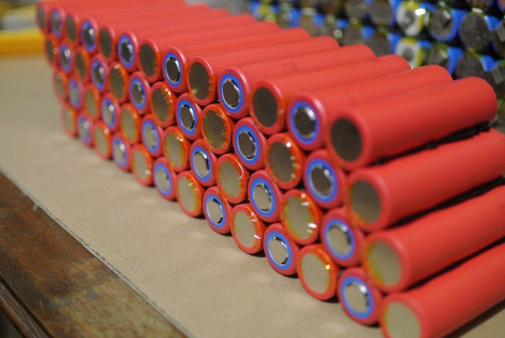

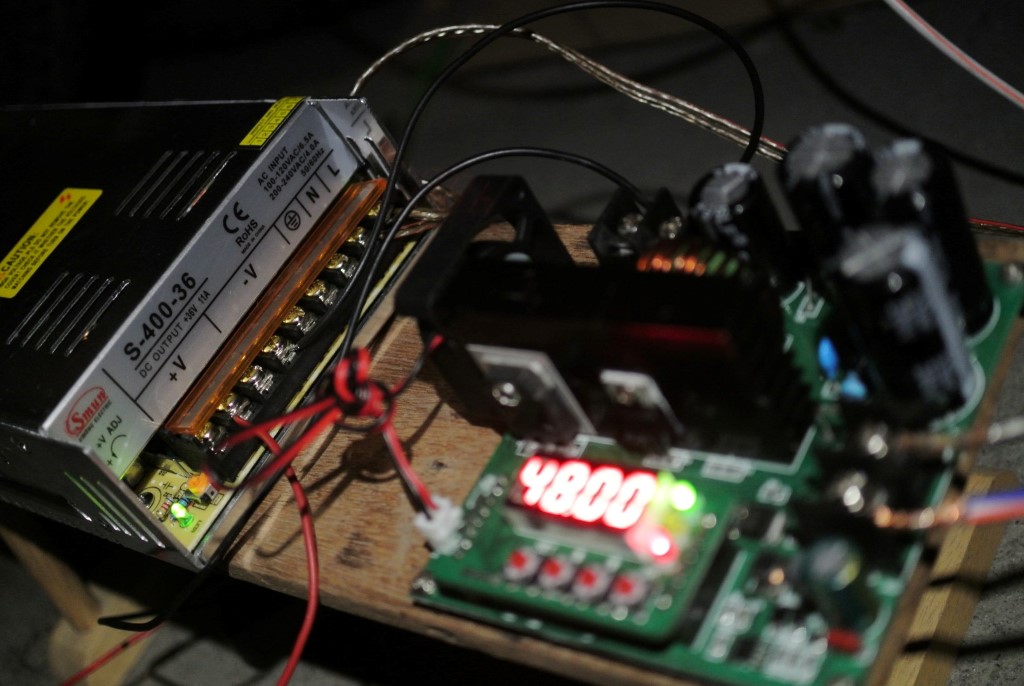

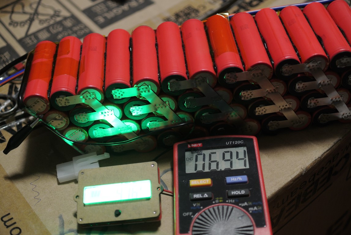

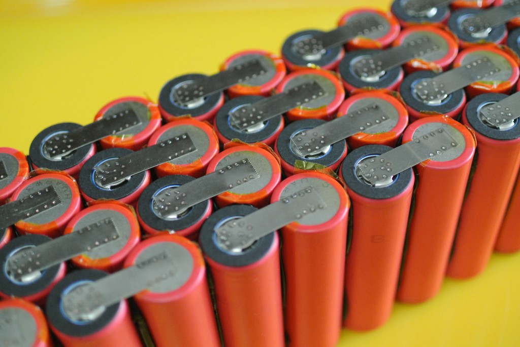

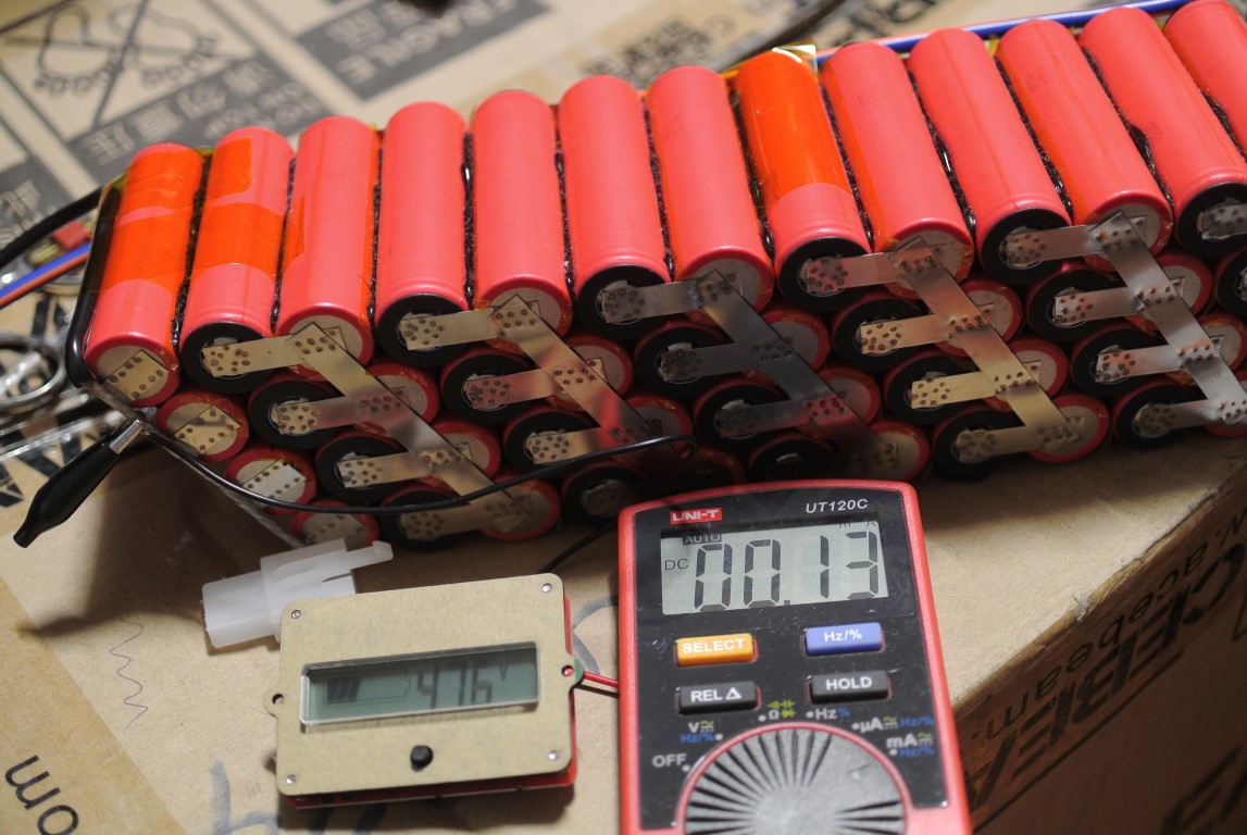

Battery is Sanyo NCR18650GA 3500mah. 13s4p. No BMS, will simply have external balance port for occasional balancing. BBS02 set to 38V LVC which is just about right for 13s when using these NCA cells w/ 2.5V end voltage. To be charged using a DC-DC boost module:
Details of boost module charger here: https://endless-sphere.com/forums/viewtopic.php?f=14&t=82731
