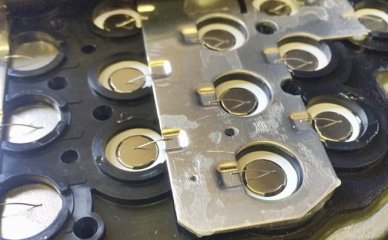

If you look at a Tesla EV battery pack the connections between each 18650 cell are tiny. The reason Tesla can give a good warranty on the battery pack is because they aren't beating the hell out of the cells with heavy amp draw. Wanting overly thick connections on the cells can be viewed as bad engineering.
https://chargedevs.com/features/a-closer-look-at-wire-bonding/

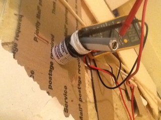

I been eyeing this stuff which claims "resistivity <0.01 ohm-cm", googling "Silver Conductive Grease" seems to show off the most impressive numbers on such materials as far as I have seen.
https://www.chemtronics.com/descriptions/document/Cw7100tds.pdf
https://www.chemtronics.com/p-715-circuitworks-silver-conductive-grease.aspx

I´ve been reading the forum for some time to find a setup that is suitable for used/disassembled laptop batteries, i have a bunch of them, thus needing a serviceable pack. Love this thread, big up for all you guys contributing!
Been reading the entire thread and thought it would be nice with a summary based on what i´ve picked up. Please fill me in and correct me if i´m wrong!
1. Battery holders: To get rigidity it is an advantage if the holders can take several or the entire amount of cells in the pack. Gluing holders will make it more rigid. Some people have tried hot glue instead of holders but ending up with holders in the end. A rigid pack will flex less and disturb the connections less. Personally i got interested in this setup: http://s.aliexpress.com/6vMVbQ3y
Less space and the cell ends are free for any set up of NIB´s and strips/sheets/foil. Note to self is that it might create higher risk of shortage due to the lack of any protection from the holders. Would be interested in what you think!
2. NIB size. Some where around 12mm dia, 2mm thickness of magnets (N52?) seem to do the job in most cases
3. Material and material thickness: Thinner material thickness more towards a foil thickness of 0.05mm seem to be flexible and soft enough to maintain good contact without adding resistance during use (vibrations etc). Preparations is light sanding of cell terminals and cleaning with some kind of solvent. Vaseline can be used to protect oxidation and maintain a low resistance connection. Other products has only been discussed but not tested if i remember correct. Copper foil is what have been used with success compared with nickel strips that are harder and have caused issues on the field. Although i think it was in an MTB environment the issue occurred. Please fill me in here! Not seen anyone tried "foil thin" nickel (maybe not available?) yet.
4. Really of importance to make sure the magnets will not be able to jump and short the pack. A protection/damage control strategy during build, under use and at rebuild should not be neglected. However no catastrophic failures reported.
Did this give us a rough summary of the engineering being made and shared in this tread?

I got some of the 'CHEMTRONICS CW7100 Silver Conductive Grease' and did a bit of testing with the DMM. I found an online seller in Melbourne who was selling it at a somewhat reasonable price.
While it wasn't lab level testing and done with a Chinese digital multimeter I am pleased with the results.
I placed a very small dab of it and let it be exposed to air over 24 hours and then tested, it still has a grease like nature to it after sitting exposed to air after 1 day.
I did test it straight after squeezing out a portion and the multimeter was all over the place when I stuck the probes into it..
From the small somewhat uneven dab I was able to get around 3.3ohms with the probes a few mm apart pushed down on the cardboard packaging.
I took some pics attached with my iPad in my other hand of the DMM and the probes touching the electrically conductive grease.
*Add/Edit* I tested another 24 hours later (so a few days in total) and was able to get around 1.9ohms so the dryer it gets the better it conducts.. Also note that holding my probes directly together shows 0.5ohms on my meter..
So logically if its around 1mm of gap or less of space between the copper covered magnet and the cell terminal then its definitely doing its job of keeping out air and filling the gap.. as having 1ohm or less resistance is most certainly better than infinite resistance of air. This stuff can only help as long as its in the right amount.. too much and your blocking metal on metal contact, too little and your allowing air to oxidize/ruin your existing metal contact and leaving space where the CW7100 could be allowing a bit more current to flow through.
Add/Edit again..
So about a week later depending on where and how hard I press down on the probes I get between 0.8 and 1.4 ohms on the meter.. Also note again that holding the probes directly together gets 0.5ohms
