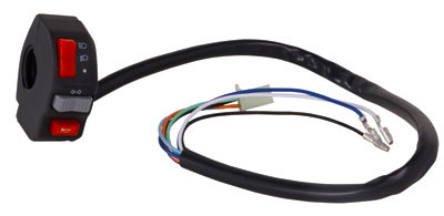

Motorcycle Handlebar Controls for headlights, Indicators, & Horn
The Low/High Beam and Indicator switches are integrated into a new handlebar controller for motorcycles. At preset the high beam and horn will not be used. To make room, the present 3-way Speed control and Cruise Control module will go from the left to the right side (even though I prefer having Cruise on the left). This will make for a crowded handlebar. To regain needed real estate the gear shifters are being swapped out from Shimano to SRAM Attack.

  • Motorcycle Handlebar Control Light Blinker Horn Switch; From eBay for $30
    These used to be a lot easier to find.
