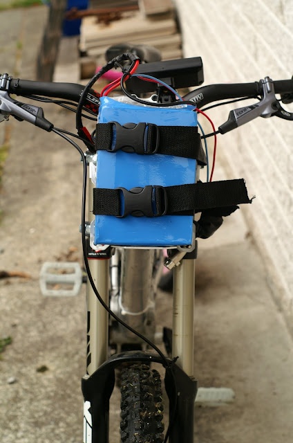

The adapters are stainless steel, 10mm thick on the disk side, 12mm thick on the drive side.
The battery is mounted on what I call the "Fork Lift" rack on the front forks. This also houses the controller. The battery straps on, either in a bag or by its self. The 5kg of LiFeP04 is enough weight to have up front. Not so much the weight, the bike is nicely balanced with the motor in the back, but the inertia it causes on the steering is not so cool. Fine for commuting and trail riding, but not for mx or DH style riding. I was thinking I would go out and do some jumps for the camera, but after a bit of a ride this after noon, not so keen. Would rather have the weight on my back for that sort of shenanigans.

The "fork lift" idea is very clever. Did you machine it yourself? With a CNC? Lifepo is pretty heavy. Lipo would sure make it lighter. Nice build!!!

The Fork Lift I designed to fit a range of fork sizes and widths and so you can lower it down to keep it as low as possible.

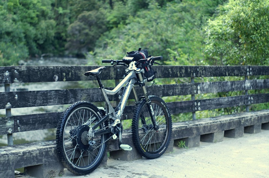

Postby Kiwi » Sat Nov 19, 2011 2:58 am
Well, this was not my bike, but one I built for a client. Sadly for me I had to hand it over today. Happy day for the client.
But I got a ride on it through our local forest before hand. Unfortunately my camera battery died 3 photos into the forest.
I soon got over the weight on the bars, sometimes when wheeling across streams or puddles I realised the extra weight, but you soon compensate. The dropout adapters were great, the forklift needs some work as it bent from the shock loading from hitting bumps and jumps. Needs to be quite a bit stronger, back to the drawing board on that one.
Such a nice bike to ride, was a stunning clear morning. I will do it again on my DH comp when its built up and get some more photos.
I swapped the knobblies of for some hookworms for the client. The bike is awesome on the road, a real motor bike feel, 43km/h flat out 48v LifePo4 NC 2808 motor which matches the pedal gearing well.
One issue I realsed today about the dropout adapter is that the chain will touch the chain stay if you are useing a 9 speed cluster with 11 tooth small ring. Ways around this are to change to a 7speed chain ring, which brings the chain in a bit, use a large front chain ring that lifts the chain a bit, or put a skid on the chain stay so the chain does not rub the frame. It wont take much to make it clear the stay, a couple of mm and its all good.
48v10ah ping on the fork lift
Heading into the Akatarawa Forrest
Slicks on ready for daily commuting role.
