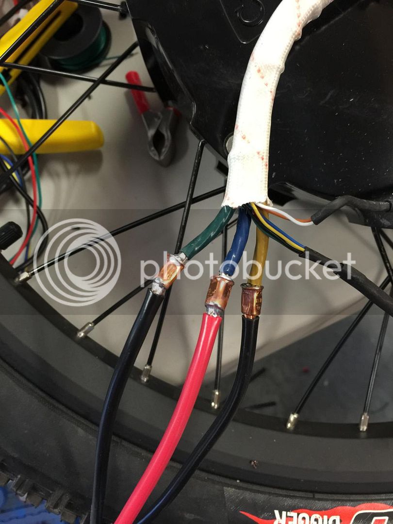

Hey guys, I'm back for more advice...
I got the Max-E working with the BMS on Thursday. So I was having lots of fun over the weekend.
Sunday I had a little too much fun, and was blasting up a hill by my house.
I noticed I hit about 10kW and the bike stuttered and stopped. Controller and motor temps were low, but my donor phase extensions had melted. These were undersized leads that were cut from a Crystalite 3540.
As you can see the coating melted shorting out the phase wires.
Coincidentally, my 8 gage welding cable showed up that same day. So I replaced the phase leads.
Unfortunately, now I can't get the controller to do anything, as it complains about "Halls Error 2"
Weird thing is that I get this error even if I switch to Sensorless mode.
Any thoughts?

About the !HALLS !, there is a resistor that you have to replace in the controller pcb that is on the opposite end of the wires input. I also had this problem and replaced the protectin SMT resistor R113 and everything worked again!
Take a look here: http://electrotransport.ru/ussr/index.php?topic=23722.0 use google translate :wink:
Here is my thread about the Adaptto and NYX bike. I am describing the problem and solution at the end of the page: http://endless-sphere.com/forums/viewtopic.php?f=3&t=65764
Btw, Jeka is the engineer of the Adaptto.
Doc
go into the debug monitor and try to spin the wheel.
Check if the Hal stats are chainging - you also see an Text which should change from H6,H5 H4 H3 H2 H1
if you get this - the Hall sensors are okay
I also found out, that you get an hall failure, if one phase is not connected.
Check if the sensor are okay ore not - otherwise you have to open the motor to take a look inside...

Thanks for the heads up, this checks ok..
Must be the resistor, or another issue in the motor.

So, I found out the motor Halls and Phase leads are ok. There is definitely something wrong with the controller though.
I switched to my mini-E and everything is working again.
Well auto detect is no good with this motor.
The way you soldered the phase wire with the little copper can is the best way to do :wink:
Doc

Newest firmware fixed the auto detect issue. The bike is running pretty good now. Wish it was the Max-E, but the mini will have to do for now.

If the led does not shine - it could also that this led is bad - or wrong mounted.
It would be interested to test if this cell string are balanced or not - i do not know if this is visible at the adaptto display.
But it will check this, because this could be also a bad bms...
madin88 said:
have you checked voltage across the LED?
Madin88, this is such an obvious thing to do, but I did not check. Thanks for the suggestion.
I am really not sure if I need to be changing the R113 as Voltage supply for the Halls is good. 4.64V on pin 6,5. I see on Crea2k3's photo below that he had a much lower voltage. If the R113 is blown, wouldn't voltage be lower?
