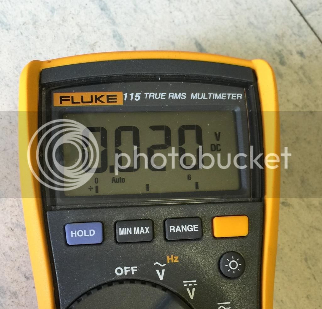

I received the following email from support:
Dear Rich,
You need to measure voltage between power ground and halls ground while hall sensor is connected.
If voltage is more then 1V, means there was a short circuit of hall wires to somewhere else (phase wires). Check isolation of halls wires. Remove back cover of the controller (without wires) and replace R113 (R113 is near the fixing screw). The value of the resistor is any within range 2-8 ohms.
In your case (melting phase wires) there is a high chance of damaging the whole wires (covered with the protective coating on your photo from ES) so you need to check all the wires since you can kill the controller in case of problems there.
All the best!
So I checked voltage at:
Halls Ground -> battery ground
Halls Ground -> Halls 5V
Hall Lead 1 -> hall ground (both states)
Adaptto E-Drives Lab said:
