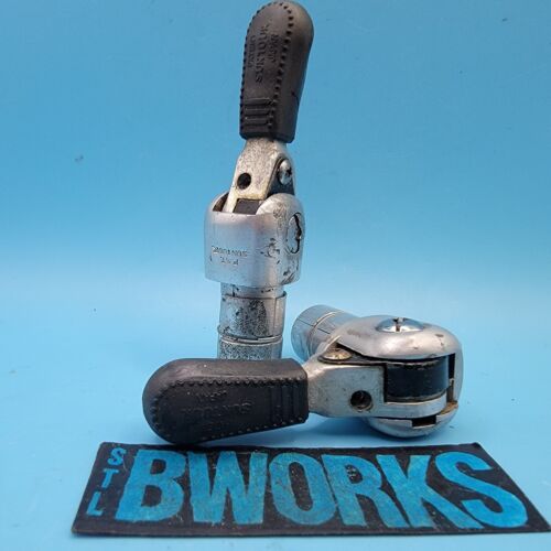

I have a Greenspeed trike, and it uses bar-end shifters. I want to change the derailleur and Shimano's CUES system is intended for longevity. Shimano only provides trigger shifters.
Does anyone have a recommendation for a bar-end shifter that will work with CUES? My trike currently has 10spd Micro-shift, but I'm open to changing all over to 11spd CUES.

I'm not savvy Shimano's CUES sys. I am, however, somewhat knowledgeable with the highly regarded Suntour barcons. These are friction barcons, NOT indexed... meaning however, they will pair-up with nearly any derailleur, providing there's sufficient cable travel. The Suntours are extremely well made - akin to a Swiss Watch - and smooth as glass. I even use one for my SRAM i-3 IGH.

It's pretty normal for older friction shifters to lack enough physical range to shift 11, or even 8/9/10 speed cassettes. There may not be any kind of friction shifter that has enough range for CUES.

CUES is only cross compatible with other CUES family components (they say). That implies a different, probably longer, cable pull increment.

The CUES shifters and derailleurs use the Linkglide cable pull ratio.
Somebody on Reddit measured the Linkglide cable pull ratio:
One index click of the Linkglide shifter moves 3.5mm of cable, which moves the derailleur 3.7mm to shift to the next cog. This gives a cable pull ratio of 3.7mm / 3.5mm = 1.05. This is NOT the same cable pull ratio as mechanical 11-speed Dura-Ace, Ultegra and 105-- Mechanical 11sp DA, Ultegra and 105 use a 1.4 cable pull ratio. 1mm of cable pull moves the derailleur 1.4mm. So no, CUES shifters and derailleurs will not be compatible with Mechanical 11sp DA, Ultegra or 105 shifters or derailleurs.
