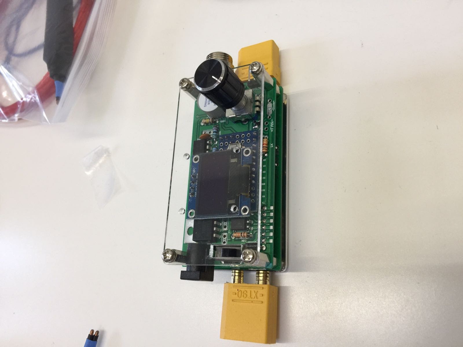

I have been doing the first charges and tests today. It has enormous power.

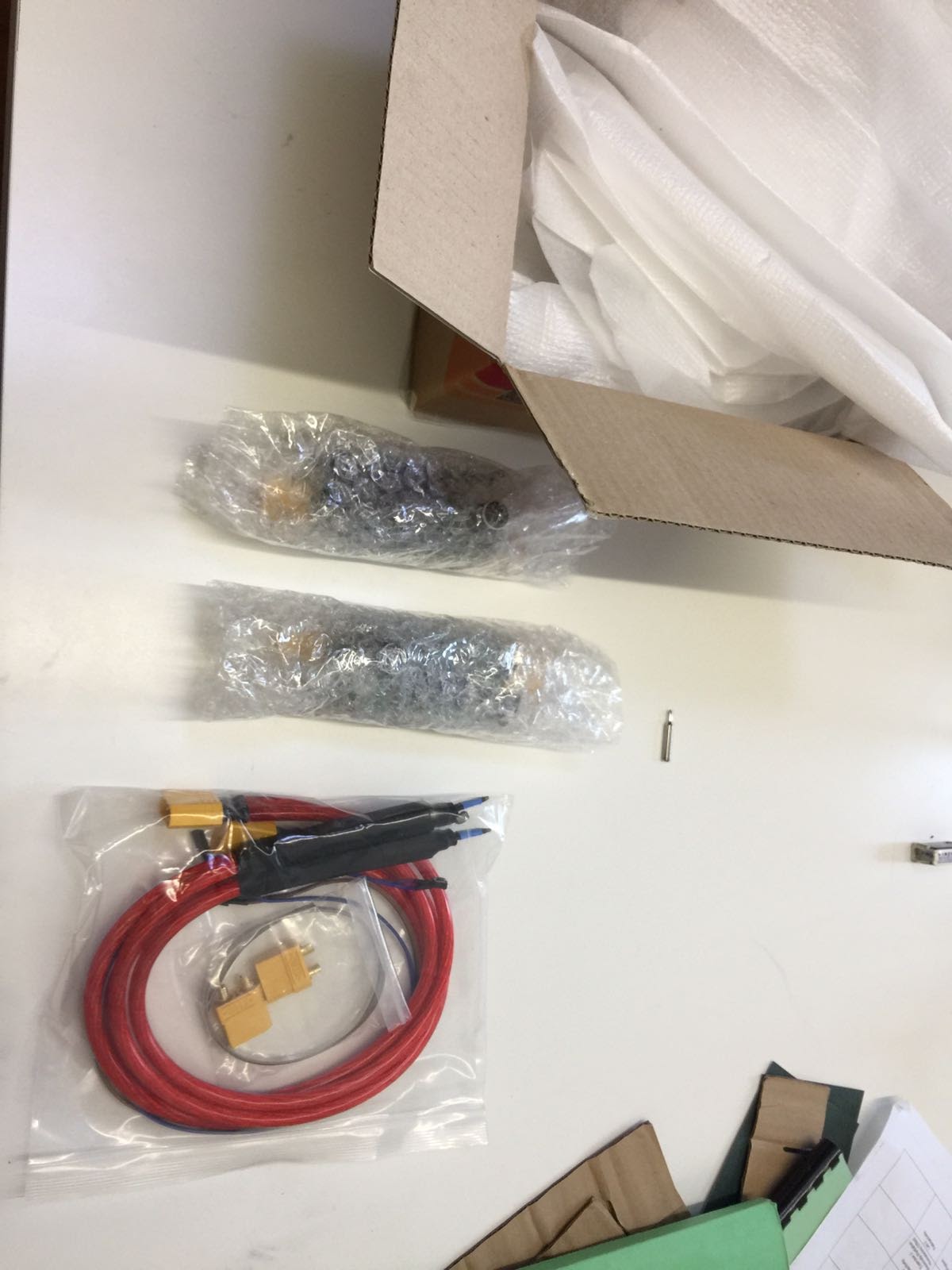

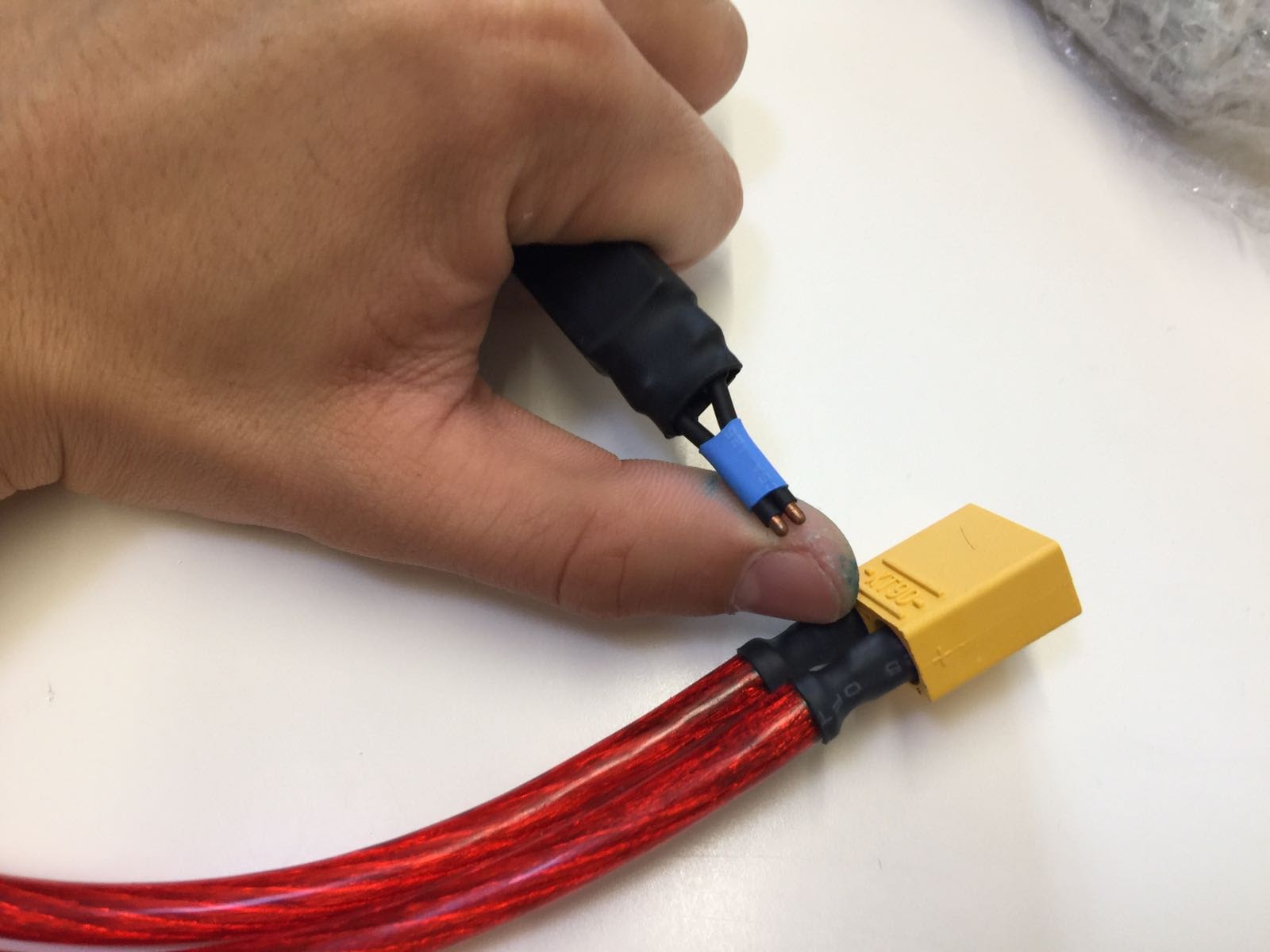

I've just placed an order for 2 of those welders with ems shipping. Could u tell me the size of the cooling fans that u are using?
Thanks for the info! I was expecting 1 -2 weeks via ems to Singapore, But it took 4 days instead :shock:
[img]https://i.imgur.com/zcsd7fN.jpg[/img]
I got mine very quick too. I guess the korean post office is very efficient.
Share with us your experience with the machine.
Pics and videos are welcome.

Isnt this spot welder is just a arduino that is controlling a bank of FETs connected to a LiPo? I'm sure you could add more FETs to the spot welder, but there barely any space internally to solder the FETs to, so perhaps a better option would be just to wire up another bank of FETs and use this spot welder to control the timing of the FETs switching on and off. There's another thread somewhere about using a zener? and TVs diode to prevent the inductance of the Battery wire and spot welding probes wire from causing avalanches current that damage the FETs, so look into that as well.
I think that you can use the screw and nut(compressions) method to secure a new bank of FETs to a 1 or 2mm thick copper plate and attach your new set of spot welding probes to it. And hookup the gate and source (or was it gate and drain?
I don't have a electrical engineering degree) to the spot welder to control the timing

In a chat with Aulakiria some time ago he told me that this machine could be incredibly powerful with more fets and maybe higher rated ...but that would make it considerably bigger and expensive. Since he designed it for nickel and wants it to be as small and affordable as possible he does not plan to do it. Besides it could be kind of dangerous. The automatic machines of the battery factories do not have the fingers of the operators that close.
