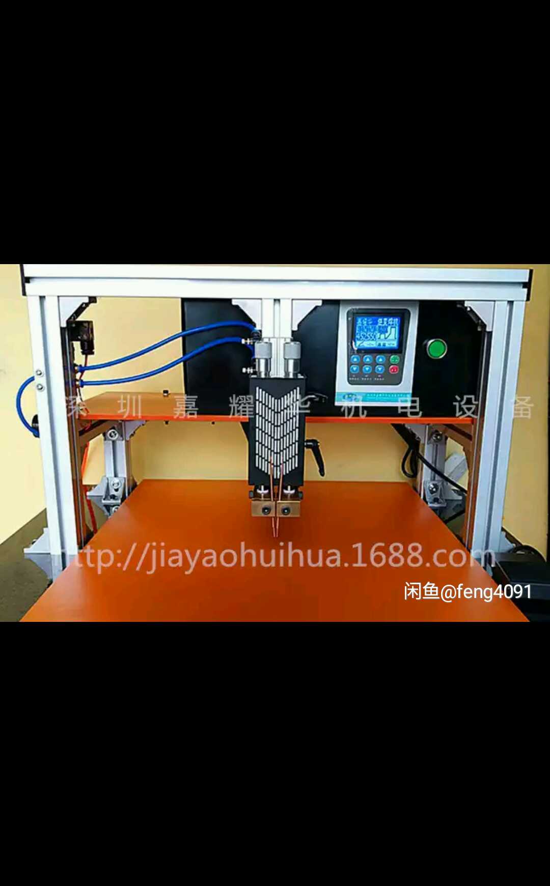

If you watch the factory tour videos of the battery pack factories, you can see that they have pneumatic powered spot welding probes that comes in contact with th battery and nickel sheet at a perfect 90 degree angle and with the same amount of force each Time.
That consistent welding probes angle and force on the battery has to be achieved first before we built a more powerful spot welder as we need ALL the welds to be consistent. Imagine the amount of molten metal splatter you'll get with a more powerful spot welder if you don't place the probes properly. I'm trying to find a pneumatic powered spot welding probes for this purpose on taobao.com and I'll be attempting to ensure 100% consistency in all the welds with this spot welder .

Considerably bigger is subjective as a bank of high rated FETs would still be smaller than ur laptop in my opinion, with a small heat sink of course. But we definitely need to have proper spot welding probes that looks like this and it will be a lot bigger because of it.

Hmm, wire.rat, that looks quite similar to some of the 3d printers I have built.... and the idea of repeatable consistent welds does sounds nice. Considering these welders are arduino based in the first place.. and the absurd amount of extra parts I have from my 3d printer builds, I am very tempted to possibly try to build a an automated welder that could press down for an exact amount of time and pressure (and of course consistent power). Could be interesting.. literally have everything i need from framing, motors, linear guides/ballscrews/leadscrews for the movement, and even some board I could use to control it all... would just need to make/get some good welding probes and the electronics for the spot welding. Could be a fun project... and ironically, if done right... would produce a machine likely more capable than your standard entry level industrial spot welder (which are pretty damn expensive). Hell... it would even be easy to make an X & Y axis as well, to actually be able to do rows of spot welds on batteries in a jig. Now that I think about it.. it's actually a relatively easy machine to build, would not be that drastically different from a 3d printer or cnc machine... at least as far as the movements would go.
