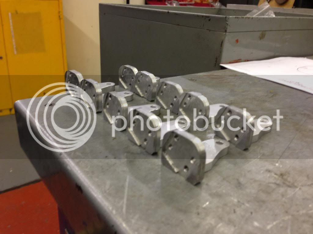

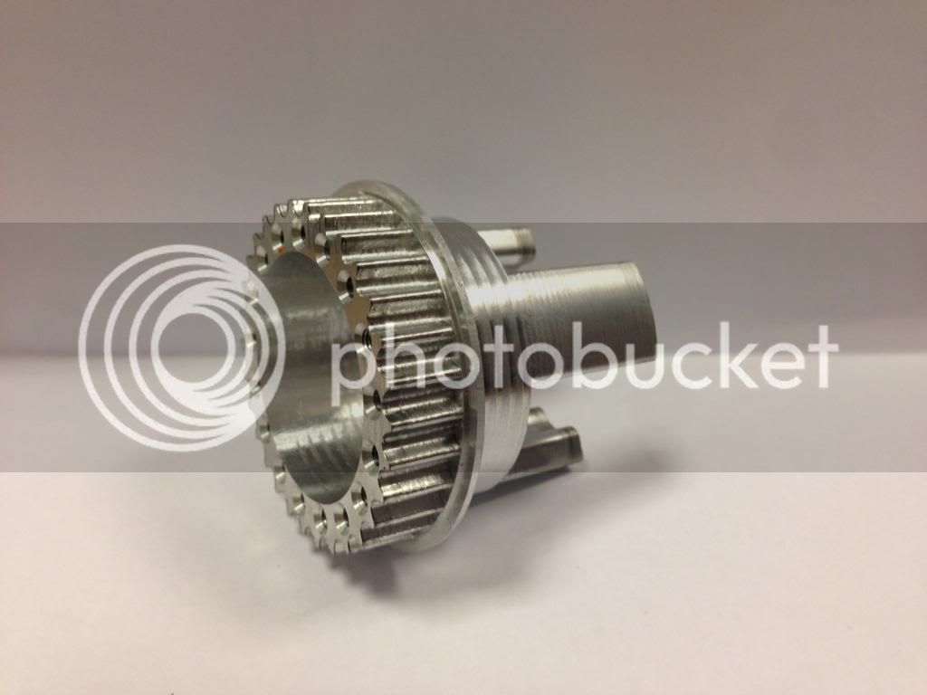

Ive been asked by several member about producing a kit of my project and i can now offer it.

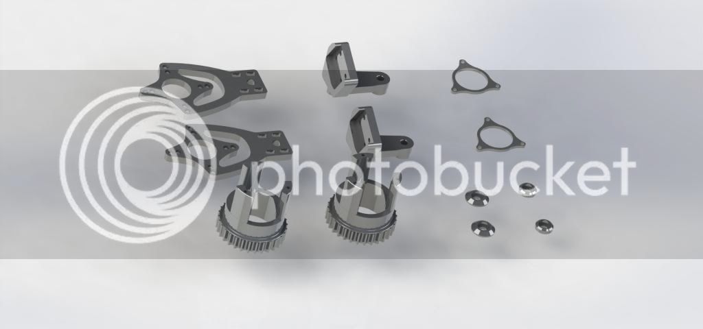

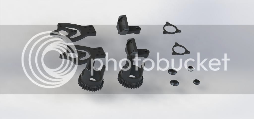

This will be what you get in a kit for the Holey/Abec 11 conversion all CNC machined and laser cut from 6082 aircraft grade alloy
either alloy
or anodized black/blue/red
I think around £139 in alloy and £149 for black for the full set inc fasteners /belts etc. Bruno will be selling the ESC,motors and Wii nunchuk controller to suit. prices to follow

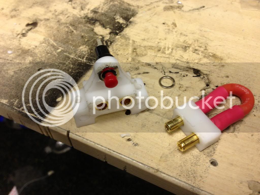

I also have a high voltage arming system inc antispark- these will be about £20 ish.

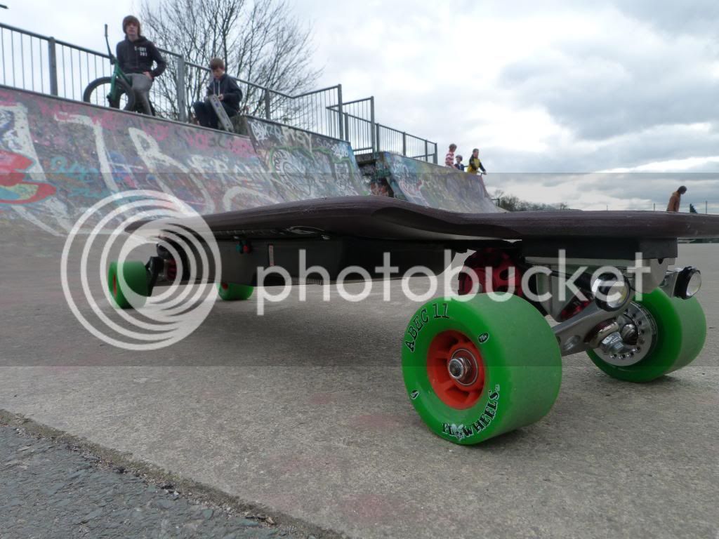

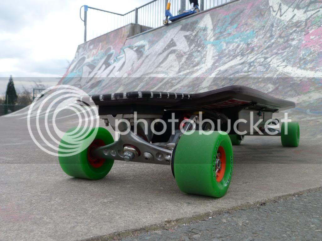

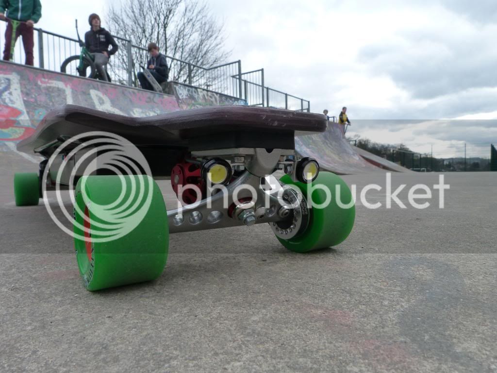

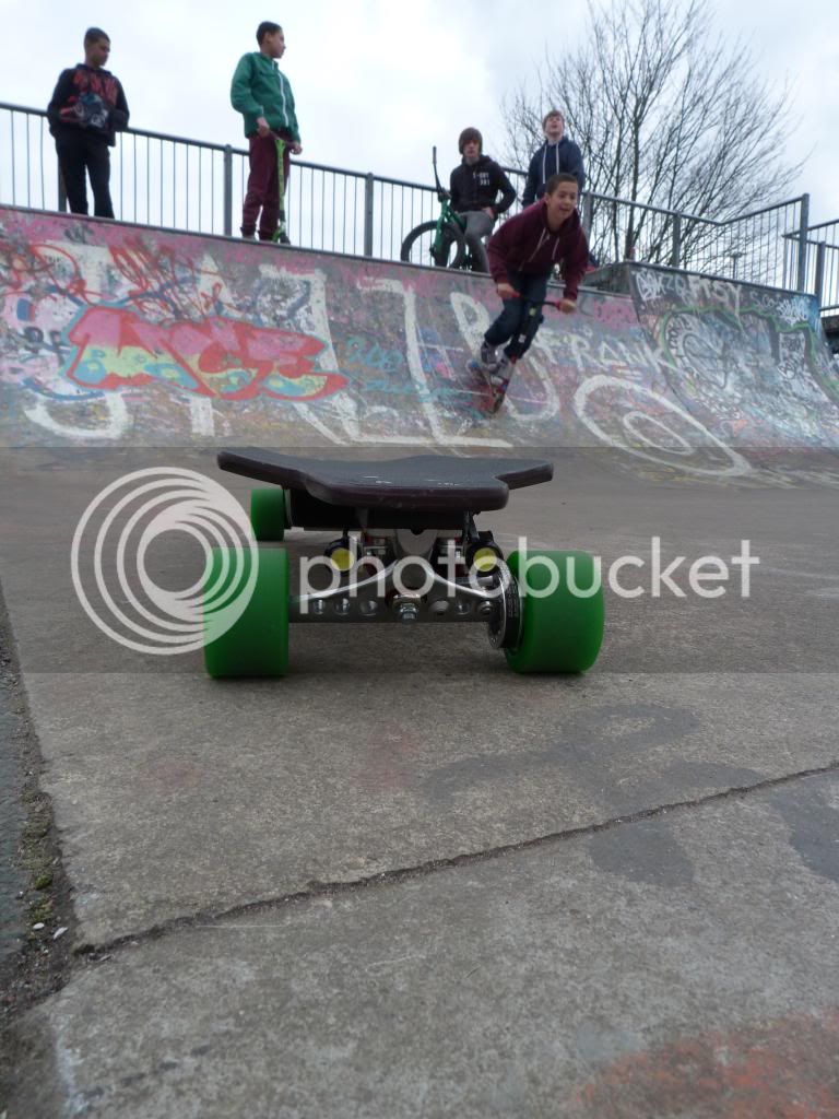

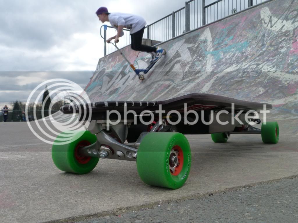

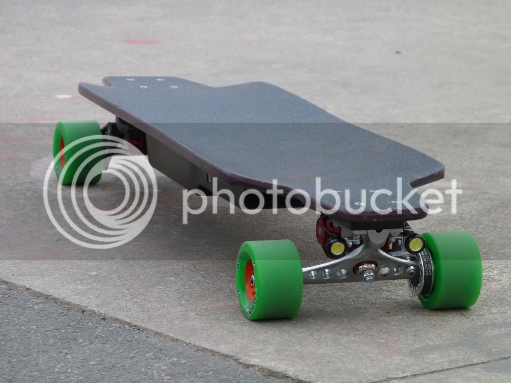

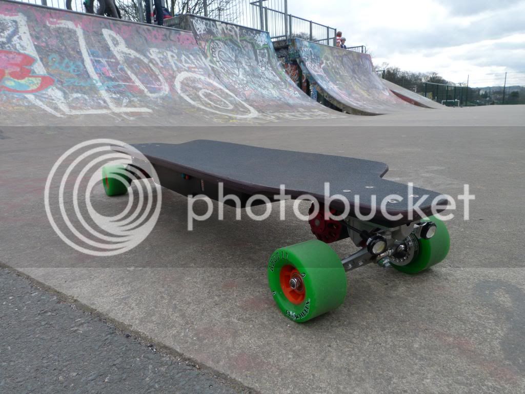

Here we are with the new deck and all LEDs fitted.. It carves absolutely brilliantly the concave deck is so much better- i can have my trucks tighter for more stability but can still turn at tightly as before.... ill post some pics later of the LED's on! when it gets dark ..p.sw the kids at the park are going wild for it!!
so next mods to do are a custom grab handle and to get the nunchuck working perfectly,regen braking.

Are you offering just the mounting brackets at the moment? Will the kit come with the drive belt as well?
The kit is everything u see in the photo of the parts inc belts and bolts.
So that's
:2 x drive hubs (CNC 6082)
:2x truck mounts (CNC 6082)
:2x motor brackets ( laser cut 6082)
:4x truck mount boss's ( CNC 6082)
:2x belt washers ( laser cut 1050)
:2x hub retainers ( laser cut 1050)
:2x high torque 5mm pitch belts
You then need a set if Holey trucks and Abec 11 flywheel (83mm) and your own deck and your away.
Obviously you also need the motor/ batteries / ESC which Bruno can provide .
I can also provide the LED kit with power transformer for about £30. U would need to add switches if your choice to that.
Hope this answers your questions ..
Just to update :-
The complete weight of the new board is now 9.25KG!! super light for an electric deck.. The Elektroskate air which has 7AH battery and 1x 500W motor is 8.9KG. Mine has a 8ah battery and 2 x 3000W motors!! so a great weight to Power ratio!!

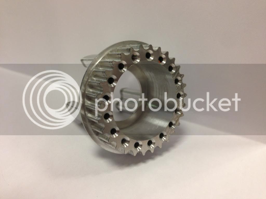

Is the small cog included in you kit ? If not where did you find it ?
Also, are you considering selling half kits for people that want to do single motor ?
Thanks ! :)
Hi Ttw
The small pulley wheel I can supply but the the reason its not on the kit is because it depends the wheel size your using as to what size you need..So i left that up to the customer to buy..
A 15tooth (83mm wheel) supplied with the bore machined to suit a 10mm motor shaft,a 3mm keyway machined and a 2mm grub screw in it , will be about £12 so not a lot.
Yes i can supply just half the kit for one wheel drive.. that would £69 plus P+P..
Hope this helps

Where did u get the small pully or what are the belt spec's so we can find pully's smiler but different bores.
But are you ready for shipping?
The belts are 5mm HTD 9 mm wide. I will provide the belts , I'm just finalising the length as the new brackets are a bit shorter. I should be ready to ship next week . I will post a message to everybody interested . Thanks for the patience but want everything to work perfectly ..
Hi
Just to add the belts I will provide will be to fit my 30t wheel adaptor and a 15t motor pulley. This is to be used with a 83mm wheel.obviously if you want to use a larger wheel the gearing will need to change which will mean a different length belt.

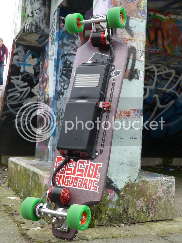

Does the motor fit without the spacer between the truck and the board ?
And do you have more details about the motor you are using ? (rpm, max current/voltage, diameter)
I am willing to convert a board and you kit seems to be way easier to go than anything else :D
thank you !!
Hi
No the kit does require a 1/2" rubber riser . These do a number of things it gives more ground clearance for the motors and gives some vibration dampening also they also make it turn quicker and stop the dreaded 'wheel bite' which is why i initially fitted them as the 83mm are quite large . I can maybe supply these also for about £3.50 a set.
I know hardcore 'pushers' prefer the deck to be as low as possible but as you will never push again.. .....
The motors are 63mm diameter 170kv so at the 36v I'm using there about 6000rpm and the kit reduces this to about 3300rpm at the wheels...

I can add I went out last night on in (in my new Kevlar lined jeans ) and after Bruno's tweaking with the ESC firmware... WOOW So smooth now!!! Really nice low rpm set off and super smooth acceleration.. I know a lot of people complain that the initial set off on rc drive kit is too harsh..but Bruno has sorted that problem.. I actually caught up to a Porsche Boxter...!! He was a little surprised!! Admittedly he was only doing maybe 35mph but it was still funny!!
Very smooth, I do like the sound of those motors spinning up.
I was wondering if you get any torque steer with your setup, seeing as you have one driving wheel at each end.. When you are accelerating/braking hard or riding up a steep hill, does the torque try to turn the trucks and make the board steer unintentionally?
