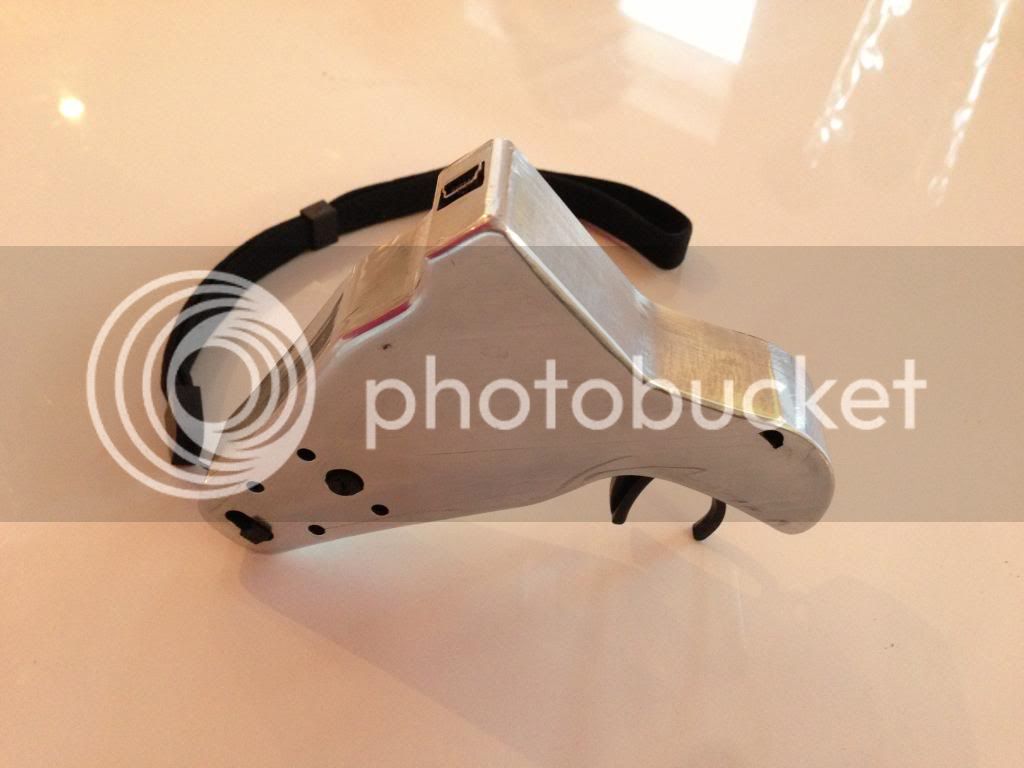

In the meantime I've have been working on a new hand control using a using a nice lightweight Rc handset with built in Lipo - so i still maintain the fail safe ability but I've made it quite a bit smaller . Its housed in a Aluminum /Carbon shell and fits nicely in the hand.
Ive bought a smaller lipo to fit in and re soldered the transmitter board to make it smaller again..
Its a bit rough and blocky for me but does the job well. i will make a complete alloy casing when i have a bit more spare time and make it in two halves with more radii on it..
(for all the members waiting on the kit- Its nearly finished and the belts have now arrived and i did an instruction /fitting video last night- so i will post that after a little bit of editing)
the transmitter-
disassembley begins!!
the board before re-soldering -notice how the transmitter board sticks out--
its now being reversed to be over the pcb board.
the housing with electronics
shiny!!
carbon..hmmm
still maintains charging port-- :D
it sits there for a while before it sends...
