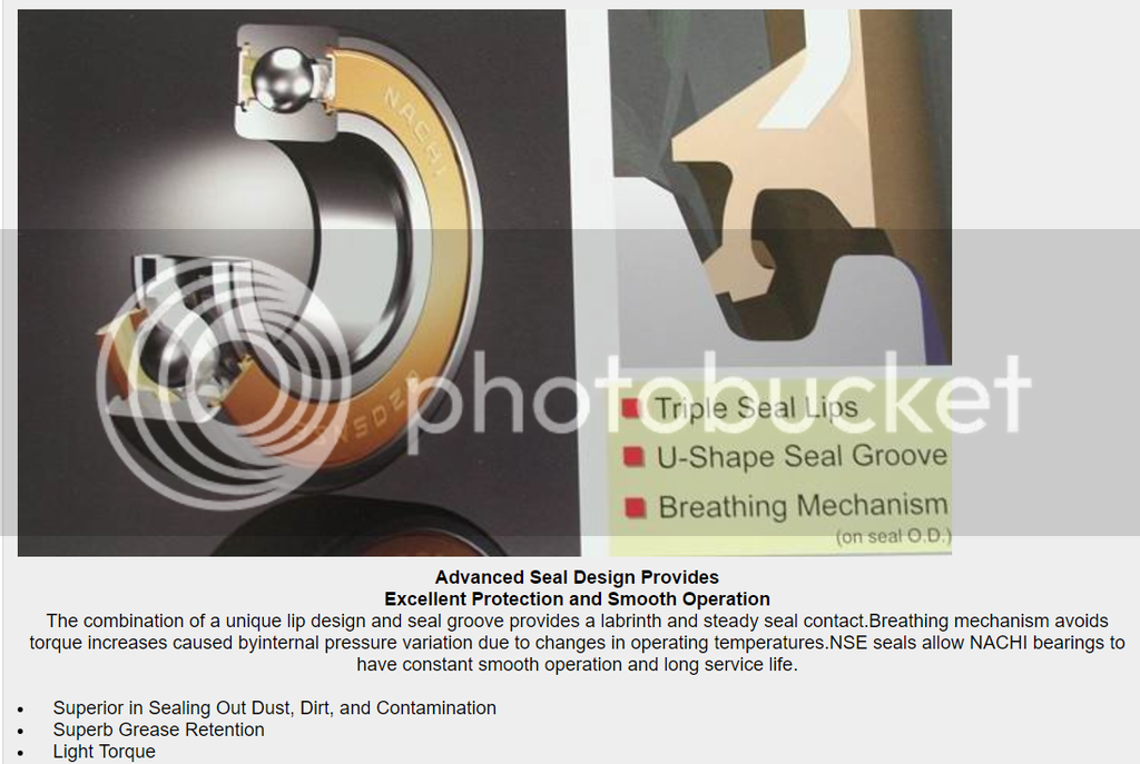

If you need new bearings you may want to try these Nachi bearings. They may seal out the oil better, but who knows. They cost just a little more than the china bearings, and you are getting Japan made bearings.
Would be interesting if you used one of those pressure valves like madin88 mentioned to see if that helps any.
I picked up those Nachi bearings for my cromotor, so you will have to see if they have the size for your motor. They may not.
https://cnc-specialty-store.com/bearings/ball-bearing/6204-2nse-nachi-bearing-20x47x14-sealed-c3?zenid=4b8e72df88976c403f697a2730ee29f6
These bearings look like they could be the answer . Looks like they have a rubber seal around inner diameter where the axle passes through . I will check them out in the near future . Thanks !

Thanks Offroader I ordered the bearings you suggested only cost $ 22 dollars delivered ! Got the size form the Grin web site 17mm x 40 mm for all H Crysolite motors !

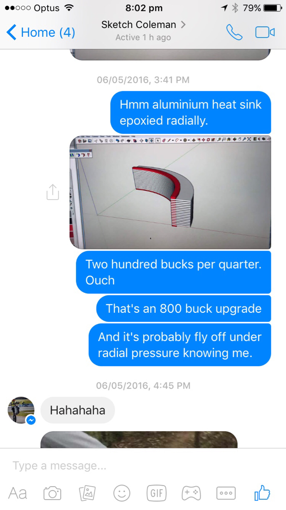

Heres the 3d laser sintered aluminium ones sketch and i were playing around with models for at the start of may last year
Anyone is welcome to take the 3d files for free and reprint on shapeways.
https://drive.google.com/file/d/0B9yGWuHxeLnjamIzQWhPMXczRWs/view
Ironically it was while pissing around in 3d on that day a year ago today that i dropped this concept on the facebook chat screen! Little did i know! That 3d model is still sitting on shapeways servers. So expensive.
It made sense to pursue the hubsink as a concept. Sand bugs and shit inside your hub via venturis is not as good an idea. Take it from a guy with an eng degree. Air is an awful thermal carrier.
