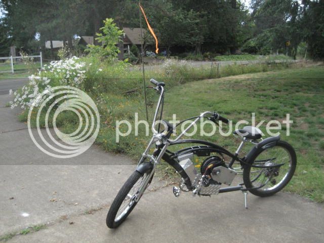

Here are some pics!
I'm currently exploring the idea of using some form of "fuel tank" style battery cover, but I am still a bigger fan of something just above the motor, but with weight distribution, I think something in-between the top and middle tubes wouldn't be too bad, especially with LiPo.
No new pics (forgot to take them, doh!) but she's on the road!
We have a long steep hill here in Oregon City, and I road up it in the bike lane passing cars today at 28 MPH!!! :D
I'm now running at 18S with 90c Turnigy Nano Tech Lipo, pulling only 25 Amps, averaging around 1400 Watts on the hill, otherwise closer to 250 - 500 Watts just cruising around with light pedaling, and couldn't be happier! 8)

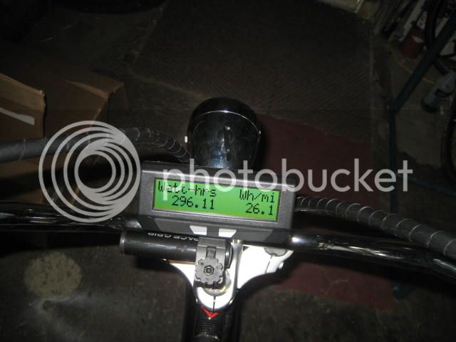

Now some CA Stats! This was pretty good for a start, and I did do some pedaling, but most of the hill climbing was motor only, so I'm pretty satisfied! I will do some more testing with motor only in the future when I get the battery boxes finished and soon I will be upping the Amps, after I get a temp gauge hooked up, but for now, it's doing everything I need!
So far, with NO pedaling, it has conquered Singer Hill (steepest part of the climb at 7% grade) starting at 15 MPH from a dead stop, and accelerated to 17 MPH during the climb!
At the second steepest, I was passing car traffic in a 25 MPH zone going 28 MPH (with some pedaling, ok I got excited :lol: ) going up a 5% grade for about 1/2 mile!
After all the fun and games (this was after a couple other day's testing, so not on a fresh charge) here are some CA stats:
