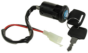

Got some more progress, after getting a really cheesy ignition switch from Ebay (looked fine in the pictures .. :roll: :p ) I found one that I really like! It locks the key into position when it is "on" and could be attached to a clip much like you would with a motorcycle or sports car so you're not hanging an entire key-ring on the switch.
The really nice thing is it's just about 1 inch in diameter, so if you have an 1 & 1/8 size steer tube, you could remove the cap and star nut on top and put one of these switches in a nice natural spot!
I have a 1 inch steer tube, so it won't work on this bike and I like having it closer to the controller anyway.
Here is the site I bought it from: http://www.electricscooterparts.com/keyswitches.html
They have phone support too, was really nice to get someone on the phone to measure the body of it before I ordered it!
Like this?
http://electricle.blogspot.com/2009/02/first-road-ride-about-6-miles.html
:) mine's not really a steer tube, but an extension made from a seattube upside down clamped around the steerer, but the same thing applies. Mine is mounted just using foam tape around the keyswitch and stuffed in there, but a much nicer cap could easily be made to mount it like that.
amberwolf said:
Like this?
Great minds think alike eh? :wink:
I have done the same thing with a seat post tube to make the mast on my recumbent, just wish I had found this switch sooner, as the mast has a cap really only for show, and it would be much much cleaner looking with it mounted that way, I may get a second one to install on my recumbent similarly.
I have used some pretty typical keyed switches in the past, but the annoying part was half of them didn't capture the key when in the on position, so I would have a retaining strap of some sort to keep it from being lost, big hassle since I wanted the key to be there as an easy to reach off switch, so I am excited to test this one out!

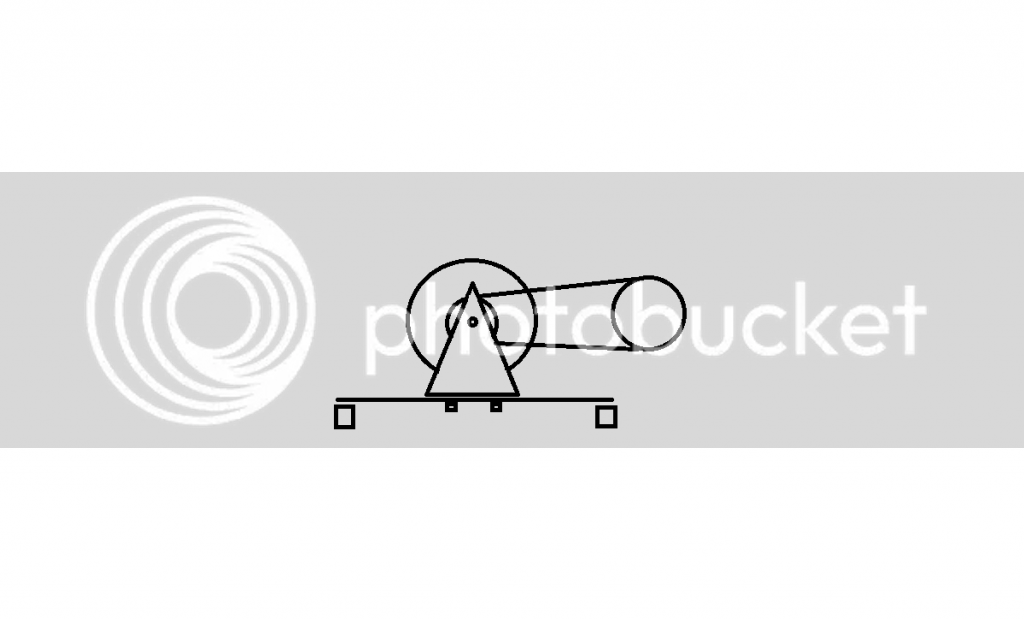

Ok, here is my new design to hold a hub motor in the same area of the frame of the bike as the current motor:
The plate that the cradle would sit on will have slots and 2 - 4 bolts along the bottom with captured nuts on the other side to allow you to simply loosen, get the desired tension, and then tighten them back up.
This should eliminate any need for a tensioner for the motor chain.
Thoughts?
Thanks!

Only that that plate needs to be very stiff. I had a number of problems with my similarly-tensioned/mounted powerchair motor on CrazyBike2, when I used a 3/32" pretty hard steel plate, which was welded solidly across bottom of the tubing of the spread-out rear chainstays of the front frame, more than a wide handspan width where the dropouts would have been. I added another thickness of the same stuff, spot-welded thru around the areas it'd flex at and all around the edges, and it helped a lot--but it still flexed enough to *see* the chain sag a bit on the unloaded side. I think starting with 1/4" plate would have worked better. Or harder metal.

Thanks AW!
I agree, and I should make a new drawing to better reflect the design, it's going to have those two horizontal square tubes a lot closer together, so it won't have that as much of a possibility, and depending on what I decide, now that I'm not as concerned about welding on this frame, I might just anchor that plate directly to the frame and that would give me a lot more flexibility, so that I can eliminate some of the space needed for the two horizontal tubes, giving me about 1 1/2 inches more vertical height to play with.
That would only require me to space out the two to four bolts onto either side of the motor plate, my main concern is getting a "cradle" that is of sufficient thickness of plate (I'm thinking 1/8" should be more than enough) and I can always skeletonize the pyramidal sides to take off some weight with out losing any strength.
I could always go straight up with a couple of rectangular pieces of tube, but that would probably be just as costly, and would require a gusset of some kind.
I want this a bit over-built so that you can add tons more power later if desired with out having to beef up the mount.
Ok, here is a more comprehensive picture, and more minimalist design. (the red circle represents the larger diameter mini-hub monster (it's only about 2" larger in diameter, but 2 inches shorter length!)
One nice feature of this design is that I can hopefully eliminate the need for a chain tensioner (for the 2500W and lower power zone) due to the lack of flex that should occur with a ridged grooved plate construction that will stiffen it up considerably on the flat areas, and if it really needs it, it can be replaced with tube in place of flat bar. The ease of mounting is as simple as removing the rear tire, sliding in the motor, and then replacing the tire. This will only give about 1 - 2 inches of play to tension the chain, but it shouldn't really be an issue with half links available if needed.
It may require more "boxing" with a third set of "arms" to beef up the triangle of the mount between the motor and seat post, if it proves to be too weak, I want to keep weight down, but I want it pretty much set up so that if a prospective customer so desired, they could bolt in the larger Hub-Monster and go bat-crazy with power, but with the mini-monster, it makes a nice starting point (and yes, I know the mount will need larger slots to accommodate the hub-monster, but if you're going that far, what's a little widening of the slots right? 8) ) but be capable of much more.
Thoughts?
Thanks!
Less is more AFAIC, and this one seems stronger than the first. As long as it's rigid enough, and you like the look of it, then that's what matters.
My vote would be to plan on a spring loaded idler instead of trying to avoid it. IME that's the route to the quietest chain. Bike hubs and bearings can't maintain a perfect alignment under the load an electric motor can put on the sprocket. An idler that guides the slack side of the chain into good alignment with the sprocket and prevents the slack side from dancing around makes a tremendous difference in noise, especially with it in contact with more sprocket teeth moving at a far greater velocity than on a pedal bike.

Thanks for you input John, I think you are right, if I start going higher powered, or experience chain chatter even at lower power (around 1200 Watts) I will be employing some form of tensioner, but I still like to have the ability to move the motor back and forth for to adjust chain tension initially.
