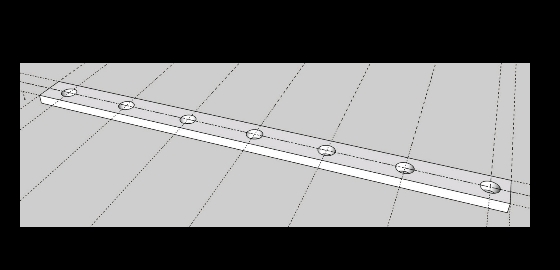

Just sketchupd busbars for battery. L142mm, W10mm, H4mm
Hopefully get them machined by Friday in copper

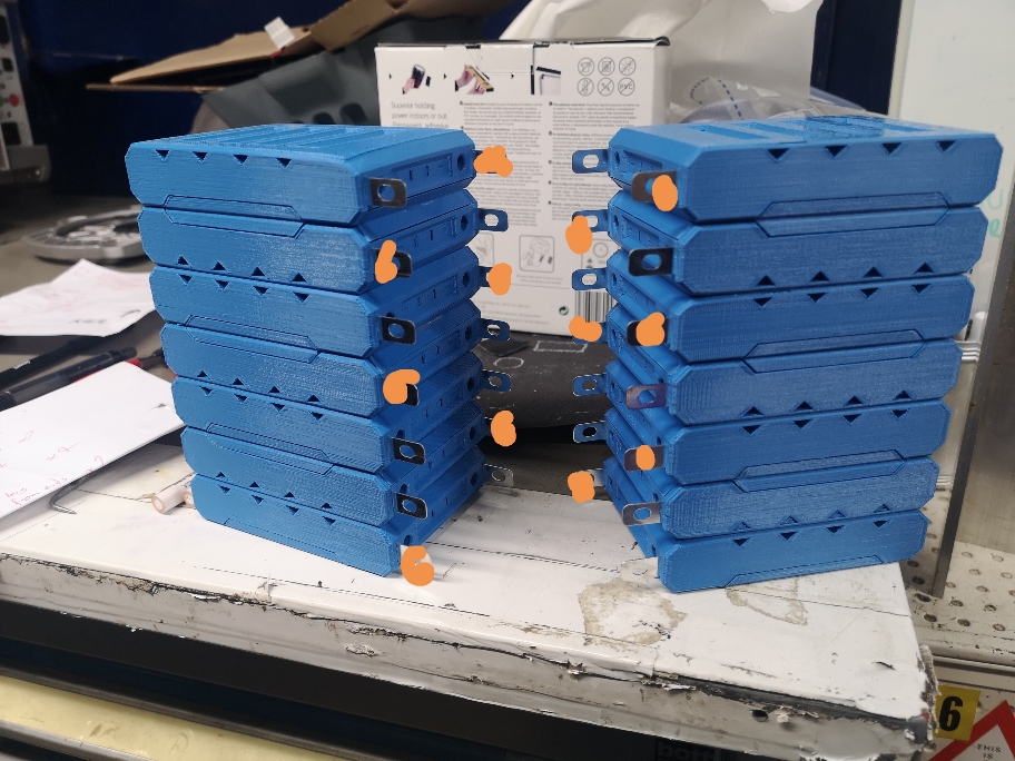

well the negative obviously needs to be on the most negative and the positive goes on the most positive terminal but all of the ones in between it doesn't matter whether they are on the positive of the lower cell or the negative of the higher cell as that wire is at the same potential difference (negating the wire's resistance which is very low). Its one of those annoyances as you cant make a symmetrical pattern with it (unless you put the tap halfway between those connected +-'s) but ain't nobody got time for that. hope that all makes sense. eagerly awaiting pics of the finished article.

I'm not sure I understand the bus bar you drew. I thought you are running 14s and if so that pic with seven holes in doesn't make sense to me. Are you cutting that bar into cell connectors (and if so didn't agnuism provide those, cause he did for my mate who did a similar 10s8p battery)

I couldn't fit them in, in one length so will run a u shaped bus bar.

It still doesn't make sense to me. if you use a bus bar, this is to parallel cells, you have 14 cells packs and if you use a bus bar like the one in the photo you will be making 2s7p which is a 7.4v battery with a load of ah. It may just be me but I think that bus bar you are showing isn't what you need.

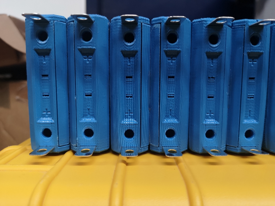

Sorry. Each of the cell holders alternates +- on top. So that should give me 14s unless I've massively misunderstood something.

if you want 14s you go
1 2 3 4 5 6 7 8 9 10 11 12 13 14
i.e. the pos of cell one connects to neg of cell two, the bms wires tap off neg of 1, pos of 14 and every connection in between.
with that bus bar (or rather 3 of them)
1 2 3 4 5 6 7
8 9 10 11 12 13 14
you have 2s7p,
I see no use for that busbar in a 14s pack

Is that not what I would have. Bar across the top would be -, +, -, + etc
Sent from my CLT-L09 using Tapatalk
Yep the last image is right. The bus bar is unnecessary and dangerous if it is essentially shorting out the very high amp capable cells.
Yeah I've no idea why I thought that big bar was correct.
The clue was in the fact agnisium sells the individual bRs lol.
That's a bit of a disaster avoided. Thank you for your persistence dude.

The other thing to be careful with on your pack design is to made sure that your two halves that are connected together in the pelicase don't have terminals which can accidentally touch again shorting out the pack. Either use something to space them that is an isolator or have your terminals facing out from the middle with a longer wire in the middle to connect cell 7 to cell 8. :bigthumb:
Yeah I got some nylon to go in between the two

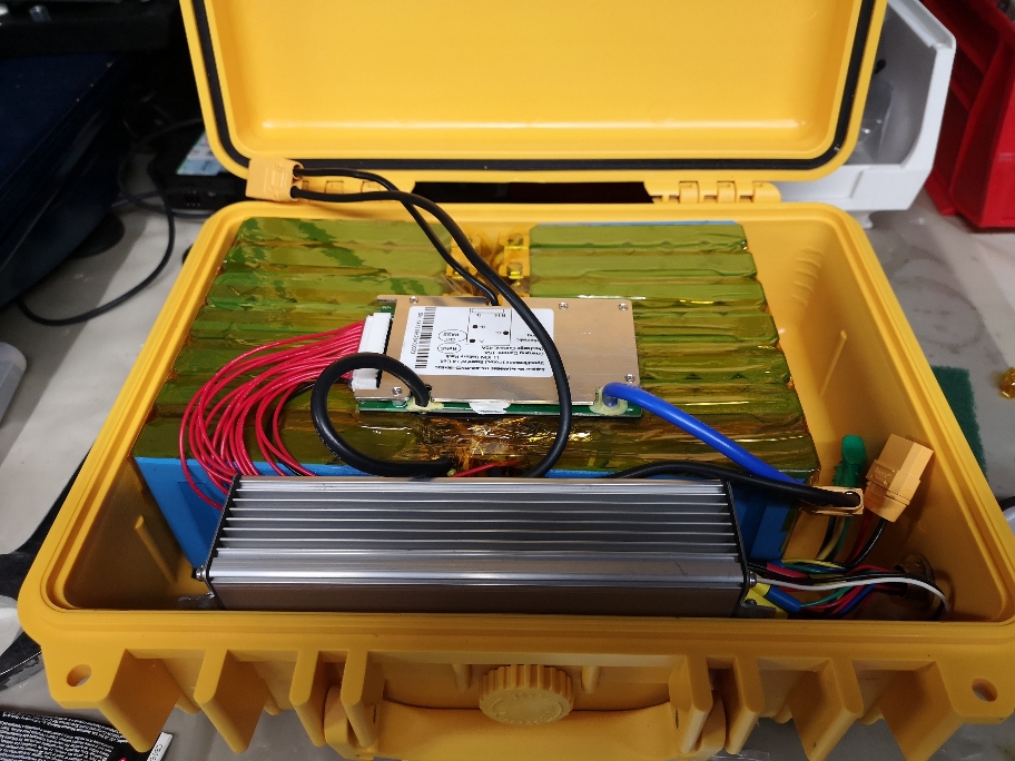

Battery is finally all connected.
Controller is all wired up to a multipin connector on the side.
Undecided what I'm going to do with the 3 motor wires. Probably XT90 connectors as I have a bunch of them.
Only showing 49v though. So cells are at 3.5v and ready for a charge. Case is weighty but not as heavy as I thought it would be.
Also run kapton tape in between both battery blocks and nylon screw in between to prevent both sides touching.

not sure if the mosfet heatsink screws to the side of the controller like the infinions i had but you might want the cross/phillips screws facing up to let the heat out.
looks like the controller is sitting on them?

You mean these screws?

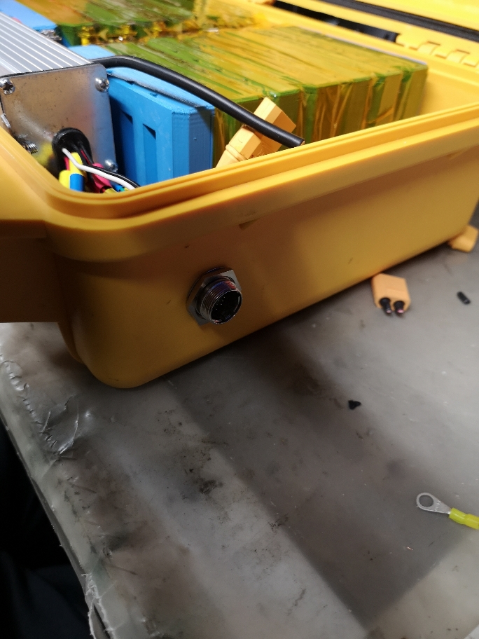

Nope those just hold the ends on he means ones that run along the side of the case and hold a piece of aluminium to the case which has the mosfets attached to it. To be honest if the pelicase is closed it wont matter which way up the controller is pointing. It will heat up the case and potentially overheat the controller and the batteries. Far better to put the controller outside the case in the direct airflow. Also its one less metal thing for the battery terminals to short on.

General day to day the case will be cracked open, maybe couple inches while riding. I'm working on a better solution to ventilate the case just haven't come up with a way I'm happy with
