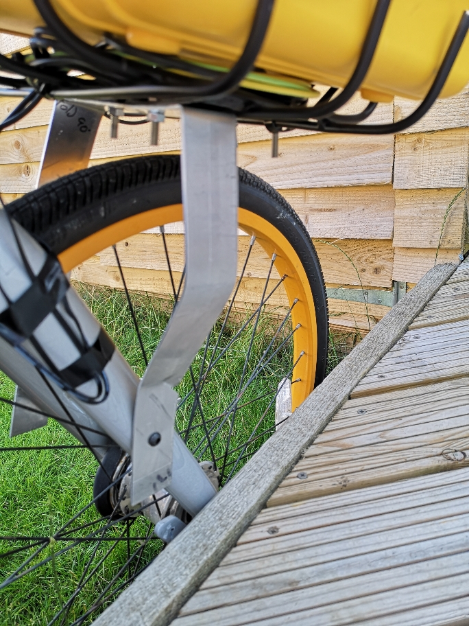

Few test rides round the site I work and all was good.

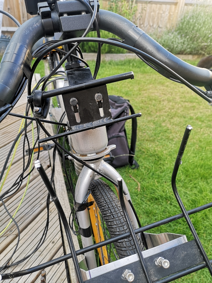

First ride out on the road and this happened.
Snapped the welds on the basket and bent the support on the front.
I think contributing factors were poor design, inadequate materials and solid front tyre.
Remedies will be to mount the battery in the frame as low as possible and proper air filled tyre. Same as on the back.
On a side note. When riding it topped out at about 50kmh. The display read 55v and 1600w. This is slower than I was expecting (but honestly plenty fast enough without any brakes). Need to investigate what's going on electrically.

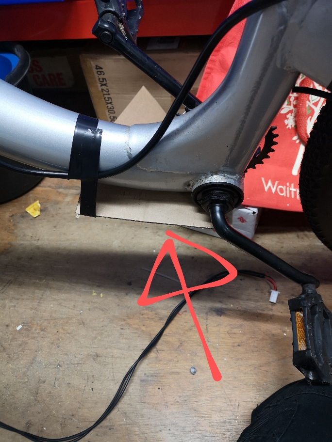

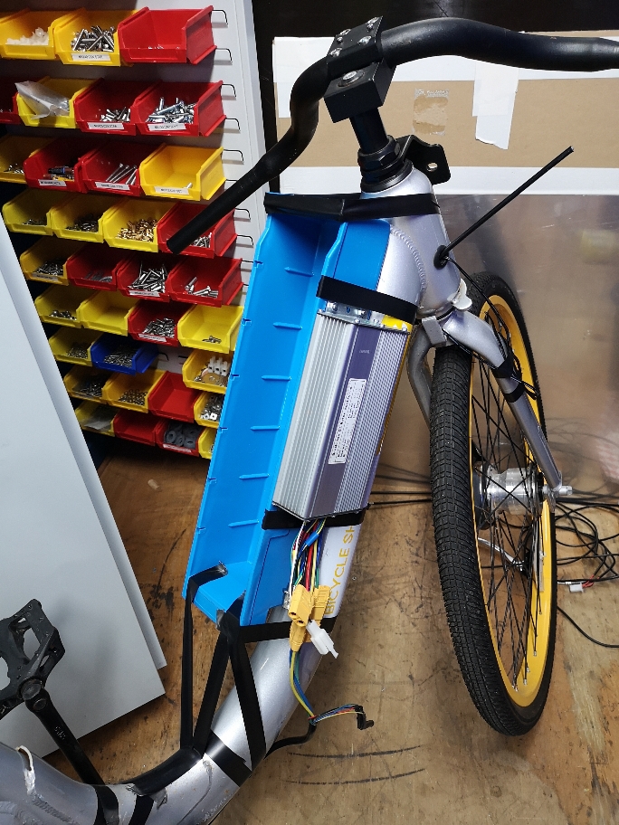

Looking at options for locations for the controller and battery.
What could be possible issues with putting controller on the bottom under crank, other than obvious impact.
Leaf controllers are waterproof right?
Sent from my CLT-L09 using Tapatalk
Essentially, unless it's potted like the Phaserunner and some others, so it can't be opened up, it's not waterproof.
If it's IP67 rated, you can consider it waterproof for the purposes of riding a bike around in the rain.
Even then, if your connectors are not specifically waterproof, you'll wick water into the electronics via the wiring itself, both between wires in multiwire cables, and within the actual conductors inside the individual wire's insulation.
There's someone in the Nucular sale thread with a month-old controller that doesn't get used in the rain, etc., that was I think at least half full of water, when he opened it up after it blew up. I think it ws mounted on the downtube. That' controller has the rubber seals, etc., too. :/
If you want to mount it where it's going to get soaked (like behind the front wheel, in front of the rear wheel, bottom of the bike, etc), expect that it's going to get water in it--if nothing else, it's going to wick in there thru the wiring, and the connectors themselves are going to get wet, and corrode, too.

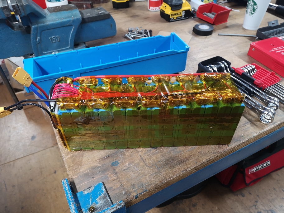

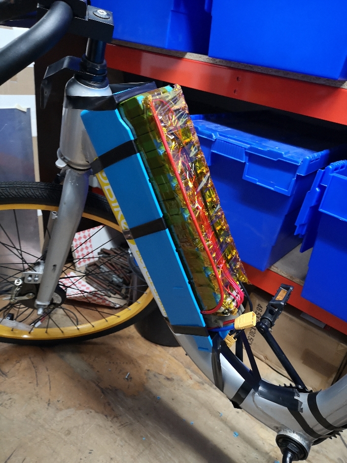

Re did the battery.
Much happier with this one. Looks a lot cleaner. Didn't rush it this time.

Hickbeard said:
I wonder if I could heatshrink the actual controller.
Where will the heat get out, with the heatsink fins all covered up?
Have not checked on this for a while. Is there a reason you have not folded tabs and bolted through the holes on the modules?
Hey dude.
Yeah I originally had the battery in two banks, side by side. So leaving them up made them easier to connect together.
Now I've changed to one long design but I've epoxyed the modules together so can't open them up to put square nuts in.

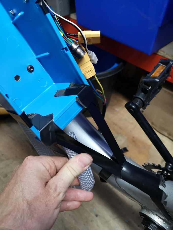

Couple updates. Although not much physical work done.

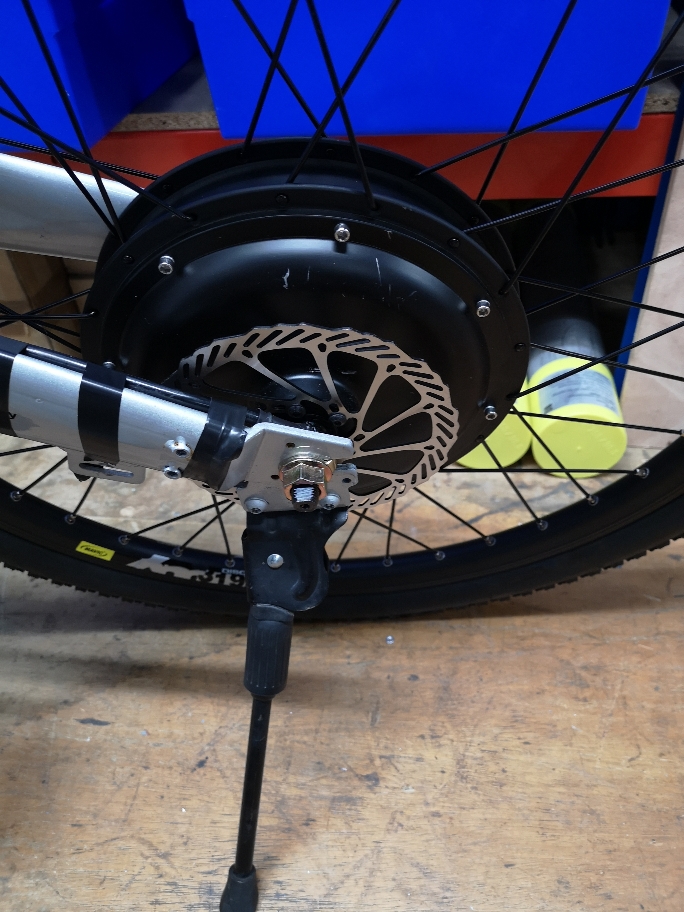

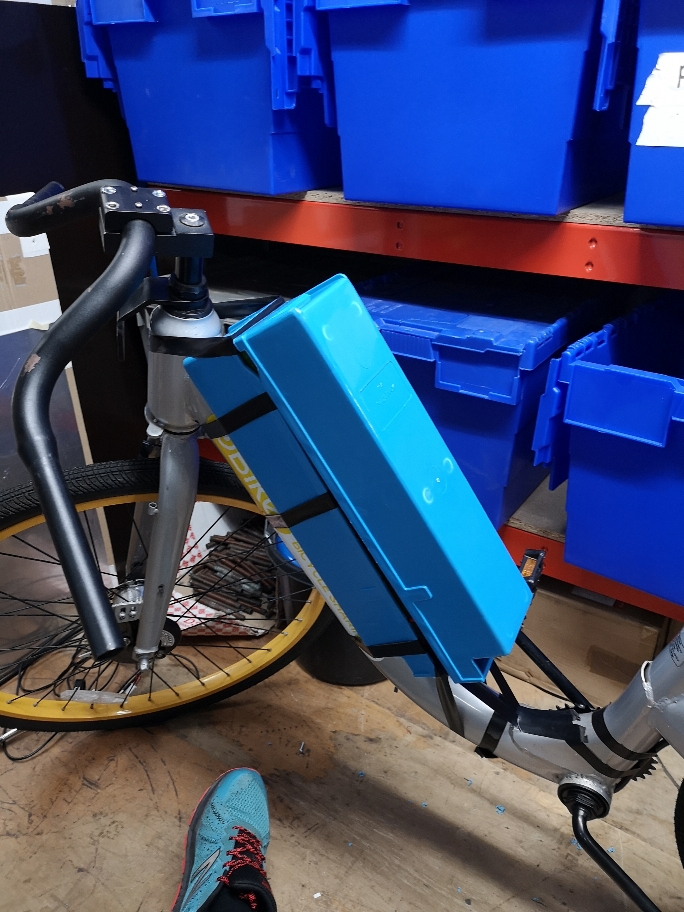

Got my hydraulic brakes today. Clark M2s. 180mm on front, 160mm on back. Fitted back disc. Absolute pain to get rear wheel back on. Really tight fit.

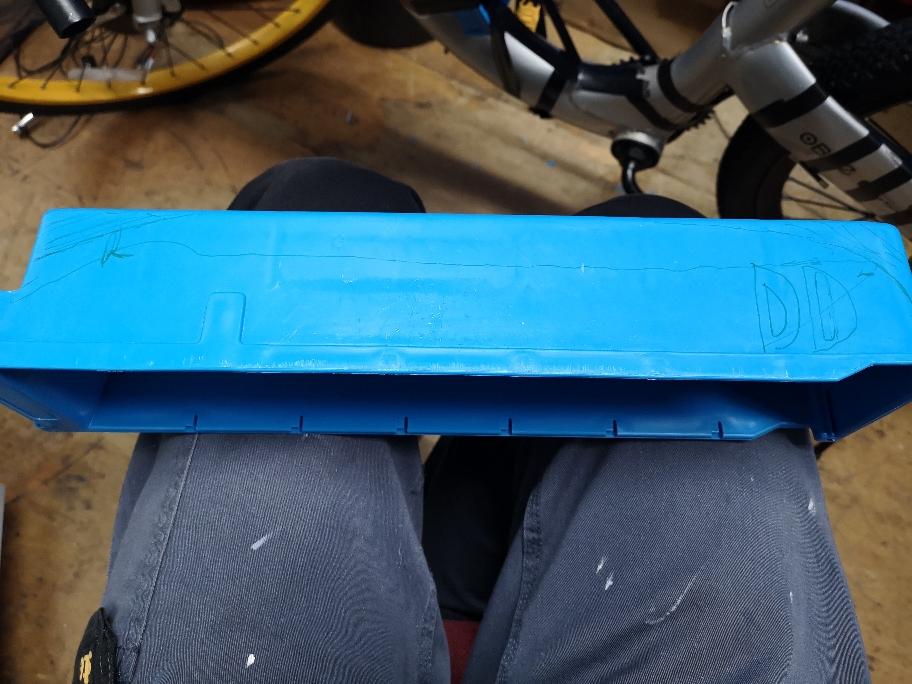

Fitted battery housing to frame and located where controller is going.
The tape is rough outline of where the fiberglass enclosure will cover.
Thinking of running a vent into the battery housing. What are peoples thoughts on something like this hose? Running from top underneath then up the bottom. [emoji1787][emoji44][emoji1787][emoji2357] Then some vents at top to allow hot air out. Will give decent airflow?
Then will trim down lid, fibreglass it and fit hinge at top, rubber seal and lock mech at bottom.

If you let water in, then let it back out.
I would avoid dependence on fans on an ebike.

Wasn't thinking of fans. More like an air scoop at the front running to bottom, with space for water to escape and a vent at the top for hot air.
