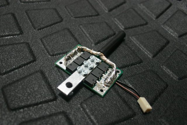

Ok, here is is:
That's how it's gone be done from now on. This makes mosfets easily replaceable (if there is need to, of course).
dnmun said:
just a little overkill on that conductor to the source legs! the legs look like toothpicks stuck in a log.
Well all cables are 25mm2, and so is this one, it felt natural to use same gauge at this spot too :)

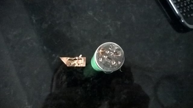

Here is some 0.1 mm copper after tearing from cell, there are holes on all of the places that were welded:
I know it's a bad quality image, but this was just quick, I will do more and better pictures tomorrow or day after.
