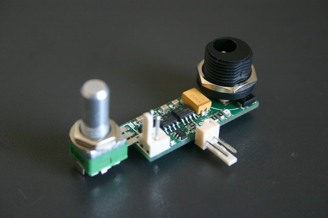

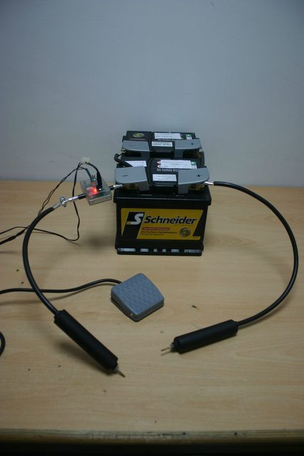

Hi, I'm finally offering my spot welders. After few prototypes had been made and tested, I finally have a final version which I can offer to folks on this forum.
Welders are based on mosfets that switch power from lead starter battery, a concept which has already been tested by some of users. This eliminates limits of your power outlet, and there's no problem if you have only 110 V plug. It doesn't matter because power for welding is being drawn from battery only. However, you need additional power source for logic, that can be small wall adapter or small 12 V battery.
I'm offering a kit that consists of:
Spot welder unit
Footswitch
Two electrodes that consist of - wire, handles, and tips for welding
Not included in kit, but needed for welding :
Lead starter battery, 40 Ah - 130 Ah, or 350 amps to 1100 amps
Standard 12 V wall DC adapter with barrel plug
I'm sure that most of you have this at home, and if not, they are not expensive. I've done most of my welding with one 45 Ah 380 A starter battery, which costs around 45$ in my country.

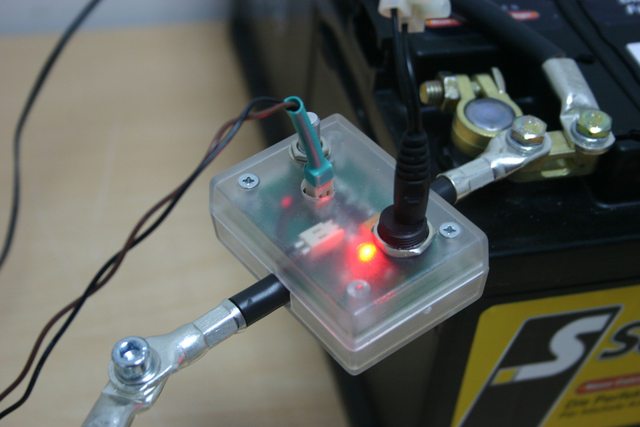

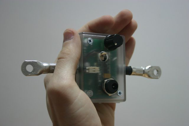

Welder uses battery power for welding, which is switched via six IRF1324 mosfets.
Pulse is controlled by PIC microprocessor, and it's double pulse, in a way that first pulse is one eight of the duration of the second pulse.
Second pulse is adjustable from 0 - 20 ms.
First pulse is just cleaning or surface preparation, and the second pulse is main pulse that does all the welding.
Welding power depends on battery used and pulse duration, and material type and thickness. There are many variables, but for example, with one 45 Ah battery, I can weld up to 0.15 mm nickel with around 6-8 ms pulse time, and 0.05 mm copper on ~15 ms pulse time. With two 45 Ah batteries, I can weld 0.15 mm nickel on 4-5 ms setting, 0.05 mm copper on 10 ms setting, and 0.1 mm copper on 15 ms. I can also weld 0.3 mm nickel on ~17 ms setting, however I would prefer welding it with bigger battery (at least 110 Ah) and shorter pulse time. For more experiences from other members who used similar setup, you can take a look at this thread:

hagerty1 said:
I an curious, are saying that you are welding copper strip to Nickel plated Li Ion cell cases ? I was under the
impression that copper can not be welded to Nickel or steel.
Hi, well yeah, it's 100% possible, and you can see it in the second video I've posted :)
Oh and please would you be kind and edit your post, there's no need to quote the whole post, thanks! :D
