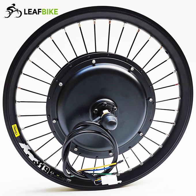

I’m back to planning an ebike build for my wife. I’m not sure whether she’ll like it or will stick to it, but I’m also building it with the possibility that I may ride it if she loses interest; so easy to modify for higher performance later. So far I’m set on 60v and 20” rear hub, on a 24” Specialized Hot Rock frame, with front and rear hydraulic brakes (to help with arthritis) and have been scoping out Craigslist.
My question is, is the 2000W 60v motor sold by Leaf the same as the 1500W? I noticed that the performance graph they use in the description is for the 1500w motor. I’ve been assuming that for modeling in the Grin simulator, for the (wife’s) low power mode (20A) and a high power mode (60A) adjusting kv for a 4T wind, but want to make sure that’s a safe assumption.
I’m too lazy to lace, so I plan on ordering the 20” wide rim, and likely run one thing like Super Moto X tires.
I'd like to know if there is a difference between the 2000w 60v motor and the 1,500w/52v motor as well.
My guess is they are identical but I have not verified it.

I asked Leaf if there was any physical difference between the 48/52v 1500w motor and the 60v 2000w motor and their answer is below. "A. is the 2000w motor and B. is the 1500w motor.
A:can work 48v or 52V or 60V
B:recommend work with 48v or 52v battery.Had better not work with 60v battery
Based on everything I can find, I'd say they are the same exact motor with the only variable being the Kv (winding) you choose.
My comments above are regarding the 1500w and 2000w motors that fit in 135mm dropouts. Leaf offers a wider (170mm and 190mm OLD) 2000w motor that may have a different stator.
Well, that response is about as clear as mud and sounds like it's based on the winding, not the design..
The real question to ask is how wide is that stator.
The 1500w motor is worthy of a 2000w or higher rating in a smaller wheel. I think the 1500w motor is closer to 1750W rated in a 26" wheel.

Some early data from a Leaf "1500W" ordered in early April, 2024:
Config: 35H, "4T," prelaced into an 80mm 406 rim, 170mm dropout fitment, cassette option
Mass: 10.74kg (with spokes, rim, 60cm motor cable, preterminated with ring lugs and a rectangular Hall connector)
Axle: 225mm length, 85mm CL-to-shoulder on both sides, M14-2.0 threads on cassette side, M16-2.0 threads on the brake disc/cable side
Phase wiring: consistent with 4mm² cross sectional area
Ls, LCR bridge @10kHz, 1Vrms: 81µH (with ~60cm phase wiring)
Ls, Baserunner, 50.0V bench supply: 83µH (with ~60cm phase wiring)
Rs, 10Adc @ 23°C: 43.5mΩ (with ~60cm phase wiring)
Rs, Baserunner, 50.0V bench supply : 47mΩ (with ~60cm phase wiring)
KV, 50.0V supply on homebuilt trap controller: 12.5rpm/V
KV, Baserunner, 50.0V bench supply: 12.27rpm/V
There was a white wire in the wiring harness, but I haven't cracked open the motor yet to mod it; not connected to anything on the controller side.
I put a 100-406 tire on it, measured diameter 564mm (~22.2") after calibrating against GPS speed.
I cut off the stock connectors, and reterminated it to a Cusmade L1019 connector to Grin pinout. With a Grin Baserunner L10 at 30A batt/1500W batt/60A phase powering it, I threw it in a Juiced Hyperscorpion chassis, and took it out on a ~110mile ride to Redwood Regional near Oakland for a gathering:
Battery pack was a 14s25p Samsung 35E(1) pack, about 4 years of calendar age. Drew 3577Wh total, with a finishing OCV of 47.8V. Speed was a mix, but mostly at a ~40kph/25mph limit.
Overall: What a beast of a motor! Since I hadn't had time to Statorade it and mount a VESC variant to it, just threw the Baserunner on as a known-good solution. I was wishing for more torque off the line on some of the hills >8%, where I had to really stomp on the pedals to get the bike going, but once in motion, the motor performed pretty nicely for my taste. Definitely interested in seeing what it's capable of in this chassis with a thermistor and something like ~100A of peak phase current.

Leaf bike told me the 1500 watt 35mm comes with 3mm phase wires and the 42mm comes with 5mm phase wires.
3mm phase wires is also confirmed in some leaf bike listings such as this one:
I wonder if this is an upgrade motor of some type?
Reasons:
- 4mm phase wires rather than 3mm phase wires.
- Kv of 12.27 rather than Kv of 13.12 because of stronger magnets?
-16mm axle diameter on brake side rather than the 14mm of a regular 1500w 35mm hub.
-54mm distance from outside of spoke flange to outside of spoke flange vs. 40mm distance from outside of spoke flange to outside of spoke flange.
