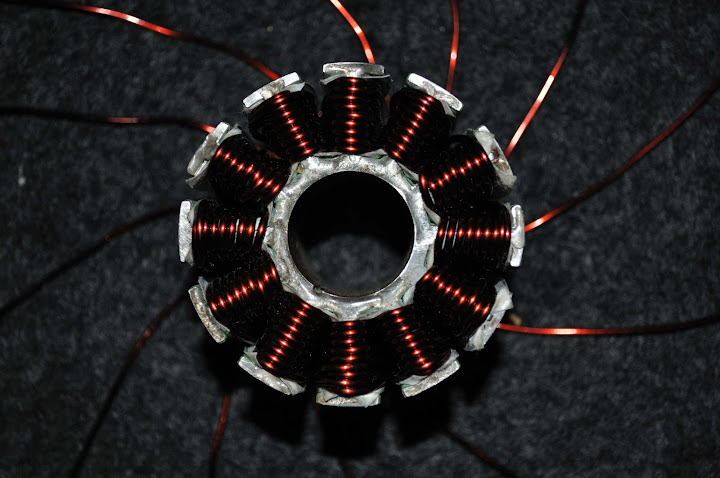

re-winding plan:
I was going to do this on another motor I have laying here but what the heck....AJ wanted twin motors for this cruzer some day, why not give hime the option & save the hassle of mounting another motor? Just add another controller.
Acording to the Drive Calculator, I can wind this motor in a standard 6 tooth LRK & = the resitance values of the original motor configuration, with an 20% increase in copper fill....(remeber how you were pulling 200+amps launching this thing Kim? this is A DUPLICATE of that motor) this leaves 6 teeth on the stator open to wind a parallel set of coils to be isolated & run witha 2nd contoller.
That gets us back to a motor that is double+ the copper of the original & in theory, the shared controllers should be under less stress...Just say the word AJ & we will make this a double motor...or if that is not an option ATM we can leave the 2nd set out & not bother till your ready for that level of expermentation.
whadya say?

Hi Thud!
Damn you are good at squeezing in alot windings to that stator!
You shouldn't get encouraged, I have got good performance from that motor and you could probably even get more out of it!
I recently rewound the same motor in Paralell Y. I´m very pleased with the results, pulling 180A peak and alot of riding around 100A, the motor only gets warm to the hand. It's wound with 9 turns, 1 strand 1,6 mm (1,68 with insulation). KV = 128 and total R = 19 mΩ. At 6500 rpm I got a no load current of 5,5A with standard bearings (including skirt bearing).
The paralell Y is good because it´s minimize the wire length that is not producing torque and you can run the motor with 2 controllers. In that case each controller will see twice the resistance compared with use of one controller.
I'm running the motor at 44V with one Lyen 12 fet controller the only thing I have done is adding 2 more shunts and beefing up the traces. The controller gets barely warm.
What I have learned from winding that stator with thick wire is to measure with volt meter very often, I did get shortings a couple of times. I had to grind the edges of and put insolation paper that wrapped around the edges otherwise I got shortings very easily.

You wound 9 turns on each tooth? (that is an easy fit with 1.6 8) ) in RC motor terms I would call that: 18 turn DLRK....if you terminated as your diagram shows. Also you terminated in WYE. & you are still seeing 129 for Kv?
As an non-schooled motor builder I haven't really concerned myself with the finite analysis of the end results...my philosophy has always been---wrap as much of the biggest wire you can get onto the damm thing!...
I am now building motors that are capable of drawing way more current than my controllers can deliver....so its time to get a little more conservative. & trust the math, or learn about in-line inductors to be able to controll some ridiculasly low resistance motors reliably...my head is getting bigger but the more I learn the more I realize how much I don't know. (prolly fill a book! :lol: )

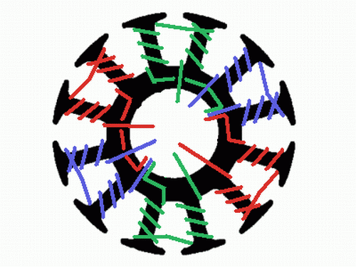

I was really proud of my 9 turns of 1.6 mm wire, until I found this thread..... :oops:
Is my winding scheme really dLRK?
It is two separate engines teminated in WYE with distribution over two teeth. The maths behind the KV compared to delta dLRK is 2/1,73=1,156, so it´s only 15% faster than Delta. 2 because it's half the turns in series and1,73 for the delta/WYE conversion. My motor with standard 8 turn and KV=130 would get a KV=130 * 1,156 = 150 rpm/V. So to get the same KV I would need to add 15,6% more turns, 8 * 1,156 = 9,248 turns. Here comes the scary part, I have 9,25 turns on each tooth if I count with the connecting wire between the distributed teeth's and gets a KV=129 (measured today).
Feels uncomfterable to get this kind of accuracy.... :mrgreen:
Ohhh, what a nice and shiny Marine...
/Goethe
Yeah, it is still dLRK even though you wound it with two sections. It should be twice the KV if you are running each group in parallel with the other side, as compared to a typical dLRK where Aa would be in series with the opposing aA.
Ok thanks John!
Could you explain what it is in my winding scheme that makes it a dLRK?
Yes I have been calculating with twice the KV. (2*130)/1,73= 150, 150/1,156= 130.
/Goethe
12 slot 14 magnet winding AabBCcaABbcC is dLRK. Splitting the coils in half doesn't change this, although we could name it something fancy if you wanted.
I guess a more complete explanation might be called for. (This is my understanding, so feel free to correct me if I am wrong)
LRK is really just an easy way of winding a motor that has 6 stator teeth for every 7 magnets (it also works for motors with 6 teeth per 5 magnets). Basically their idea was that you just need to wind every second tooth with one coil that fills up the slots on either side of the tooth rather than winding every tooth so that each coil takes up 1/2 of the slots next to it. Doing this was faster, but there are issues with it. Number 1, it makes the waveform sharper than it would be, number 2, it is difficult to get a really good copper fill using regular winding techniques because the copper sort of blocks off the slot as you get it full and as you layer on the copper it tends to make a bee-hive type shape which becomes difficult to keep the wire where you want it, and Number 3, the thickness of the copper at the end of stator is 2x as thick because you have the same number of turns, but they all go around the same tooth, so you end up needing more space for the copper.
What is commonly referred to as DLRK in the RC groups really shouldn't be called that, it is really just the standard way of winding a stator with teeth:pole ratios of 6:7 or 6:5. Each pair of teeth is wound in different directions with the same wire.
