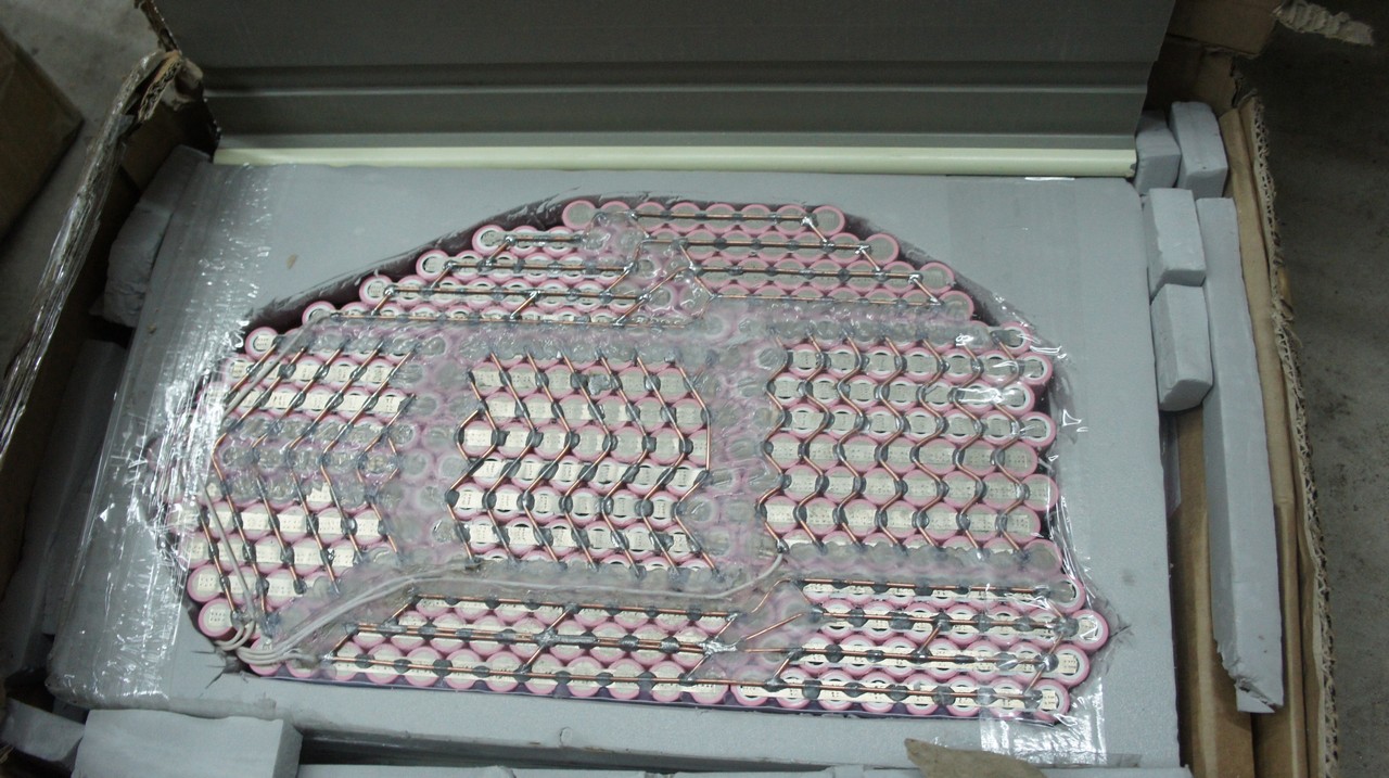

From everything I have read Artur has done an excellent job as a vendor and provided substantial support, it is not clear what precisely caused the fire - but aside from that this pictured battery could be improved dramatically. I suggest reading this thread: https://endless-sphere.com/forums/viewtopic.php?f=14&t=84412
Key things I can see,
There are only two connections between the paralleled groups, for a pack this size this is dramatically undersized
The primary connections to the pack are effectively connected with only a single nickel strip
There doesn't appear to be any physical isolation between the parallel groups, especially in this square layout there's lots of opportunity for point loading and rubbing through the stock shrink sleeve leading to a short. This could be as little as a layer of Kapton tape like you've used on the top of the pack
My personal rule of thumb is 1.5mm2 of nickel per high current 18650, more if possible. The design above is more like 0.27mm2. This will definitely get hot under constant discharge.
