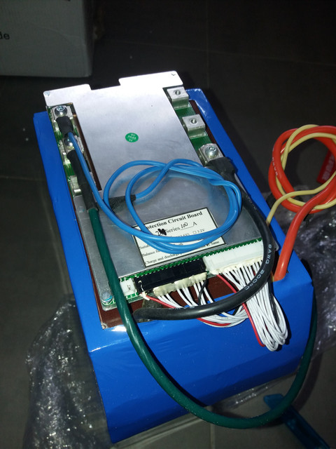

Okay cool, received the battery I ordered from Artur, 24s15p w/bms. Panasonic 18650PF cells
The outside box was pretty warped, I'm surprise it didn't come a part, but the other box and packaging with the battery inside was well protected.

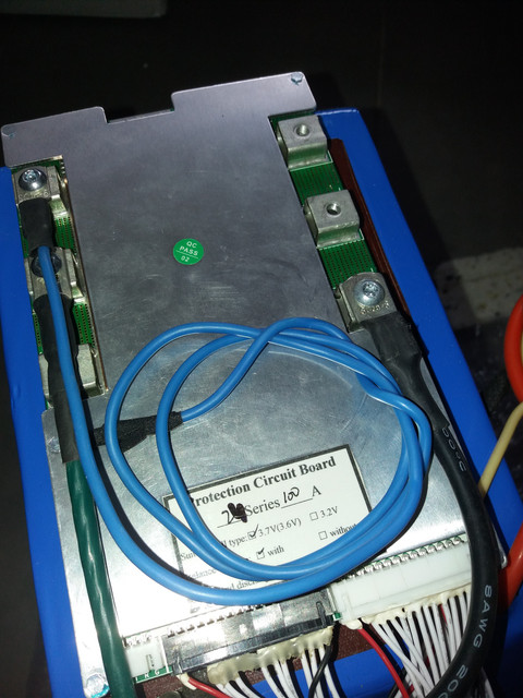

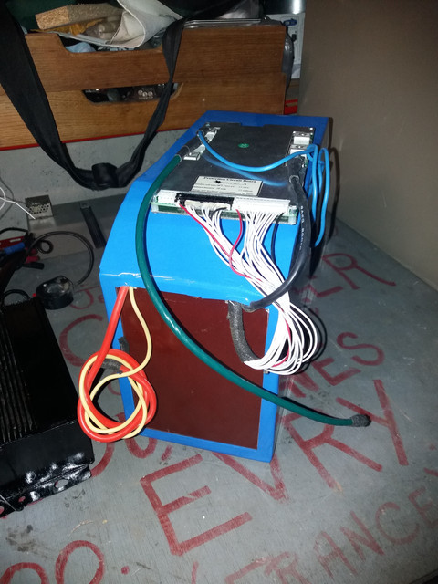

I have a few questions. Its been since I have dealt with a bms.
I assume the large green wire coming from the bms is the negative and that the large red coming from battery is positive.
What is the blue wire coming from the bms and the yellow wire coming from the battery?
Also, do I need a pre-charge wire with a resistor for this battery, so I don't get a pop/flash when connecting to the controller? Currently on my lipo battery pack for another bike I do, but then again I don't have a bms.
I'm tight space in the Vector Typhoon frame, would it be alright to a fix this bms to the side of that battery pack or would that be a bad idea because of heat?
If anyone could help that would be much appreciated.
Artur said:
you can mount it on a side. about wire colors i wrote yo email already. I recommend to use short cirquit switch to turn on off power to avoid a spark. glad that 3 layers of protecktion did a job!
So, its okay to mount the bms on the side of the battery, good to know. There just isn't enough room in that frame for that battery. Thank god for the wide side covers.

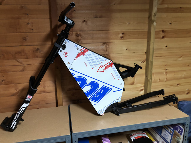

Any information on the RCP2 850 lbs 220mm rear shock I ordered from you? That is the only piece i'm missing for this build.
Yes, very good idea to triple up on the layers for packaging these batteries.
Thanks for the email earlier.
I still think it's weird that it's presumably okay that the bolts can move vertically(makes a loud knocking sound when lifting bike) in the holes if they're not super tight.
On my previous bike(a full suspension XC bike), I couldn't move the shock bolts vertically even when they were completely loose.

What is the size of the new bolts ? Are they 8mm? Because my shock mounts have two different sizes(as I have explained in emails to Vector) so, I'm sure that getting new bolts won't get rid of the play in the upper shock mount. (I have tried unthreaded bolts, and still have play.) Upper shock mount is 8.2 mm.
I just checked my XC frame and even with the bolts completely loose there is no play in any of the shock mounts.
And that is a cheap "no-brand" frame, however it's made in Taiwan, not in red China.
Is it impossible to make a upper shock mount that is exactly 8mm?

I got the new shock mount and the unthreaded bolts from Vector,
and this time the bolt hole was small enough, so there's no play anymore.
First ride with new shock mount:
