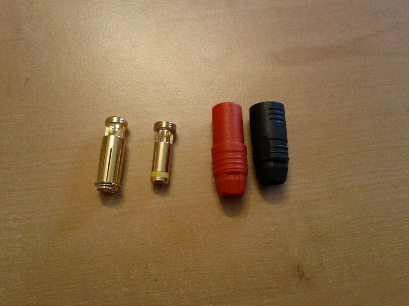

i never tested the antispark function before on these connectors, because i have a precharge circuit with keyswitch. yesterday i did a test which was very dissapointing:
pack 85V. controller has about 3000µF capacitance. while plug them together there was a little spark on tip of the bullet. ok no big problem. i put them complete together and everything worked well (no more sparking).
I did a second test and ohh.. no little sparking on the tip. something wrong?? when put them complete togehter it sparks that much my connecors almost melt tegether!!
measured the resistor: it was dead
I hope the caps in controller are not hurt - what do you think? Are they got weakened?
took the resistor out of the bullet:
dead and broken. it also seems to be very fragile mechanically.
Don't use these cheap crap AS150 connectors for precharge at that high volatages/capacitance, or better don't even buy them! 5 Ohm is much to low!
better go with Jeti 5,5mm (36 Ohm) or Jeti 8mm (30 Ohm) for higher current. Theire smd resistors should withstand precharge well at higher volts and even don't get warm.
