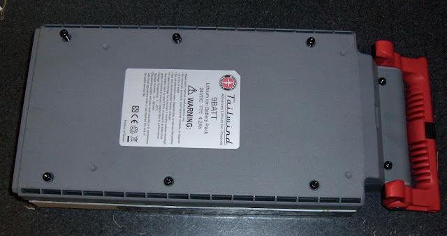

Getting to the BMS
To bypass the BMS, first, you must reach the BMS. This bit of wisdom was received from a sage on top of a mountain, though why a desert plant felt the need to tell me this, I'll never be quite sure.
The first step is to remove the 8 screws (6 Torx T20, two phillips) from the bottom of the case and remove the lower case.

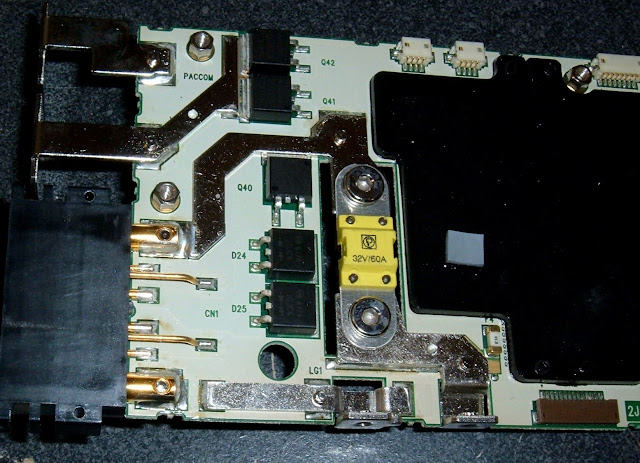

With the metal plate clear, you can see the business side of the BMS. There's some serious current carrying capability here - but I'm about to mess with it.
BMS Layout
Here's what the problem is. I've annotated the below diagram with lines, red for positive, blue for negative (and also, there's a common ground plane on the board so the negative lines are connected to each other - I've got 99 problems, but a split ground plane isn't one of them).
Without the BMS happy and functioning, there are three different positive islands that are causing my problems, because the two I care about (charging and discharging) are not connected to the third, which is the battery pack.
The two connections in the top left of the picture are the output connectors. They press against the spring loaded contacts in the bike mounting bracket, and transfer power to the bike. If they've got about 24v on them (plus or minus a good bit), the bike works. If they don't, it doesn't.
The lower charging connector is somewhat interesting (you can see more detail on it below). It's two different charging connectors in one. The outside two pins (the large ones) are for the high amperage charger. The inside pins are for the home charger. And then there are a few other pins that I assume are for diagnostic communication, or communication with the high amperage charger, but I sure can't find any details on them.
In any case, the inner pin that I'm interested in is not connected to anything unless the BMS connects it. Neither is the output. So this is what I need to fix.
Here's a better shot of the connector side of the BMS. The left two plates are the output plates - negative on the left, positive on the right. The righthand charging connector is really interesting. The outer sockets are for the high amperage charger - it's about 40A. The inner socket has two pins, and is for use with the home 8A charger. And I have no idea at all what the four other pins are - possibly contacts for the commercial charger, but that seems delicate. Maybe just for diagnostics. Nobody will tell me a damned thing about these packs, so I'm left to guessing. And doing terrible things to them in the hopes that someone at Toshiba will be horrified enough to tell me what I want to know.
This is the other side of the board. This really is a "belt and suspenders" type board - the bolts go through the board... into where the traces (for some insane value of trace - these things are copper, coated with zinc or tin) are soldered onto the board. I really have no clue what went into this BMS, but I strongly suspect some engineer was very proud of it, figured it could comfortably drive a 50A load (it's got a 60A fuse), and was very sad when told it would drive a 250W bike (so about... 10A). Either that, or someone thought a safety factor of 6 was about right for this. I'd love the story sometime, if anyone happens to know. It's absurdly overbuilt, and I love it! It does make my hacking a bit harder, though...

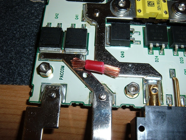

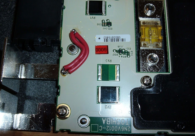

Something that actually works
After some experimentation, I finally came up with something that works. I removed some of the unneeded bolts, and created a jumper between the charging port and the output port. It's still difficult to solder, but I was able to make it work. I went with two wires on the output side for somewhat increased current carrying capacity. This is a low power bike, so I'm not carrying many amps. I'd prefer to have done something more robust, but this is the best I could do with the tools available to me.
For the charging side, it was a lot easier. I was able to solder a single jumper wire and get it hooked up nicely. This should handle the charging current from the home charger just fine - especially since the pack charges up quickly and stops soaking as much current.
If you're doing this, of course use the largest wires you have available. This is a proof of concept.

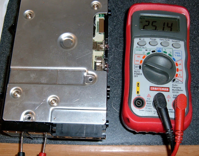

Does it work? Yup!
The pack voltage is available on the outputs, and the charger works! Excellent!
