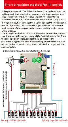

I am now attaching an image with the connections that must be made according to the BMS manufacturer.

I think my questions lie in:
- Would I have problems if I charge or discharge the batteries with the connection scheme proposed by the BMS?
- Would it hold up to the charge and discharge current levels (BMS is 100A, applied current <20A)?
- If at any time the battery voltage reaches a lower or higher value and the protections are activated, would the BMS cut off the entire circuit?
Per the diagram, that is what they call a "common port" BMS, meaning boht C- and P- are the same point; the FETs the BMS uses to switch the pack's external connection on/off are all wired to that point (normally in series).
This means that as long as the BMS has turned on both charge and discharge functions (no limits engaged), the FETs are all on, and it's essentially a low-resistance switch.
If for any reason the BMS turns one of the functions off but not the other, then the one that is off doesn't act as a switch, it acts as a diode, blocking the current path that it's for, and allowing the other current path *but* with a voltage drop across it that causes significant heating at high enough currents. Not typically something you have to worry about when using them within their limits, but that's how they would function in that event.
(sometimes a smart BMS that uses a common port will lock up or enter some fault condition that turns off BOTH directions, and then you can't recharge it or discharge it to correct an excursion beyond LVC or HVC until the BMS is reset. That reset function varies between designs, so you'd have to check the documentation (if any) for what to do if it ever enters this "stuck" condition. )
In a separate-port BMS, with separate C- and P- connections, the FETs are wired separately, so don't affect each other's current paths regardless of conditions.
If your usage is well within the limits of the device, then there's no typical reason to expect a failure.
If it's a poorly designed device (PCB layout/etc issues), or uses problematic parts (counterfeit, lower-spec'd than called out, etc), then it could fail even in "normal" usage--but this is unlikely at a rate that much lower than the limits.
That's what should happen, yes. It will turn off the FETs that allow current to pass thru the C- connection in the direction of the function the limt is for.
So if it hits HVC while charging, it would turn off the charge FETs.
So if it hits LVC while discharging, it would turn off the discharge FETs.
