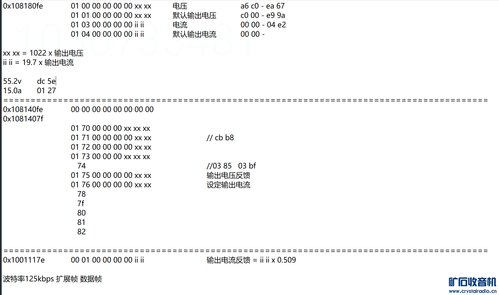

Re: Rectifier Huawei R4850G2 48V 42~58V 3000w
Just dropping by some info:
Also interesting: https://www.yleee.com.cn/thread-62600-1-1.html
I don't have one of these PSUs to test this, but I want to buy one if I can use it to charge my 14S battery with it.
Edit, Jackpot:
OCR:
If you Google 0x108180fe you can find the source.0x108180fe 01 00 00 00 00 00 xx xx 电压 a6 c0 - ea 67 01 03 00 00 00 00 xx xx 电流 00 00 - 04 e2 波特率125k 扩展帧 数据帧
Edit, Jackpot:
OCR:
Code: Select all
0x108180fe 01 00 00 00 00 00 xx xx 电压 a6c0 - ea67
01 01 00 00 00 00 xx xx 默认输出电压 c000 - e99a
01 03 00 00 00 00 ii ii 电流 0000 - 04e2
01 04 00 00 00 00 ii ii 默认输出电流 0000 -
xx xx = 1022 x 输出电压
ii ii = 197 x 输出电流
55.2V = dc 5e
15.0A = 01 27
0x108140fe 00 00 00 00 00 00 00 00
0x1081407f
01 70 00 00 00 xx xx xx
01 71 00 00 00 00 xx xx // cb b8
01 72 00 00 00 00 xx xx
01 73 00 00 00 xx xx xx
74 // 03 85 03 bf
01 75 00 00 00 00 xx xx 输出电压反馈
01 76 00 00 00 00 xx xx 设定输出电流
78
7f
80
81
82
0x1001117e 00 01 00 00 00 00 ii ii 输出电流反馈 = ii ii x 0.509
波特率125kbps扩展帧数据帧
All the CAN info you need is in this post: viewtopic.php?f=14&t=86038#p1427144
Use google translate on the OCRd chinese text (I don't speak chinese myself either, used google translate too).
That's the CAN IDs and messages you have to send to adjust the [default] voltage/current.
All you need is a microcontroller/dongle that can do CAN and maybe a CAN transceiver chip.
I doubt the chinese guy will give away his source code, I've read some forum posts of his and he didn't want to share any information for free.
As said before I'll be using an ESP32 + TJA1051 to control mine and will make the code open source, could take a few weeks however.
I do have a TI Tiva-C here too and a CAN transceiver chip in a broken device, so I might experiment with that too when I get my PSU.
I only need 10A for charging my 14S10P pack, even less for the others, so 2000W is overkill for me anyways
But it's cheaper, smaller and lighter than a 500W Mean Well HLG and programmable for a higher voltage range, should be really silent too on small loads.
