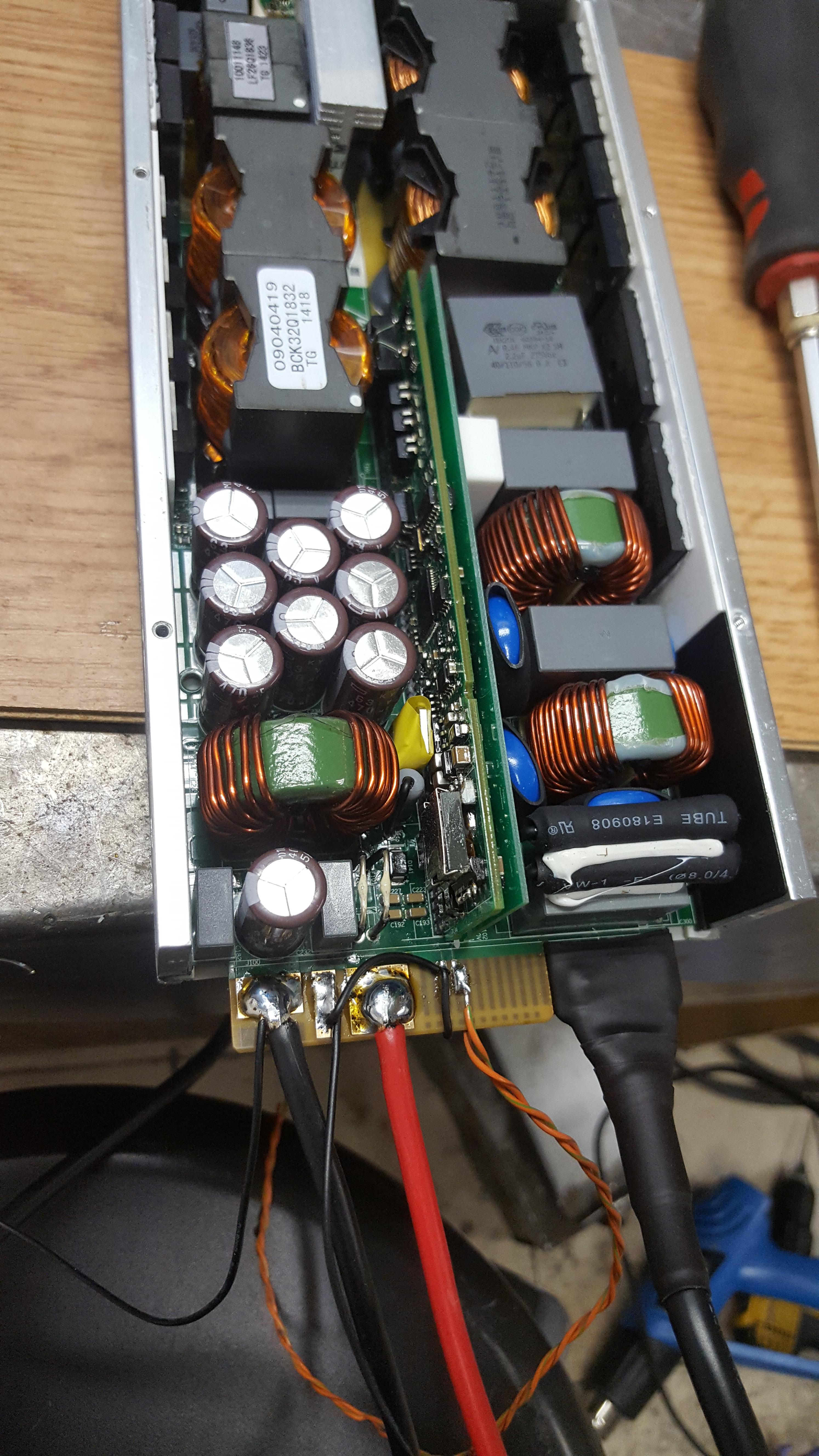

Added info parsing, bluetooth and wifi serial:
https://github.com/BotoX/huawei-r48xx-esp32/commit/f2741078a123bfcc90fcd496486d9cd2b6373a87
Code:
Input Voltage: 226.06 V ~ 50.43 Hz
Input Current: 2.45 A
Input Power: 554.77 W
Input Temperature: 22.00 °C
PSU Efficiency: 95.21 %
Output Voltage: 51.54 V
Output Current: 10.12 A / 10.00 A
Output Power: 528.22 W
Output Temperature: 35.00 °C
Efficiency is shit at low power, transistors on the low voltage side get really hot ???
Code:
Input Voltage: 225.94 V ~ 50.43 Hz
Input Current: 1.31 A
Input Power: 295.10 W
Input Temperature: 24.00 °C
PSU Efficiency: 88.87 %
Output Voltage: 51.11 V
Output Current: 5.08 A / 5.00 A
Output Power: 262.24 W
Output Temperature: 45.00 °C

Really funny how at 10A there is 26.5W loss and at 5A there is 33W loss...
But I guess that info is in the datasheet graph too.
Edit: 6A 94% efficiency, guess it's something hardcoded lol

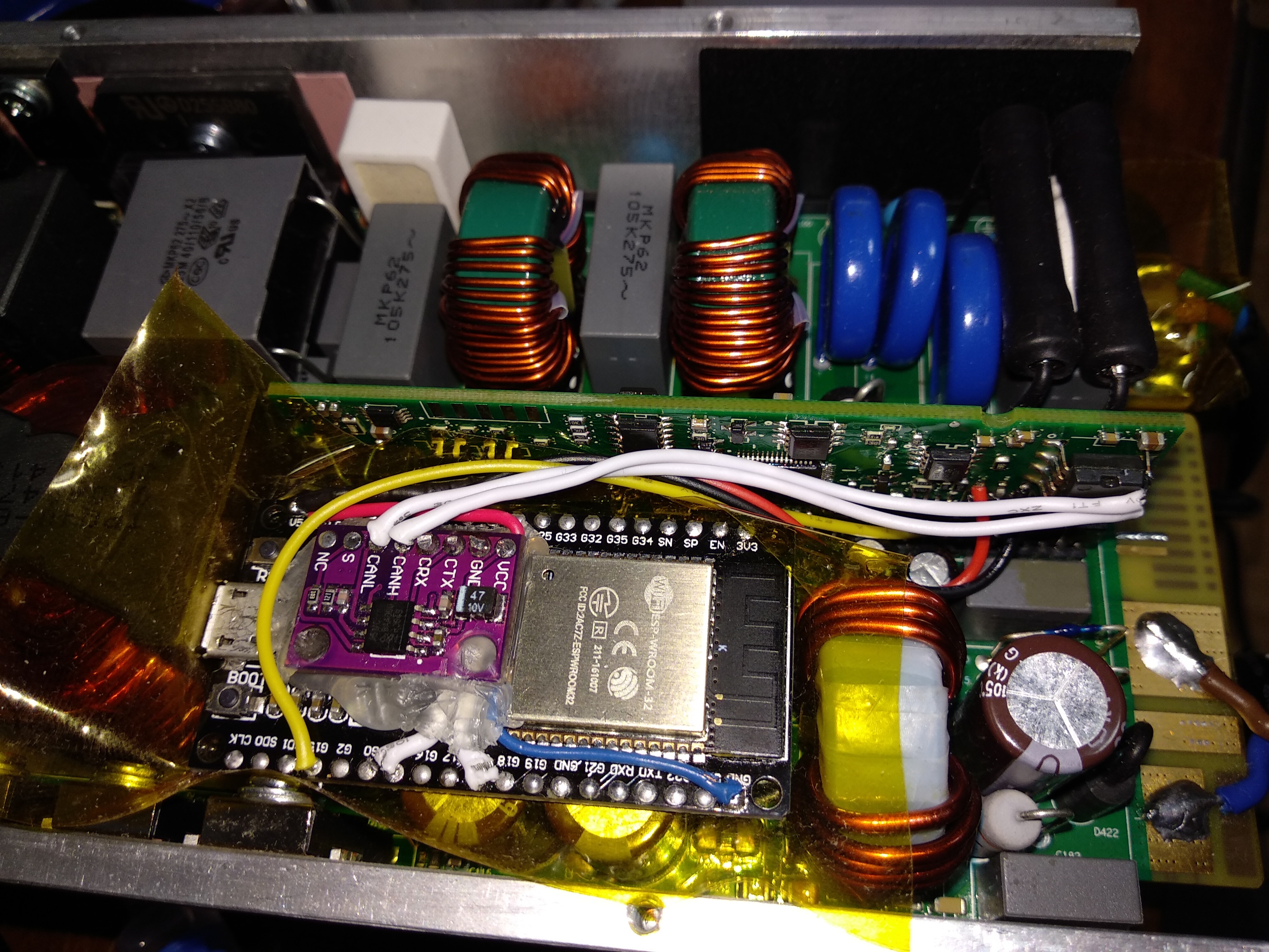

BotoXbz said:
Work in progress still, code on GitHub https://github.com/BotoX/huawei-r48xx-esp32
Using this lib for CAN on ESP32 https://github.com/sandeepmistry/arduino-CAN
I am taking a look at the sources, and appreciate the wonderful programming style!
Let me think, since this is CAN bus the controller really wouldn't have to be in the PSU, but could be - maybe sporting an OLED status display and even a rotary click switch for direct menu control be somewhere in the vehicle cockpit? Or even become part of code in any other MCU connected to that CAN bus? Do you require (other than the supply voltage) access to other signals in the Huawei rectifier?
:bigthumb:
I've put the ESP32 inside of the Huawei so it's self-contained and powered by the PSU.
The WiFi and Bluetooth work with random reliability, sometimes they both excellent.
Sometimes WiFi doesn't work at all but Bluetooth works fine.
And sometimes you have to get really close and wait a little longer for only Bluetooth to work.
You can put OLEDs and switches and whatnot, but I'm lazy and don't have to adjust it often, so bluetooth is fine.
And WiFi comes for free too so I can watch my battery charging on my pc with telnet lol.
The CAN pins are exposed outside too, see the other posts/images in this thread.
You can put multiple PSUs on the same CAN bus too and control them individually (with changes to the code).
You don't need anything else other than CAN bus.
However I was hoping that I could put the PSU into sleep mode and keep it plugged in at all times by turning off the output with that one wire. Turns out it uses way too much power in idle by doing that, real sleep mode is probably triggered with a CAN command that I don't know.
Here's some more code for the huawei psu communication: https://github.com/huyugit/om-miner/tree/master/sm-miner-slave/src/psu
This guy seems to be controlling multiple ones on the same bus.

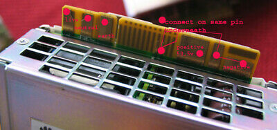

some interesting iformations guys. It can be really hardware modified to 0-120V 0-30A.
https://endless-sphere.com/forums/viewtopic.php?f=14&t=99767
Yes, discussed above, have been out of stock for a long time.
Hello
since few days I am happy owner of 3pcs R4850.
Today after few long hours I managed to change the output voltage, thanks to the information provided by BotoXbz
