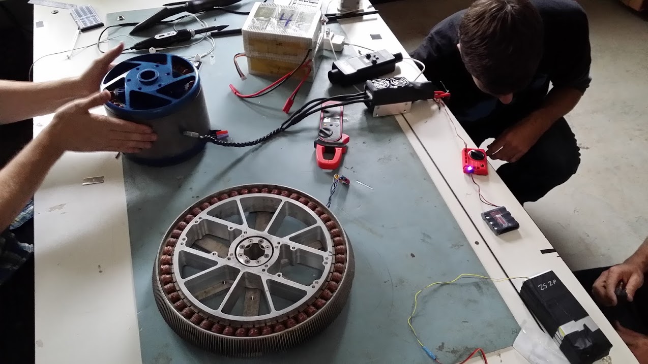

Later in this thread a member gets a 420A controller after volunteering to make a proper test of it. The test has not been done yet. So if you read through the entire thread expecting to find the results of the test, there is a good chance that you will become frustrated, disappointed and start expressing that in different ways, which is what the later half of this thread currently contains.
Pictures of some hardware to be used during the test, and a discussion of how the test should be performed starts at the post linked below.
http://endless-sphere.com/forums/viewtopic.php?p=700565#p700565
