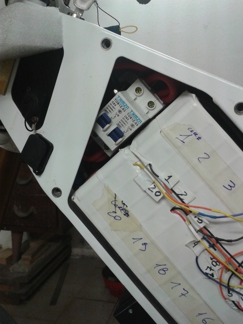

Nice spot welding, this is one half of the pack - 10s@37V nominal:

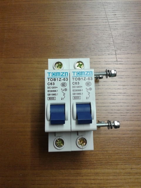

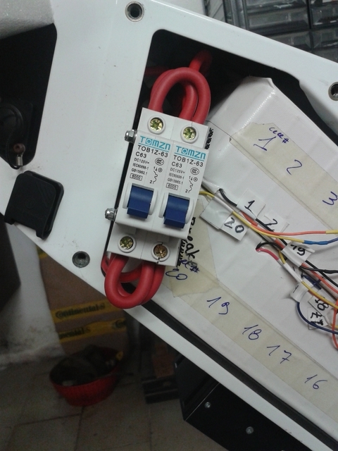

If you want a simple and reliable solution(Adapttos recommendation) just install a regular apartment breaker, I use C63A, it angages at about 135 DC Amps for me and you can use whatever battery voltage.
And you can say goodbye to all prechargers, no need them anymore!
http://www.abb.com/product/seitp329/49a79353b0194401c12572ab00257544.aspx?tabKey=2&gid=ABB2CDS251001R0634&cid=9AAC100489
