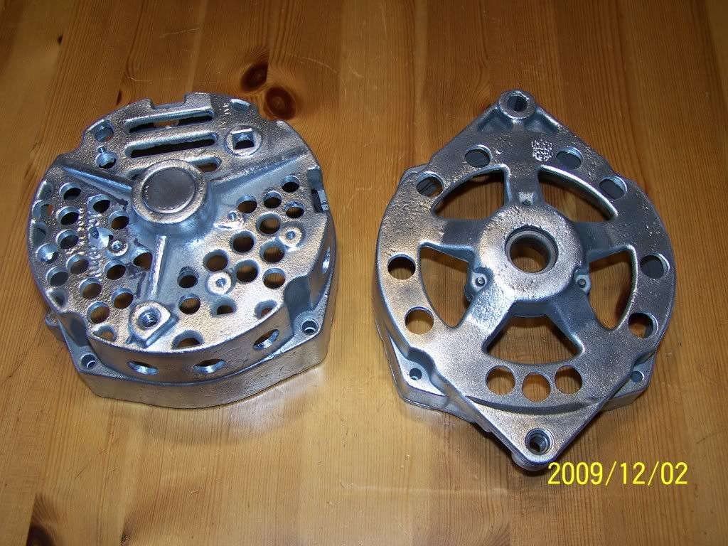

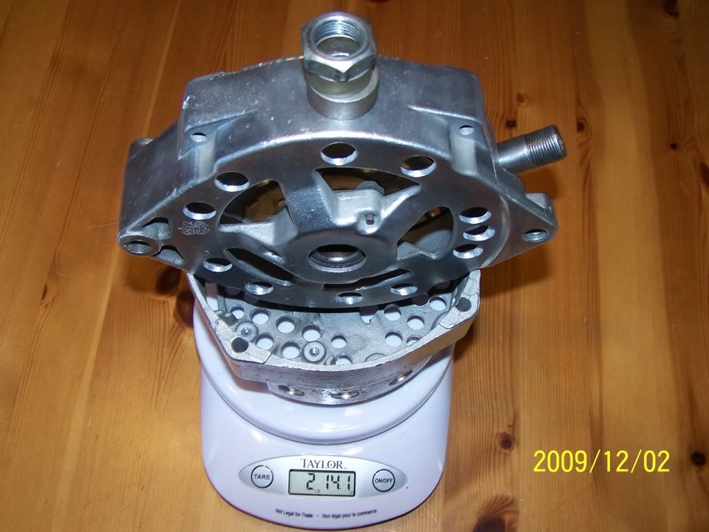

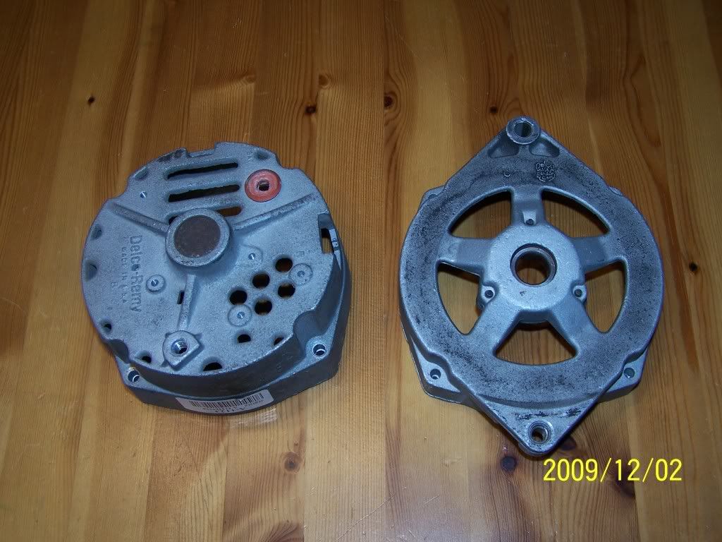

Barring any problems i have found most of the things i need to get this done . the magnets get here in the mornin (shipping weight of 1.7 pounds) and i intend to put around 1-2 pounds of copper in it still. no steel , fibreglass structure for the windings.
ill have shots of the rotor in the mornin. just working on dressing it up a bit :) . may get lighter as im waffling on some things but i figure i can always get the drill out again and put more speed holes in the case if i need to make a weight requirement. lol

I have been looking at weight reduction all day to better atack the parameters Miles laid out. I am curious how the alternator conversions compair to the other motor options.
