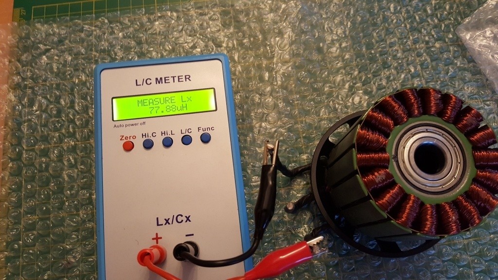

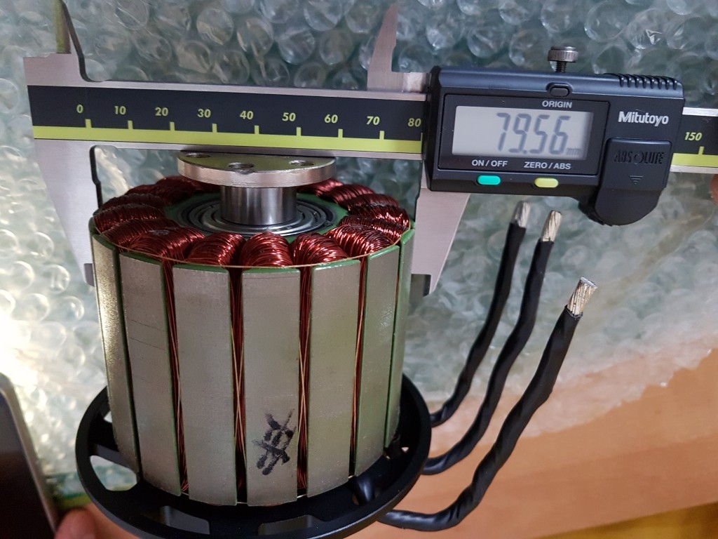

I would like to convert my Votec bike, which is currently powered by an MXUS 3k hub, to a middrive.
The main reason i want to give away the hub is the poor handling at uneven roads. The whole bike is shaking like hell if the road is bumpy and uneven. There are no issues with the fork or the damper, the only thing which might be not optimal in terms of suspension physics is the low weight of the frame.
It is about 25kg (frame with all parts + battery) fighting against 13-14kg of unsprung mass (motor + rear wheel). Aside from my personal experience this is also in theory anything but optimal.
When i am driving over potholes it comes through quite hard and rough, and the quick road irregularities are not filtered well. the wheel simply cannot follow the surface quick which leads to a very uncomfortable ride than.
My plan is to install the motor on a bracket which will be welded to the swingarm. The problem is there is limited space, so motors like the BigBlock's won't fit, and because i do not like to power it over the chainring on the pedals, units like BBSHD or Lightningrods are no option.
I am thinking of going with a belt drive with about 7:1 reduction (or a bit more even). Belt drive because of the possibility for regen :)
If the diameter of the motor is below 110mm, it should fit without touching the frame if the damper is full compressed, so i started to search for such motors.

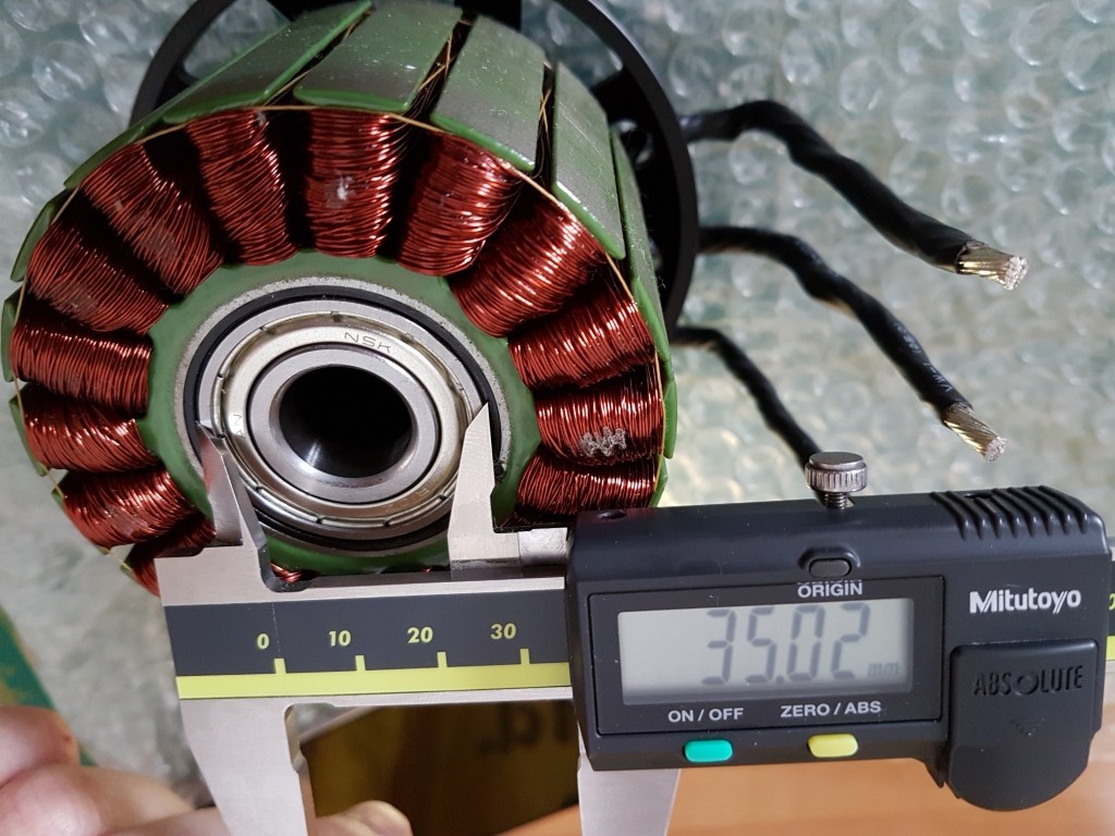

It is a 16P motor and somewhere stands "18S16p" so i think it has 18 teeth (but not confirmed).
as the name says the size is 80mm dia x 57mm wide with a kV of 75 (optimal for my 20s battery).
the rpm range is 4000-8000
other specs:
Case Length 92mm
Diameter 99mm
Weight 2660g
Stator diameter 80mm
Stator length 57mm
Shaft Diameter 14mm
Mounting 6x 56xM6mm
Kv 75U/V
Internal Resistance: 24mOhm
Idle Current: 1.6A @ 10V
Limit (15s): 20'000W
poles: 16 (8 pairs)
At the moment the price is 399USD for the motor and about 60USD for the necessary front mount axle:
http://www.leomotion.com/shop/USER_ARTIKEL_HANDLING_AUFRUF.php?Kategorie_ID=1157&Ziel_ID=8566
the 8057 is on the far right:
things to find out for the NeuMotor:
- how is the cogging of 18S16p design (or torque ripple?)?
- would it be possible to install hall sensors?

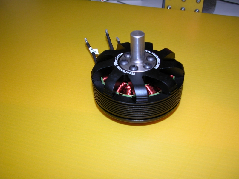

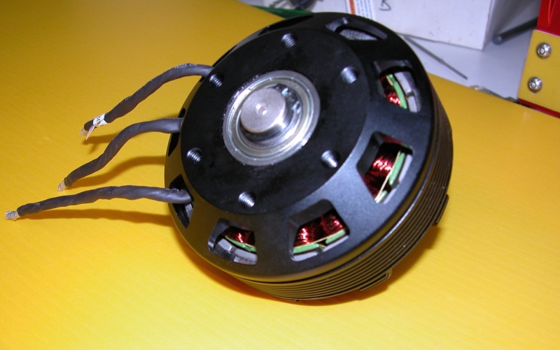

more pics:

Things like back-EMF waveform or inductance are also important to know for choosing the optimal controller.
the 16pole design would require "only" 64000 ERPM for maximum specified RPM which is a big advantage compared to other large RC motors.
I don't own the motor yet, but i don't see a problem adding halls if they can be installed between the teeth. Need to find out if they can.
I asked Leomotion (NeuMotor dealer) about the coggin and motor data.
here ya go:
the data is "calculated", whatever that means, but it looks promising.

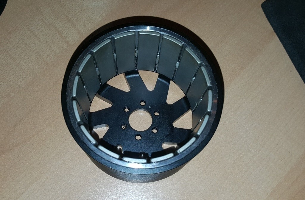

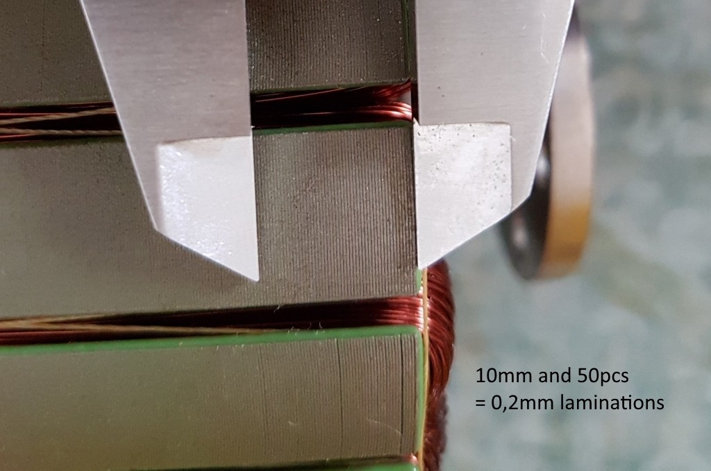

The cogging is quite high they reckon which prevent ma a bit of buying one aside from the missing halls.
This motor should play in a different league than Hobbyking, Alienpower stuff or other china RC motors, and the price is still half of a Hacker Q100 motor.
Also the large 14mm axle with rear mount option makes it a fantastic choice for a mid-drive.

This is no typical RC motor, it was made for industrial usage and last year offered to the RC crowd. The axle and bearings looking super robust to me.

i guess this idea came in your mind because some pics are showing the smallest version of the L80 with 19mm stator width, but this thread is about the large one which has a 3 times wider stator.
When searching the net i could not find much about those motors at all, so i added pics of what i could find.

- I need to figure out first, but if possible i will install the sensors between the stator teeth. Mounting them outside or further away from the coils would be better for signals at really really high magnetic fields (thus phase current's). But furst i want to find out how it works with the usual installation.
- Have askded them. they don't offer this motor with hall sensors.

The motor is there!
It took only 3 days from LA to Austria :)
The quality is on a high level and i have confidence that it will work like a charm as an e-bike drive.
measured values:
23mOhm resistance
78µh inductance (with rotor about 40µH +-5)
0,2mm lams
air gap: 0,8mm
