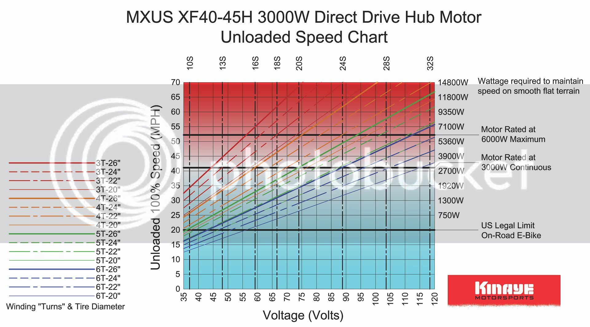

Added from "teslanv"
Here is some more Hard data for the EE folks:
MXUS XF40-45H (3000W) DD Hub motors...
21X3T Winding
Phase resistance = 0.072 Ohms
RPM at 50.2V = 597, 11.89 Kv
1.78A/89.4 Watts No Load
16X4T Winding
Phase resistance = 0.110 Ohms
RPM at 50.2V = 448.2, 8.93 Kv
1.08A/54.2 Watts No Load
12X5T Winding
Phase resistance = 0.163 Ohms
RPM at 50.2V = 359, 7.15 Kv
0.84A/42.2 Watts No Load
10X6T Winding
Phase resistance = 0.225 Ohms
RPM at 50.2V = 299.4, 5.96 Kv
0.64A/32.1 Watts No Load
All bare hub motors weigh in at right around 9.14 Kg.
These are the motors I sent to Justin for Dyno Testing.
No Load Current was measured with my Fluke 77 iii RMS Digital Multimeter, so it should be pretty darn accurate.

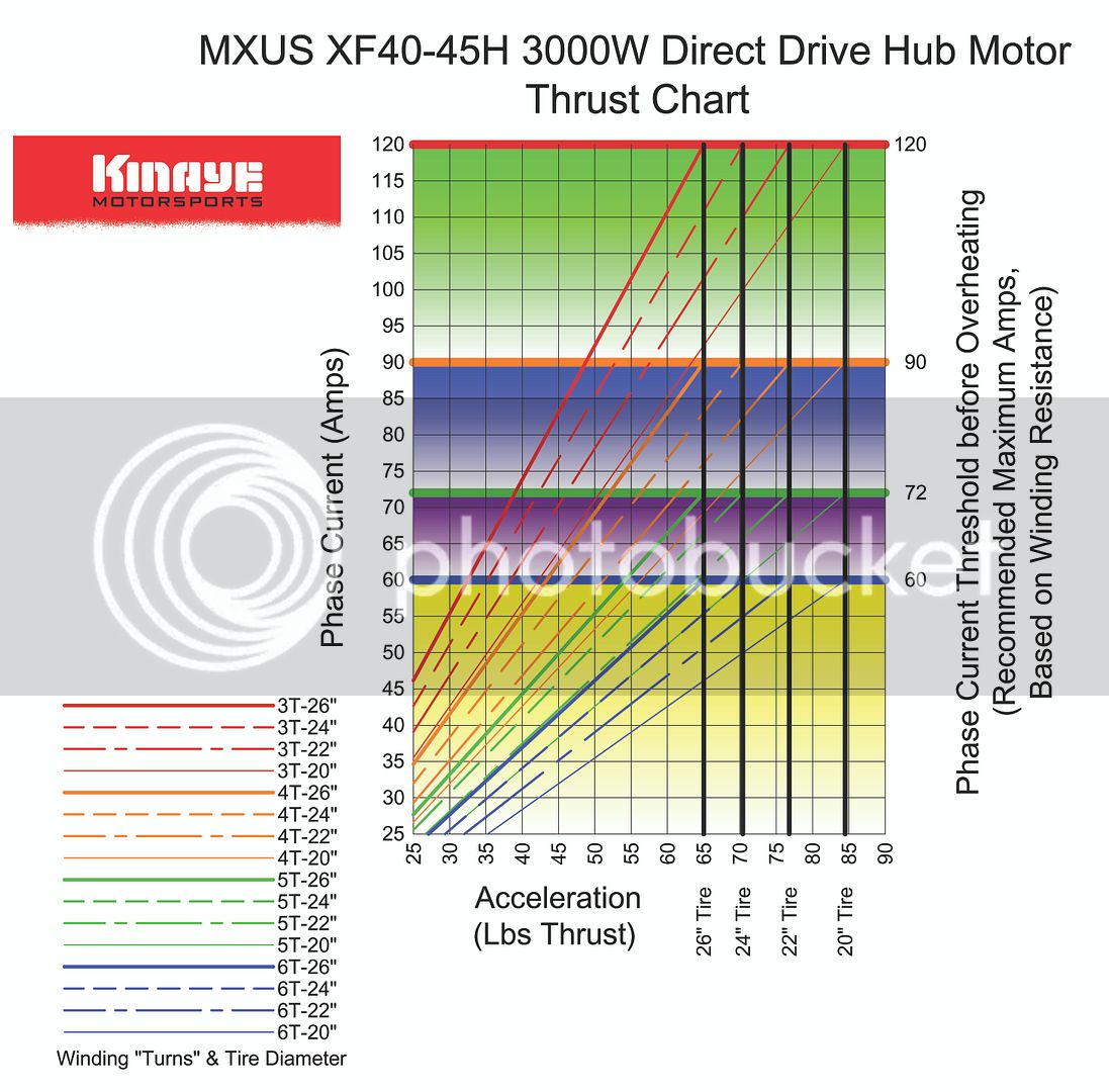

According to Justin's data, Teslanv get the following phase current limits on the various windings:
MXUS XF40-45H "3000W" Direct Drive Hub Motor Series:
3T:
Max. Continuous Phase Current: 55A
Overheat in 10 Minutes: 85A
Overheat in 60 seconds: 242A
4T:
Max. Continuous Phase Current: 42.6A
Overheat in 10 minutes: 66A
Overheat in 60 seconds: 186A
5T:
Max. Continuous Phase Current: 34.9A
Overheat in 10 minutes: 51.6A
Overheat in 60 seconds: 150A
6T:
Max. Continuous Phase Current: 30.3A
Overheat in 10 minutes: 47A
Overheat in 60 seconds: 132A
Generic Winding Phase Current Limits per strand:
Max. Continuous Phase Current: 2.84A per strand
Overheat in 10 minutes: 4.4A per strand
Overheat in 60 seconds: 12.4A per strand
*All data assumes a non-vented hub motor. Venting or other methods of cooling should increase these values.
If these values seem low, just remember that when accelerating from a stop, you might start out at very high phase current, but then in theory phase current would drop as you reach your cruising speed. - As long as your cruising (continuous) phase current is not higher than listed above, you would theoretically never overheat the motor.
And here is the excel spreadsheet teslanv developed so you can calculate and compare unloaded speed and torque, given Motor winding, volts, Phase current and tire size.
  • MXUS 3000W Calculator.xls
