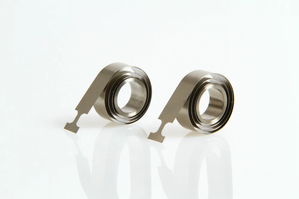

I don't know how to make this clearer -- it isn't about strength -- but I'll have one last try.
The TAs are a supplement to, not a replacement of, the existing dropouts. Their purpose -- as I envisage it -- is to prevent the corners of the axle flats from exerting impactful shear loading on the dropouts.
Given that frame and axle are produced in isolation of each other, there will inevitably be a loose fit between them, with the dropout tending to be oversized and the axle flats undersized, just so that each will fit in the event that the other is "dead-on balls accurate" 10mm.
That 'slop', which might vary from say, 0.1mm to 0.5mm or more, so that the transitions of torque from positive to negative and back again, means that the corners of the axle flats have a (small) distance through which to accelerate before being arrested by the dropout. And it is that acceleration that is the nemesis of dropouts.
Try a little experiment: Take a steel rule (or similar piece of metal), place the edge on a piece of softwood and press it. See how big an indent you can leave. Then lift it off a short way -- a couple of millimeters -- and stab the corner of the rule into the wood. Now imagine performing the same experiment using a torque motor to supply the force.
If there is a 0.5mm overall gap -- that's just -0.005" on each side of the axle and +0.005" on the dropouts -- and a 12mm axle will have 9.204° of rotation in which to accelerate when the torque transitions from negative to positive, or vice versa.
Now the angular acceleration
can be related to the torque that drives it, and given the rotating mass of the motor, its torque and the radius of the flat edge, it would be possible to calculate the effective force that would result; but I hope it is sufficient to say that it will be several times higher than if the same torque was applied with the faces of the dropouts tightly abutted to the flats of the axle.
The idea behind the spring-jaws is that they remove that slop, and so remove the space in which the axle can accelerate before contact.
The idea behind the open C-shape and the slots, is that they provide flex -- they are designed to allow the jaws to expand outwards -- slightly, less than a mm -- providing a resilient but flexible buffer to de-accelerate (actually, prevent it from accelerating) the axle, absorbing (some of) the initial torque, before the edges of the axle flats come into contact with the dropouts.
If I've done my homework, they never will make contact with the dropouts; but even if they do, they will have -- through their inherent spring rate, plus inter-layer friction, plus the friction between the front and back layers and the frame and the flange face of the nut -- so reduced the force with which they make contact, that any danger of the dropout failing -- either instantaneously or through fatigue -- is enormously diminished.
By using a material that is designed to flex, and constraining it so that it requires considerable energy to make it do so, it seeks to provide a shock force absorbing buffer, rather than an immovable object. The key is toughness and resilience over strength or hardness.
