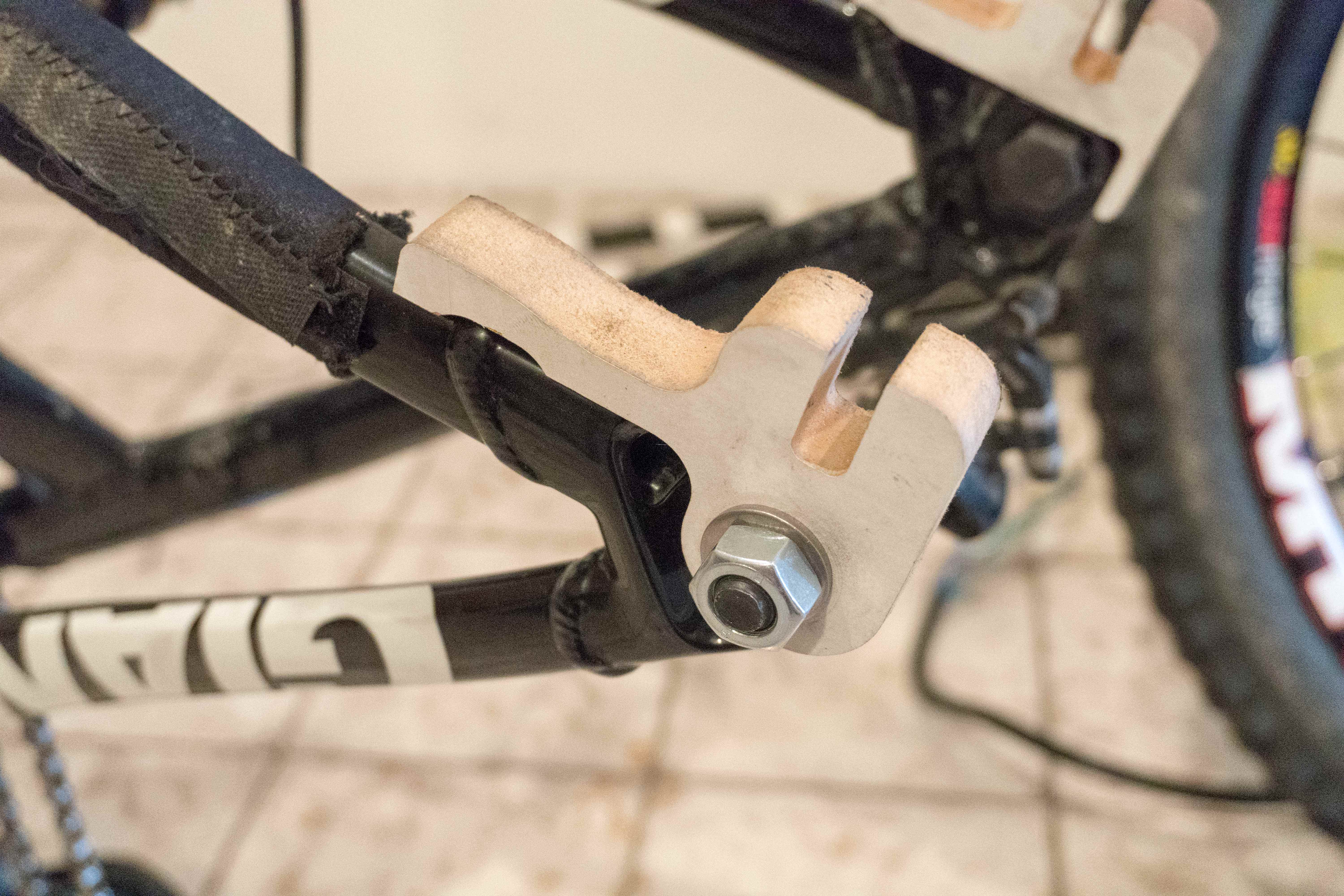

Before mounting the rear motor wheel some modifications had to be made. Because the existing rear hub was "thru axle" I had to machine two mounts the change it to standard 150 mm dropout in which the motor wheel fit. Because the new axis of rotation is now 32 mm off center the disc brake mount had to be modified. The disc brake rotor was also replaced with a bigger one.
Before machining the mount from aluminum I made few test mounts from MDF wood. The mount was spot-on after 3 iterations of trial and error. It was then machined from 20 mm thick 5083 aluminum alloy plate.
All fixtures for batteries and electronics were made to clamp the frame. The motor mounts are also screwed into existing holes and clamped. There was no drilling or any other modification to the frame. The whole conversion was set to be completely reversible without any damage to the frame or bike as a whole. The reason behind that is the cost of a downhill bike.

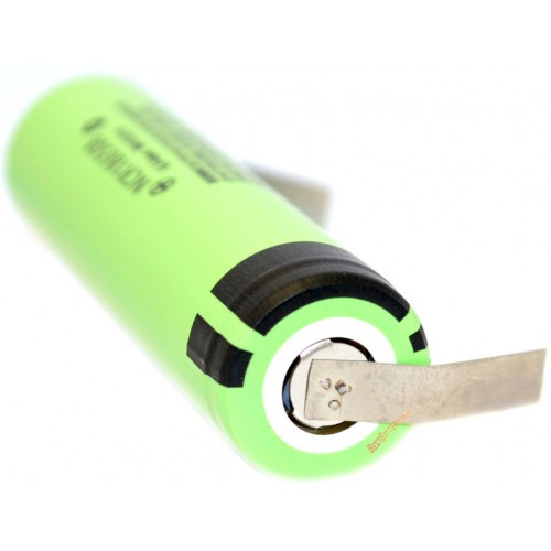

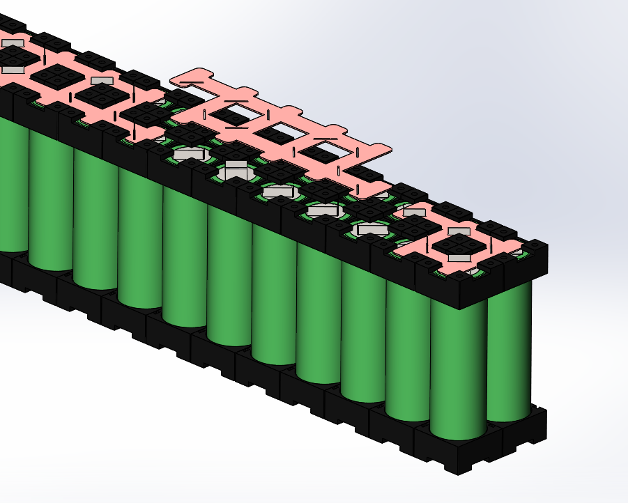

Battery pack consist of 100 18650 cells wired in 20S5P scheme. Individual cells were ordered with solder tags already welded. Laser cut copper parts are be used to connect cells together to form a pack. Each cell is inserted in a plastic frame that is assembled like lego bricks. Solder tags are soldered to copper part for electrical connection.
Pack is split in 3 smaller packs to fit on the frame. Two large parts in configuration 8S5P and one smaller in configuration 4S5P. All packs are connected to a single 80A BMS.
Nominal voltage of the pack is 72V. Cells are rated to deliver 20A continiously which means the pack current capacity is 100A. With 2.5 Ah capacity for each cell the total pack capacity is 12.5 Ah or 900 Wh.
To complete the battery pack 20S 80A BMS is installed. It protects the battery in case of over-discharge, over-charge and over-current. It also balances individual elements wired in series so a simple CC/CV charger can be used.

Would you be willing to sell me a printed bracket?
Noooooo, you can't use 3d printed brackets for motor mounting / torque arms. I've done some, what a few would consider, wild prints in the past, but I can almost certainly guarantee this would be a bad idea. OP got these machines out of aluminum, I believe.
