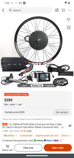

10 speed freewheel on DD hub motor? It's a 10 speed bike.Any known issues?
I am hoping to keep it 10 speed.It is a 2013 BH Neo Jumper that I changed to 48 volt.I am installing a 3000 Watt 72 volt motor.
Which motor. Assuming you have 135mm dropouts, direct drive motors can only accommodate 7 speeds, whether cassette or freewheel. A 3000w hub often may only accommodate 3 to 5 speeds due the wider stator width. Do you have a link to the motor?
It's from Alibaba.You can not get any info from the sales person.I guess I will wait till I get the motor before ordering a freewheel for it . I really like the 10 speed but it is what it is

James340, you must have the build experience to know pedal assist is like an on/off switch on big ass motors. Unless you plan to not use PAS and ride with pedals/throttle. Then you're fighting the magnets on a dead direct drive motor.
Sunracer has a 10 speed freewheel though, and I believe it's 41 mm wide, 10mm wider than most 7 speeds. The known issue is it's a bad idea to spread an alloy frame. Hate to see you break a nice bike like the BH Neo,

Is the 3000 that much bigger than 1000?This is confusing because Alibaba merchants don't give me any information

A MXUS 1000W motor is 13lbs, and the 3000W motor is 22lbs, so that's a lot of added weight.
You could get a 1500W Leaf hub motor if you want to hotrod it. It will be lighter than the 3kW motor, and efficiency is pretty good (less heat), and would be pretty fun at 60V (I tested 14S through 22S. 18S suited my riding best, but 20S is more common so that's what I decided to use in the end). The most I've run through it was 7kW, but some folks push it harder.

I'm not certain I am understanding this. My Grin All-Axle DD accommodates my 10-sprocket cassette just fine.
Could you clarify?
Most means the stuff he's shopping for on places like Alibaba. Grin is an exception.
If you get a hub motor with a cassette instead of freewheel then you could probably remove 1-2 of your gears and just slip the thing on. Use the limit screw on the derailleur to prevent going into the last 1-2 gears.

8, 9, and 10 speed cassettes are all the same width, 4mm wider than 7 speed cassettes.

I wanted a cassette motor but the price was 4 times what this motor cost.
I asked the manufacturer the weight.3000 watt kit is 14 kg 1000 watt kit is 11 kg.I have a 1000 watt motor from them I bought a couple of years ago.
That would be unusually heavy. Link? Maybe you mean pounds? 6-6kg would be average, Grins all axle is 4kg.
