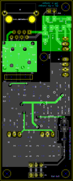

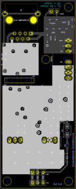

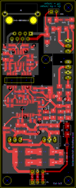

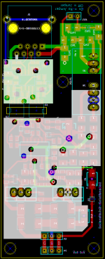

I started working on this gate driver design about 2 weeks ago. I've been working to improve on the previous and now I'm starting to experiment a little. This gate drive is being designed to drive a large bank of parallel MOSFETs for a controller idea I'm testing out. It's going to be in what could be considered a harsh EMI environment.
Right now this is just a draft, but I'm hoping to have the boards produced soon so that I may start slaving away with the soldering gear and some tweezers. As much as I want to rush into building this, I know better.
I'm trying to get a part justification write up done to explain things that might not be obvious. Right now only 1/2 of the differential setup is visible, the other side is placed on the controller board.
The PWM signal and the fault out from the gate drive and +5v and +24V are being carried over CAT6 shielded twisted pair. That provides 8 conductors and one shield.
2 for PWM (differential)
2 for Fault (differential)
2 for +24V
2 for +5
Since there are 6 gate drivers for a 3 phase setup, there will be six CAT6 cables running to the controller. I anticipate the length being ~1m, maybe 0.5m.
The reason for differential signaling is it has very high CMRR. CMRR = Common Mode Rejection Ratio. I chose to go with an RS485 driver chip as I believe it fit the need well and comes in a neat little package requiring very few additional parts. I added some TVS diodes to improve the static sensitivity, because the cables will be handled more often than I would like.
Posted up are KiCAD files and PDFs of the board layout and schematic. Sorry about the super thin traces in the PDFs, that's a KiCAD bug. Some of the voltage call outs are incorrect as I used specific vs generic names, then changed the voltage converter from 15V to 12V... my bad, need to edit that.
Post up questions if you got them.

awesome man! love reading your technical posts!
small remark about the PCB, it's good practice to avoid corners less than 90 degrees, because there is a bigger chance of unwanted copper leaving behind in the etching process. (probably not even a problem, as you have a large clearance between traces)
just some feedback for schematic (i didn't look at layout)
power supply minimum load. during bentch test (or by analysis), you should see if you have naturally 5% load without the LEDs and if so you can pull them off if you want slightly higher efficiency. on cheap power supplies though, probably its best to leave them on to ensure stability even if your min load is 10%.
LTC2863-1,the failure mode is output logic one? would such a mode cause your mosfet to be conducting or OFF?
transistor at opto input IC1. make sure this transistor is going to produce the square waves cleanly at the frequency you want (spice simulation).
differential driver.. i gotta read this datasheet in detail. the device is differential driver, but your layout is not. could be that's fine for the device to work, just doesn't look "differential" to me, so i'm going to go read on this more and get back to you. for true differentially driven noise immunity, the input to pwm opto (IC1 for example) has to be **driven** in reverse in the OFF state. that's what i was looking for in your schematic and i didn't immediately see how that could be done. oh... maybe you are just trying to make the communication path differential, not the actual pwm opto (i.e. if you had a really long distance between brain board and gate driver board?). ya you could do it this way.. still though i would be more inclined to use the shielded cable that you have, grounded on one end, and then differentially drive all the way to the opto input (rather than stop at the driver chip you have).
you can improve the noise immunity further by incorporating hardware level interlock between upper & lower drives. know what i mean? this is an H-bridge topology where your critical failure is shoot-through. your PWM should be supplied in a half-bridge mentality rather than per mosfet way. think about driving the phase leg rather than the individual mosfet and how your pwm can be driven to both in such a way to make sure one is driven ON while other is *hardware forced* off.
my feeling is you don't really need to differentially drive the fault feedback because the time of response requirement is low (1ms). you could heavily filter instead. this is assuming your gate drive IC has built in fault protection which it does. i know your differential IC has two channels so you might as well use it.. ok, but, let's say you where driving the phase leg instead of per mosfet and assuming you could find a differential IC that had two channels but both channels face same direction. use those two for pwm and then just wire back the fault signal (with heavy filter).
make sure your pwm cable with its ether net jack style connection is suitable for high vibration. you don't want lose connections here at all!
double check your opto datasheet, make sure this opto has very good CMRR. i think i gave you a guideline of what values to look for here. also, and this is not always on the datasheet, look for very very low input-to-output parasitic cap value, should be in the 10pF range.
on your boost stage, your caps are shown in wrong order. since the flow of current from cap is through the boost stage transistor (not the IC) then your smallest nF cap should be closest to the transistor and largest is farthest away. electrically it makes no difference, but if you place on your schematic in this way it will imply that is how it is layed out on the board (smallest cap is closest to the transistor). one of these caps would be placed near the gate drive IC bypass, looks like u chose C7 for that. u might consider adding a 10nF between C7 and gate drive IC since this IC does do switching of current (drives boost stage) so there will be multi frequency noise.
-15V off is way overkill for a mosfet, even in high noise environment. also be careful to read all your datasheets because now you are talking about a 30V differential voltage and not all parts can handle that much (i forget how much the gate drive IC is rated for).
your PWM opto input does not have a defined state on power up (or loss of power).
what is the behaviour of U3 at initial power up? what is behaviour of your Q4 transistor stage at power up? remember, andy screw up here or any noise coupling at startup here may cause catastrophic failure (shoot-through). your gate drive IC, TD350, one of the reasons i like it is that it has good startup measures (low voltage lockout).
i don't understand your U1 linear voltage regulator output, you tie the output to +15V supply? or maybe you mean U1 intput should be tied to +15V?
IC1 & IC2, you sure pins 7/8 should be tied together?
still you put D1 and D2 in wrong spot. i know you have your appnote showing that your way is acceptable, but i disagree. guess we .. still .. have to agree to disagree on this :p
This type of isolators is usually very easy to use instead of optos:
http://www.silabs.com/Support%20Documents/TechnicalDocs/Si841x-2x.pdf
I don't know if it suites or app better or not than optos, but the general specs look good (1 or 2pF in-to-out @ 1MHz depending on package, HighHopes).
I've used similar chip but for I2C and from AnalogDevices, and I'm totally sold.
Thank you for the part Njay. I'm just starting to branch out and experiment with different design options now that I have built 2 working setups.
HighHopes, are there any caveats to this type of isolator vs a opto coupler?
LEDs guarantee it will meet minimum load while showing that devices are powered, but more importantly I chose red, white and blue... 'murica! I'll probably have to tweak R values to get them all the same brightness if I'm feeling fancy :mrgreen:
I'm choosing a part by CUI. While I'm not very familiar with the company reputation, I'm more comfortable with them for this project after reading the spec sheets. The converter is also regulated vs unregulated but comes with an added bonus of having it's output rated for a short condition. I have managed to kill 2 of the cheapo units I've used in the past by shorting them for < 2 seconds during testing. CUI also provide a good details on how to implement the device and more importantly, it comes in a foot print I wanted to help keep the driver small. Keeping full features on a gate drive while staying compact is a challenging.
Handled by Q4 - see description above
Simulation looked good, I had some other concerns so I took the time to simulate it.
I'm debating changing this to the differential design you are talking about and combining 2 drivers onto a single PCB and only needing a single wire run to it. This is a different type where it's driving only one side of the half bridge. I have a specific reason in mind for doing it this way though.
Care to elaborate further?
The differential going both direction was to minimize the chance of a false fault from noise.
This is something that concerned me and I debated on this design choice, but I decided to do with it because this is mostly going to be used in a lab type environment. My driver and power stage are modular. I'll probably hot glue or epoxy the gate driver side connections. I anticipate a cable length of 1m.
Min CMRR = 5000:1, typical=10,000:1
It's 0.6pF, but thank you for the reminder! I forgot about this rule.
I didn't realize I had them backwards, but now that you write it out it makes more sense. Gonna swap that around. I'll add on the 10nF as you mention as well.
I'm actually going -12V off since that's my supply. I need to change the schematic symbol. -12 is still over kill, but it's easy to get a 3W dual rail 12V DC/DC.
You got me on that one, I missed it, thanks.
U3 goes to a logic 1 at power up which is the idle state. Q4 is pulled high by R5 which is 22k, this keeps the LED in the off state during power up. The default to a logic 1 state is why I chose a PNP part vs an NPN part.
I think you read the schematic incorrectly because I have the regulator flipped. Not sure what the best practice is here for schematic drawing, I'm still learning what is good practice. I hope they are becoming more readable. I'd like to switch packages away from KiCAD as it lacks some basic features I need, but it is open and easily accessible to many.
Yes, pin 8 is Vcc and pin 7 is the enable pin which must be pulled high for the 6N137 to operate. But now that I read this again to answer your question, I'm thinking it might be a good idea to have the fault out of the TD350E pull this pin low. This would satisfy the hardware PWM shut down criteria. I could then add on an RC timer to create a short blanking period which might allow a recoverable fault to clear, maybe ~500us? 500us would miss 15 pulses at 30kHz PWM and 6 pulses at 12kHz. The software shut off would still be in the loop, but I would recode it to only shut down in the event of x faults/period. I think I just talked myself into this :D It's going to make it more robust.
I've swapped them to the "proper way", no argument, I just knew it worked way on the bench following the app note. As you mentioned to me previously, once you know something works you become reluctant to change it :p

Some small changes have been made. R20 was added to keep the opto LED in a known state at all times, some 10nF bypass caps added, cleaned up the 5V regulator circuit. I also re-orderd the boost stage caps to the proper order.
I also changed out the regulated DC-DC for a unregulated version which output +15V/-8V at 100mA/80mA. This is a 2W rated unit which might limit maximum switching freq. I've calculated that I require 1723mW @ 30kHz. At max freq this is ~14% margin which is not much. I plan to operate at 21kHz so there is headroom available as the power demand is only 1200mW.
This DC-DC has 6.6pF of parasitic capacitance + each opto at 0.6pF for a total of 7.8pF :D
Biggest change is the addtion of R18, R19, R21, Q5 and C16. This circuit forms a self resetting hardware PWM interrupt. The RC components chosen provide a minimum 0-2V time of 5.1ms (not sure how long to make this :? ). C16, a 1uF capacitor charges from pin 3 of the TD350E through R18 & R21, 10k and 15 ohm resistors. The TD350E fault output is high during normal operation and low during a fault. Q5 is open when it's base is high which is normal operation. When a fault occurs, the TD350E output goes low < 1.0V, this pulls the base of Q5 low causing it to conduct. C16 discharges through R21 which limits the peak current to 333mA since Q5 has a max of 600mA. On the next falling edge of PWM the fault output is reset back to 5V. This makes the base of Q5 high turning it off and allowing C16 to charge to 5V through R18+R21. The minimum enable voltage for IC1 is 2.0V.
This fault circuit works in parallel with the PIC error handling micro I use to stop the PWM at the brain side. It will be programmed to fault on the 2nd error. This should prevent false triggering of the secondary fault detection which will shut down and latch the PWM input off until it is cleared by a manual power cycle.
