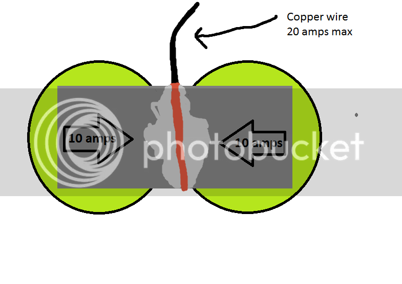

Positive and negative tabs sticking up, easily joined in series with a bolt and nut, tap in with a ring terminal for wires to a BMS. I also thought of shooting expanding foam in between the cells to pot the whole module. I found it easy to spot weld a piece of 0.25 mm thick Copper wire to a cell with my JP Welder, so a thin Copper wire could be used in place of the Nickel strips to have a fuse on every cell.
