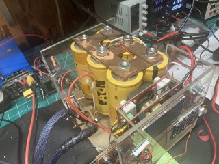

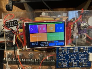

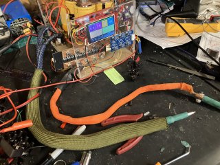

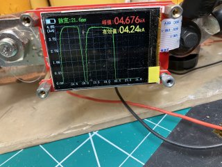

Honestly I can’t believe more people don’t diy these types of capacitor spot welds like Iv pictured. The controller board can be found for $40-$100 depending on the model. Different models allow higher charging currents also higher balancing currents between the capacitors. This ensures the capacitors are balanced to the same voltage even if your using older cheaper super capacitors sourced of eBay. They have the ability to connect 2 or 3 capacitors in series and as many in parallel as needed all while charging and balancing them. You can even use lithium batteries instead of super capacitors if you want.

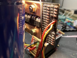

Other than the controller you need a MOS board, which are ~$20 plus the cost of the MOS tubes you won’t to use. All in I have probably $400 but I invested in a lot of expensive mosfets.
Iv ran the Kweld and have a 811H. Both welders work but the Kweld is not near as powerful and the Glitter 811H only lasted a few hundred welds before loosing most its power, haven’t got around to looking into the problem yet.

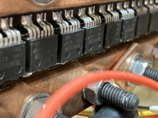

The capacitors look impressive and surely can deliver a lot of power, but i'd be worried about mosfets burning out all the time - they need to handle extremely high amps. Don't think VESC or any other motor controller is anywhere close to that.
From my experience you need the lowest resistance possible across the mosfets board to achieve the strongest welds. This also is the key to keep from blowing your mosfets, if resistance is slightly higher in one area Fets are sure to blow. The ones with lower resistance end up doing most the work and eventually the current gets them, or the ones with higher resistance blow out from heat because they turn on slightly slower. Atleast this is my theory, maybe my reasoning is wrong but from first hand experience if the resistance is not as low as possible Fets will blow and/or welds will be inconsistent..
This mostly applies while welding with high current, straight copper to cells or while welding multiple layers of nickel/copper.

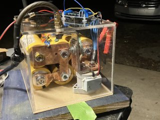

Not sure how clear it is but my first welder used just a relay (the gray/white thing in bottom right of picture). The relay was controlled by a simple timer board (thing on top of plexiglass).
You hit a switch, the timer closes the relay for your desired amount of time, then timer opens in turn opening the relay. I ran this type of setup for many batteries, it is definitely the cheapest way to make a welder.
But it does come with some issues, biggest issue is when the relay welds itself closed and you blow a hole in your battery from all the current coming from capacitors. Choose a good quality high current relay and this issue is lessened but I always had the fear of it happening again..
