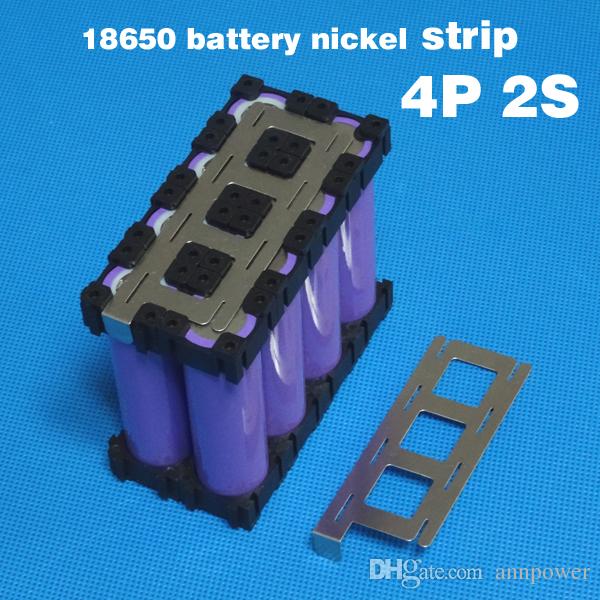

I would like to add several things to take into consideration. The entire bottom and sides of an 18650 cell are the negative electrode. Only the "button" tip of the positive end is the positive elctrode. there is a small area of insulation between them on the positive end. The sides and even a small portion of the negative electrode that is at the edge of the positive end, is typically covered in a plastic sleeve, upon which the name and type is usually labeled.
Due to vibration over time, a short can develop across the positive central "button" electrode, and the circumferential negative "shell" that is very close to it. For this reason, many pack builders add some type of additional insulation. In the pic below, the 4-cell Paralleled string has a tan-colored paper insulator. Individual silicone "washers" are also available, at very affordable prices.
file.php
In the pic below, the cell on the right has an additional "washer" style of insulator on the positive end.
file.php
______________________________________________
The next item is adding a space between the places where the "two-probe" spot welder will create the welds. Due the variability of the thickness of the nickel strips, and also the resistance of one strip to the next, some of the spot-welding current will travel through the strip itself, rather than only through the places where the strip touches the exposed end of the cells. This is why production spot-welded packs have a short and thin "split" between one side and the other. This air-gap forces all of the spot-welding current to travel from one side, through the end of the cell, and then up through the other side. Doing it this way can create a more-consistent weld.
This slit can be added to plain nickel strip material with a dremel tool, using a thin abrasive disk.
Individual cell-fusing:
If one cell in the middle of a pack begins to short out and become very hot, very rapidly...having the connection between the cell and the rest of the pack formed as individual fuses can (in some cases) stop a runaway short from affecting the rest of the cells. The pack might still be ruined, but having only one cell overheat, rather than all of them....is a much more desirable situation.
The pic below is a design of a laser-cut nickel strip that connects one end of a collection of 12 cells, to form a 2S / 6P sub-group. The six tabs on the left side have the central split (described above), and those would be spot-welded onto the negative ends. The six tabs on the right side not only have a central split, they also have the connection from the center out to the rest of the cells formed with four thin "S" shaped strands. These are the fuses. All four strands would get very hot during a shorted cell, and...as soon as one of them melted completely through, the current flowing through fewer fuses would cause an immediate cascading failure of the remaining three strands. The fuse "strands" are to be located on the postive "button"

The DIY slit is a cool idea. I usually buy just normal pure nickel strip, but there is the option to buy some pre-split strips like these: http://www.aliexpress.com/item/0-15-7mm-forming-nickel-tape-high-quality-nickel-strip-18650-4P-pure-nickel-tape/1565779974.html?spm=2114.32010308.4.2.4YFfRP
Kind of pricy, but it certainly accomplishes the benefits of what you're talking about.

Thank you very much with this extended considerations. I really appreciate how well explained it is. :eek: I actually had an idea of all you mentioned except about the small gap some nickel tabs have in the middle of the welding spots. That's really interesting.
About the insulation "washers" I would add, that some cells like Panasonic or LG ones had a double layer of insulation around the anode (it is really like a plastic spacer inside the insulation wrap) so if the pack is clever spot welded and then is consciously covered with anti-vibration pad, I think it would be made enough secured for years without the need to add spacers, although it is always a good improve.
The nickel gap I'm sure it make a difference on >=0.15mm thick strips, where sometimes nickel disintegrate making a hole, or stick harder on the pole than on the cell. For thinner strips as 0.1mm I have a stone-strong clean weldings with 20A - 25A welding current and standard pure nickel strips.
I really like the individual cell-fusing method for a very appreciable increase on security for a hard fail/short cell. The well-known discussed thing is that it makes resistance points, and it only would work for a specific max continuous amps cell range. (I don't know if that tabs are made in different thickness/fuse points sizes). Also are not a very reliable tab depending on your configuration / shape cells method, like offset "pyramidal" hot glued cells. I think that a pack with factory new, high quality, same batch, spot welded cells and a conservative max discharging rates with a good BMS, had a very low fatal fail rate.
Despite my small thoughts, this info is gold and essential for what a Ultimate repository must be! :D
I will add the information in the head post if you are agree.
I am, and sure the whole ES battery scene, truly grateful for your contribution spinningmagnets
