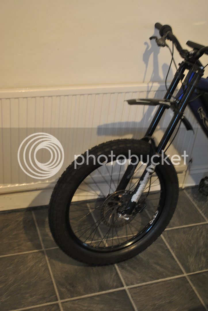

Good news - 20" scooter tyres fit a 24" rim perfectly.
Bad news- They're too wide on the front for my Marz Bombers 888's! :?
..if you see any 20" x 2.5" let me know :)

Sacko, what size are those tires, more specifically what size are they listed on the side wall?
Thanks Sacko, that makes sense why that tire fit perfectly on a 24 MTB rim, the rim is actually 20.5 inches and being that the that bike rim beads are much shorter than MC rim bead, that probably fell onto the rim perfectly. Thanks for posting the pics.

yeh there pretty badass looking. Sorry they didn't work out for you... i'll message you if i ever find some 2.75 or 2.50 width ones. The reason they work for me is because i use a set of honda cr85 forks with a headset adaptor and axle adaptor (axle adaptor not installed in this picture... its being replaced with an alumnium one at the moment, part of a general drive to swap as many steel parts for aluminium, mainly to make up for the weight of all the motorcycle parts!)
