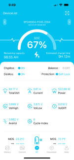

Progress! Haven’t had a chance yet to work on motor mounts preferring instead to stay inside where it is dry, nice, and warm.
Spent a considerable amount of time reviewing documentation sent by Siaecosys as well as wiring diagram examples and related video content from similar builds.
It spins!
Learnings: didn’t realize how sensitive and critical connecting bms wiring is and accidentally damaged my bms. Panicked for a minute thinking I destroyed 2 cells in a battery module after seeing 1.24v and 5.21v 😬 in the jbd app, but later figured out it was the bms after reading normal values from my multi-meter. Glad I bought 2x bms(es?)! Reconsidering my bms wiring and plugs if there is a safer and more fool-proof way to do it while keeping the batteries removable.
Please ignore the household light switch representing where the ignition key switch would be. 🤣
I hope this video link works since it appears I can’t upload a direct video.
