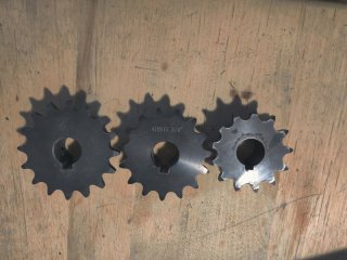

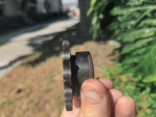

Earlier this summer I pulled off the front sprocket and went on line to order a 15t and 16t sprocket. Sprockets with the correct size keyway were around $150, so, I decided to order a 15 and 16 tooth sprocket with a 3/32 keyway and file them to the correct size. These were about $15 each.
Original 13t sprocket
16t, 15t and original 13t sprockets
Filing the keyway. took about 45 minutes each to get to size.

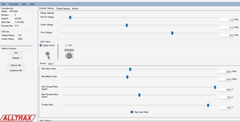

I kept the controller settings the same: 250 amps max from the battery, 300 max amps to the wheel, throttle at 55%.

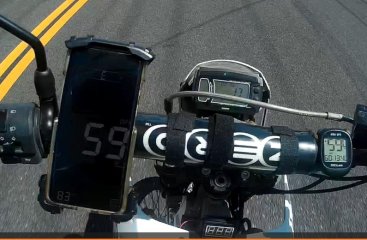

With the 15t sprocket on a full battery, I was able to hit 60.9 mph, however , the bike was noticeably slower off the line. After 20 miles or so, top speed dropped to 55-57 mph.
top speed after 5 miles with 15t sprocket.
After 2 weeks, I installed the 16t sprocket. I was able to hit 62 mph top speed with this sprocket. I kept the controller settings the same. The bike was slightly more sluggish off the line and it took a while to hit top speed. It still pulled nicely in the mid RPMs (20 to 50mph.) I bumped up the max amps on the controller 20% and the throttle to 65%, but the bike was still too sluggish. I plan to go back to the 15t.

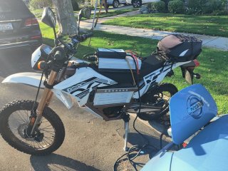

Been solar charging my bike in a common area at my condo complex and have yet to receive a violation notice.

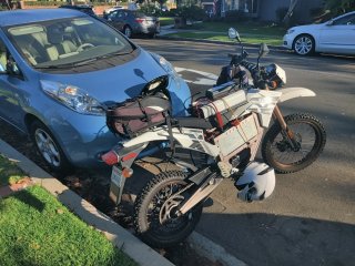

Also, I snagged a free 2012 Nissan Leaf a few years back. I can use the zero's battery pack to charge the leaf with a 2500-5000w 48v converter. The closest reliable charging station is about 2 miles away, so I only need about 1KW when I run out of power. For the converter to work, you need to run a wire from neutral to ground on the open 120v port.
I do not think you can do this with a new Zero, but I could be wrong.

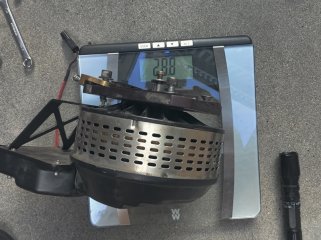

Ok, it looks like I accidentally deleted my post from the spring. Here is a recap:
Last October, I went for a long ride on the highway (60+mph) and after 25 miles, the motor started making a loud clacking noise. The motor was warm and there was definitely some scraping going forward. Also, the motor locked up when backing up. I was able to limp home and pull the motor.
I think some of the magnets came loose. It still rotates forward and there was no burnt smell or wires. I anyone wants it I still have it. I think it can be repaired. I do not recommend running this motor over 13KW for long periods.

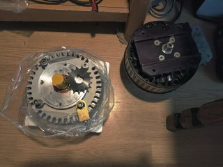

I know there are a lot of motors that can fit this space, however, the Montenergy ME1907 looked like it would bolt right in. I ordered this motor and installed it.
This motor fit right in using all the same hardware.
I have been riding with this motor and a 15 tooth front sprocket for the last 9 months. I can hit 63mph+ with a tail wind but struggle to hit 55mph into a good headwind. Also, it is slow from a stop so it is not safe to split lanes. Here are my controller settings:

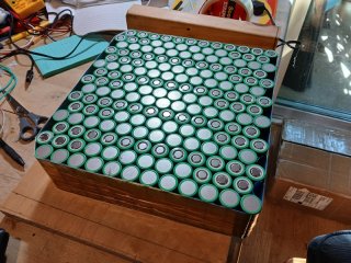

For anyone interested, here is the pack build:
I tested several 21700 cells and was not impressed, however, on paper the Samsung 50s looked like it would work for me.
On paper a 20s18p 50s pack would be 5.8KW as tested, a 5.2 KW pack.
I ordered 390 Samsung 50s cells at $2.25 each. With shipping it came to $1250.00.
I wanted to use commercial spacers but just could not make it fit, so, I used tape (2 layers around each end) and hot glue.

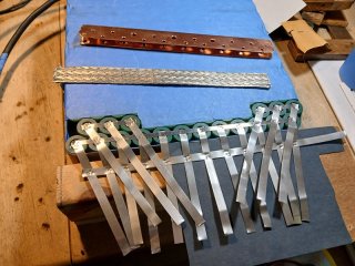

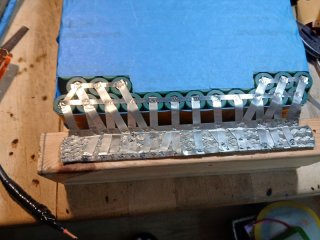

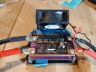

I have been using the same $35 amazon welder for a few years. It works great for .15 nickel strips if you go slow. It does heat up so I have a fan.
I hate soldering so I tack the strips to a nickel plated copper strap, then bolt a copper sheet to hold everything together.

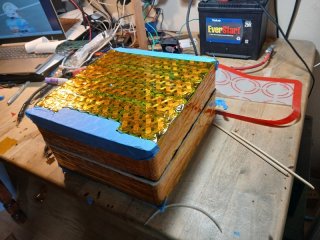

Here are the 2 10s sections stacked.

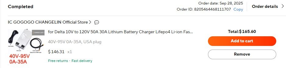

My new charger from AliExpress works on both 120v and 240v and tops off at 3KW. You can easily adjust the volts and amps.
I attached this charger under the back fender with some zip ties. The fans are noisy but it puts out 3KW and weights about 4 pounds.

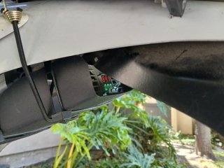

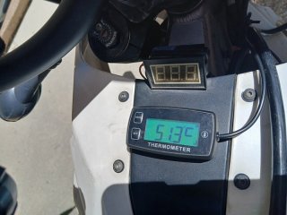

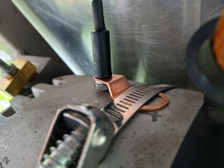

Purchased a digital thermometer and attached it to the motor with a hose clamp. Temperatures reach about 46 degrees C while riding, then, when stopped, rise to 51 degrees C (on an 80 degree F day). I do not think this is too high but I start taking it easy when the thermometer starts showing 45 C. Also, when I park just right in the sun, it will read up to 40 C.

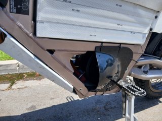

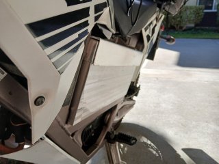

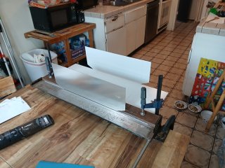

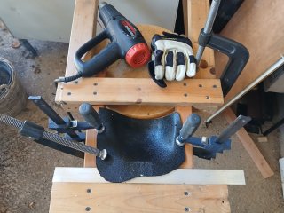

Had some time so I made an air scoop with some scrap ABS. This setup made no difference on my 3 mile stretch, at 60 mph, on PCH. I plan to take of the bottom/front fairing and maybe add some cooling fins if this setup last the summer.
